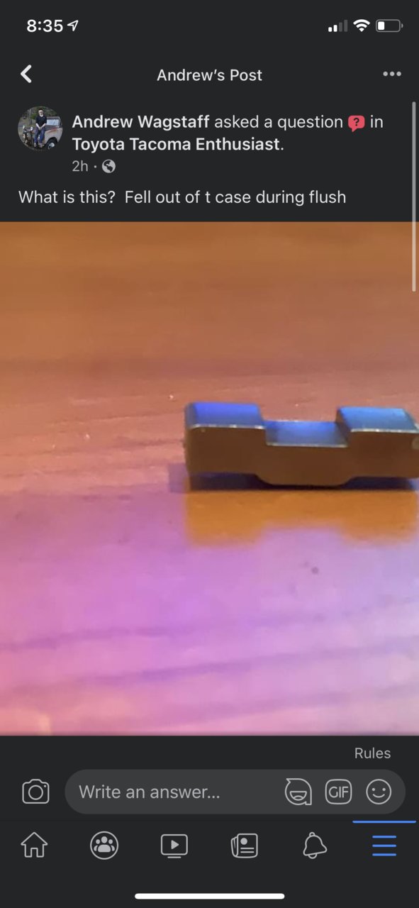

    Saw someone in the comments lost 2 I believe. Isnt there 3 inside?

    theres supposed to be. Real question is, how the hell did the keys fall out changing the oil, someone done read the wrong how to thread.

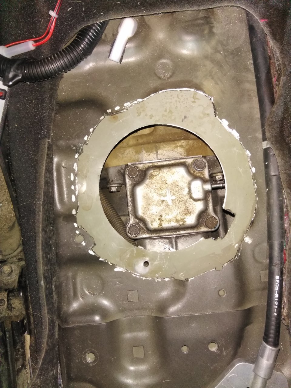

    Made a dolly to easily move it around and keep it upright so I can drain it and work on it.

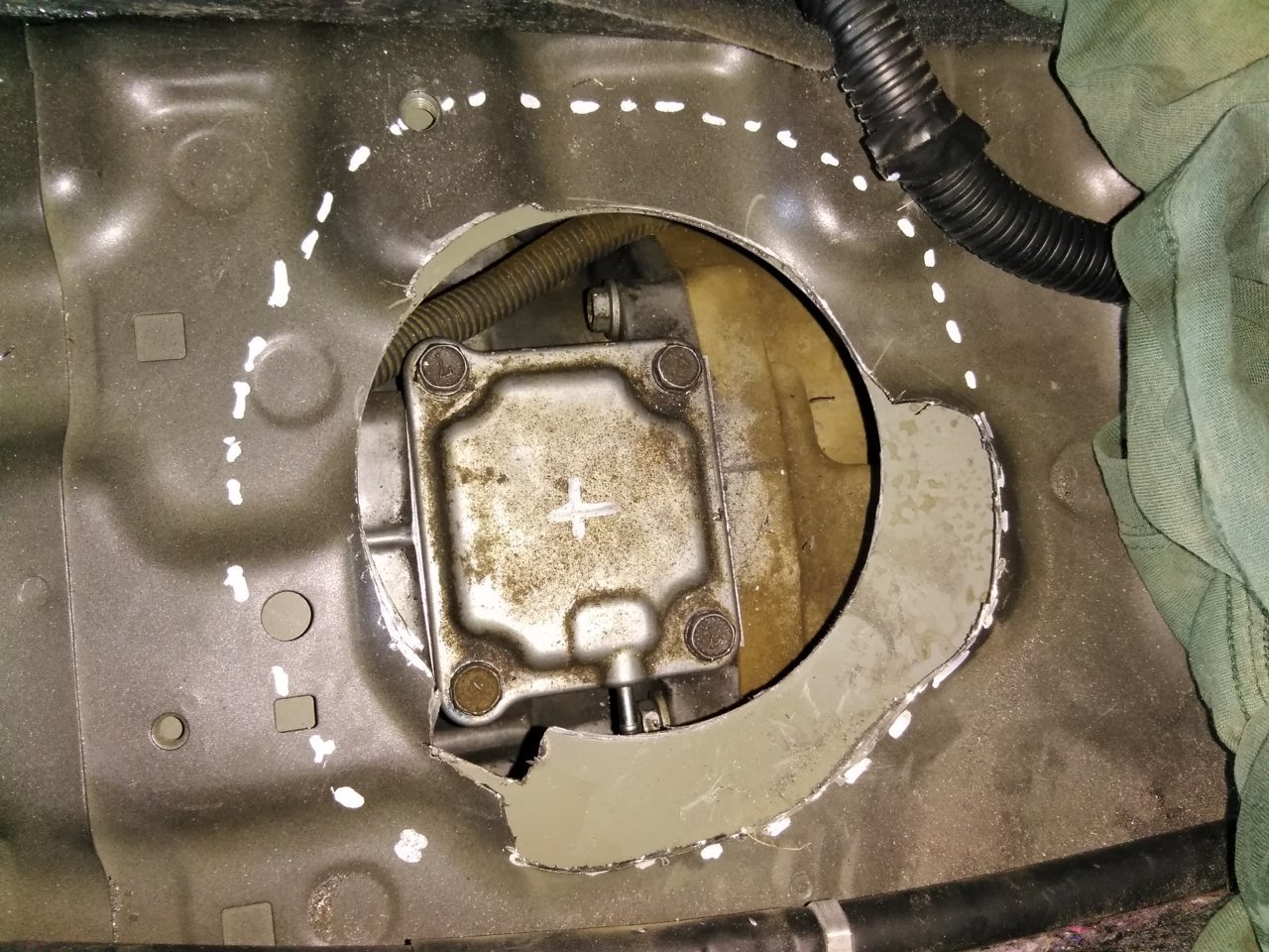

    There are 2 layers of metal that make up the bottom of my truck. Getting the seal to be perfect will be much easier with 1 layer.
    :cookiemonster:
    The seal will be made out of a 6" collapsible silicone dog dish :rofl:
    Nice and cheap, if we mess it up, I can get another one in minutes. Silicone will resist the heat, and oils of everything. Should be an easy solution.
