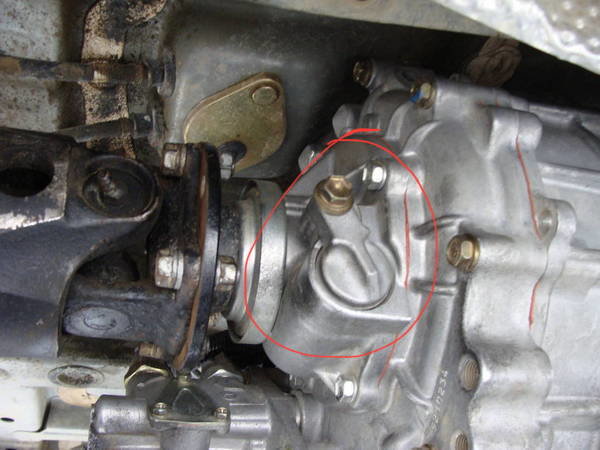

    I started getting the p0500 code recently and my speedo works, as well as the 4 wheel sensors. After getting an alignment and a zero point calibration, by slip light comes on and steering angle sensor won't initialize, giving me the c1445 code. My truck is also a manual and I replaced the combo meter after reading on here that it's a common cause for the p0500.
    Do you know where the VSS gets the speed from on the manual? Speed sensor on the transmission/tcase? I'm going nuts trying to track this down since when I get over 62mph my ABS and Brake lights come on and the speedo cuts off. Not getting a Vehicle Speed reading from my ODBLINK.

    speed comes off the back of the tcase on a Manual

    I only see the transfer case actuator and the 3 wires going to it. There's something on the passenger side of the transmission but not sure what I'm looking for. Do you have a pic, diagram, or part number? Its a 2014.

    I have a 2014 Tacoma. there is not speed sensor on my original t case.

    It goes here. This one doesn’t have one tho but it goes in place of the cover

    Is yours a manual or auto? Manuals only have it at the tcase.

    I have a 6 spd 2014 and it dose not have any speed sensor at the t case.

    That's what mine looks like. I don't see a sensor. Where does the speed reading come from then?

    Then probably from the abs speed sensors

    I also have a 6spd and dont have that sensor there either. Mine is a 2013

    Must have changed in 12. Think @6 gearT444E has a 2010 and he has one there

    Yes at some point they got rid of the tcase sensor. Probably for the 2.5 (12-15) trucks. Maybe if someone has a 2011 can confirm.

    Ok, does anyone know if the vehicle speed comes from the front or rear ABS sensors on 12-15?

    it is an averaging circuit that uses all of them, it is developed in the skid control ECU.
