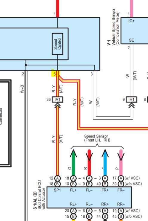

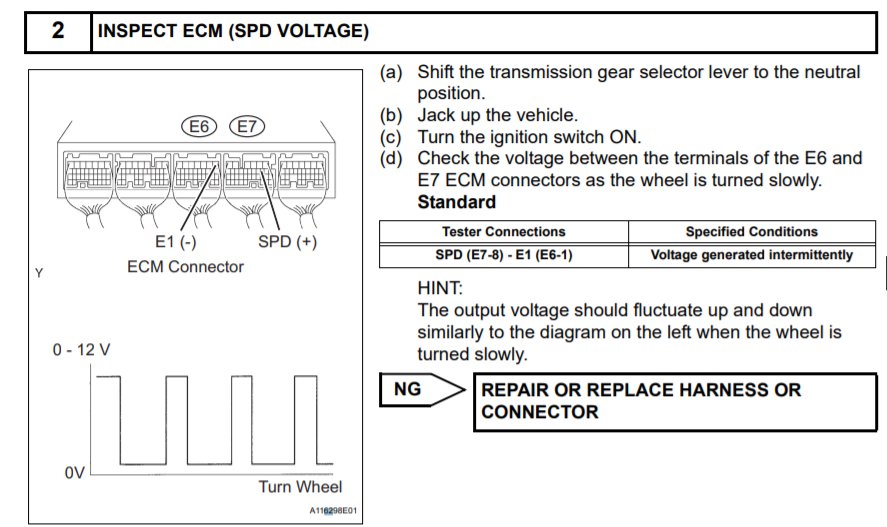

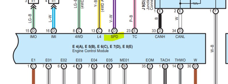

    Get yourself an oscilliscope and measure the SPD waveform into the ECM. Same can be had for the gauge cluster.
    rheath08 likes this.

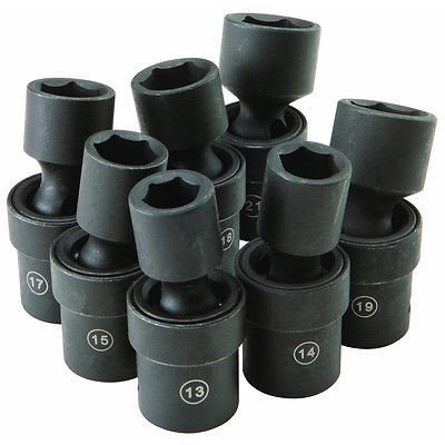

    2017 4Runner
    I use one of these on an impact and it makes quick work of it. Harbor freight sells some.
