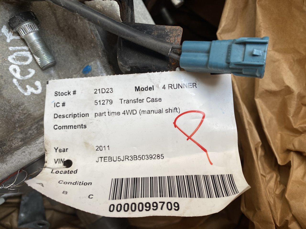

    @6 gearT444E this one will work for me right? 2011 4runner manual shift, part time 4wd
  10. Jul 15, 2021 at 12:36 PM
    #2230
    Brian422
    Brian422 I fell into the pit that is TW
    Jun 8, 2011
    #57958
    15,648
    Brian
    Birmingham, AL
    2012 DBCSB F/R Locked, 35's ,Long travel, 23 Tundra 4x4 limited
    Not Stock
    yes, its the same one thats in the fj
    fatfurious2[QUOTED] likes this.

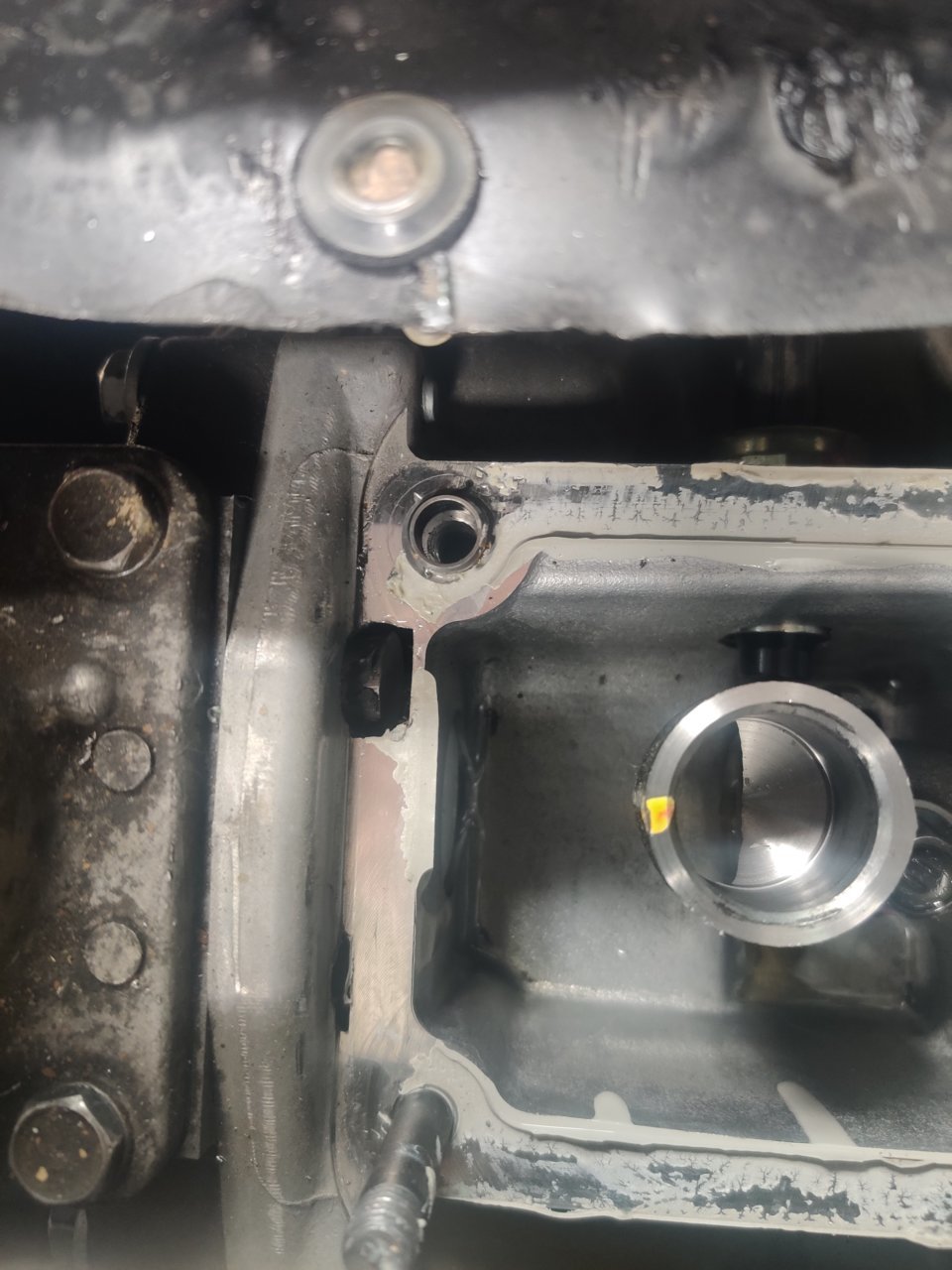

    So for the gents and ladies that want to FJ swap on the 3rd gen manual. Here is a pic of the clearancing for the shafts. Well a top pic anyways. You can see that I did not need to go as deep for each shaft. What I really needed was a cleaner mark for the shafts location to the back of the trans. It looks like I did not even need to go as high too. The shaft looks like it will clear the shifter base and not interfere with it.
