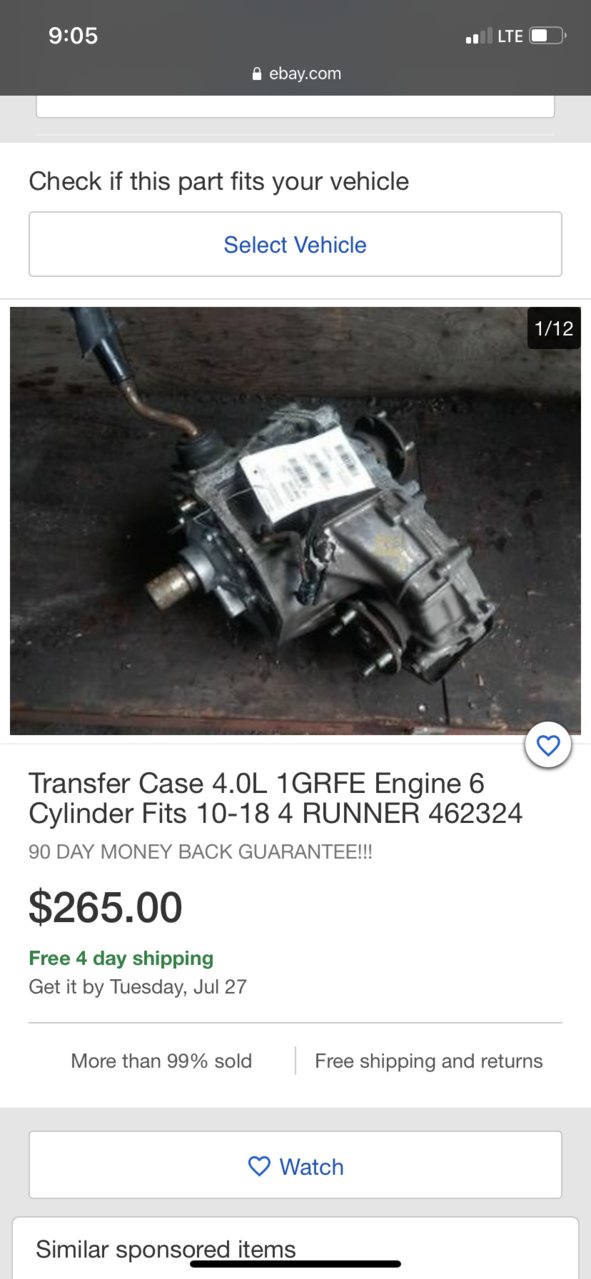

    That's exactly what i will be doing. Got a case on ebay for $420 shipped including shifter. It has 135k miles. From a 2011 4runner manual shift.

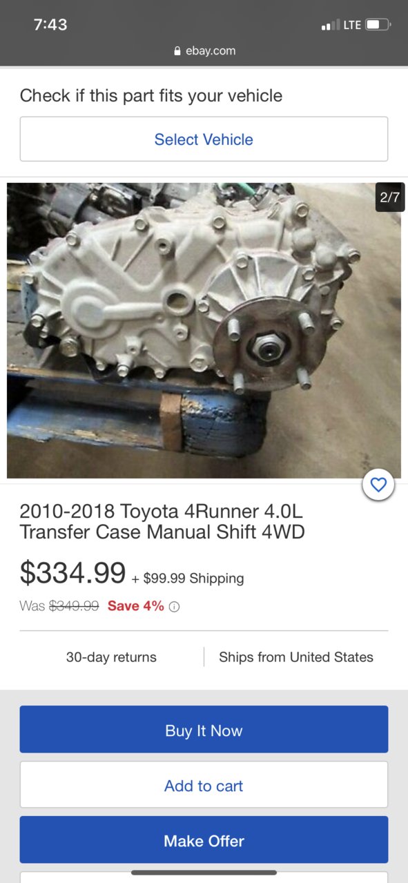

    This will work right? In my head I know it will but shit if I don’t wanna make a mistake..

    I think so but try to get one with a shifter, otherwise its an additional 215+
