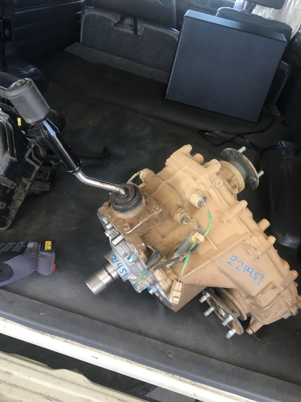

    Ordered the ADD delete parts online, so I’ll be waiting for those to come in.
    For those who kept the FJ J shifter with an automatic (no twin stick) Did you need to modify the FJ stick to fit thru the pen holder location? I was looking for photo reference but didn’t find any...

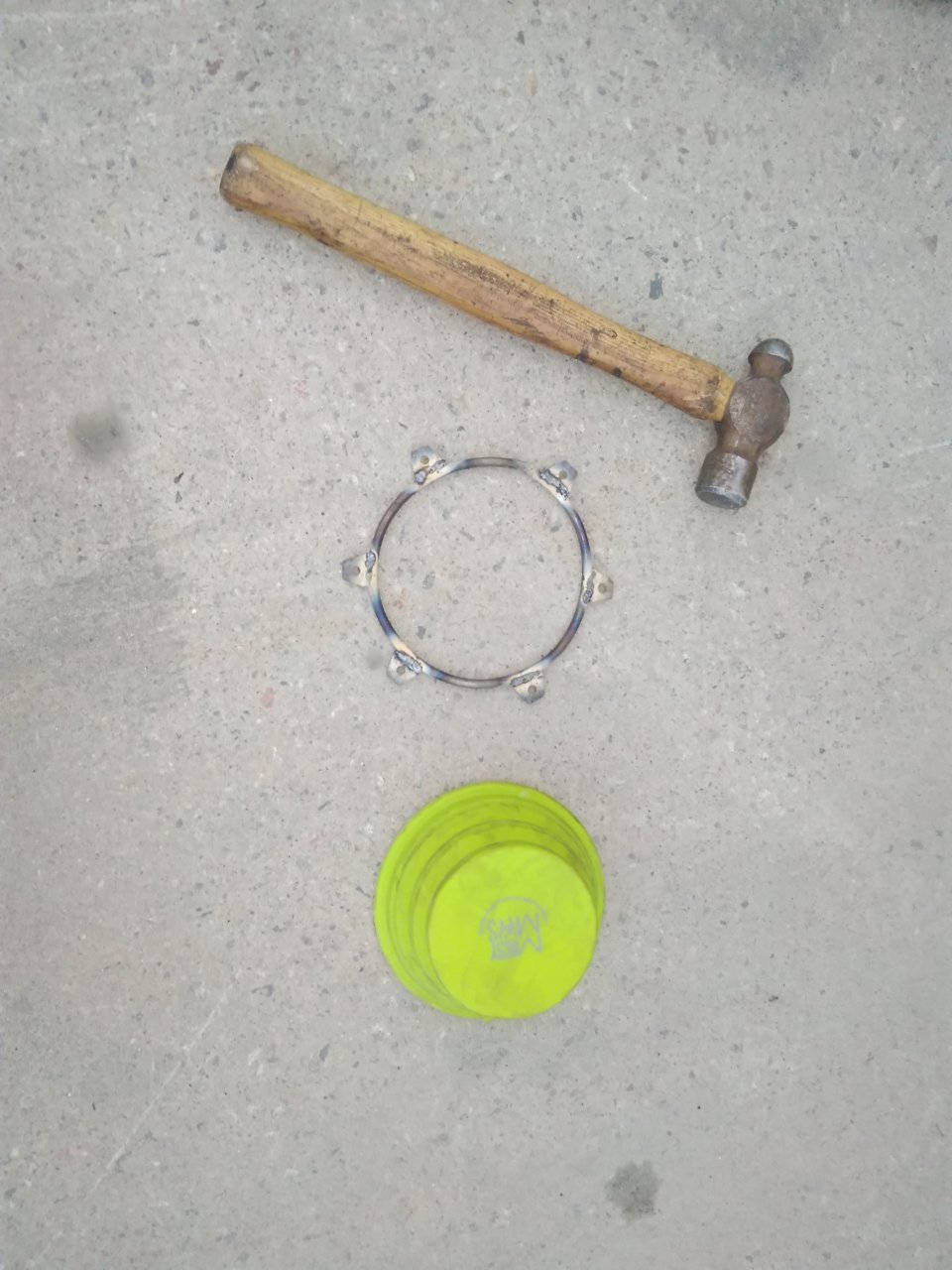

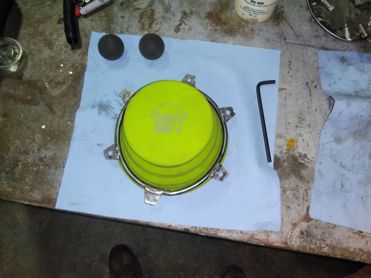

    FJ t-case with twin sticks, UTE bed, some other things :D
    $12 at the pet store. Silicone so oil and heat dont bother it.
    :thumbsup:
    *edit*
    Ahh its probably the black boot that comes with the twin sticks that starts to crack? I never thought about that. :argue:
    deanosaurus and Windigo like this.

    Is the green wire (Neutral position) on the FJ Tcase wired up to anything for an auto? I swiped over the other two plugs from my tcase over to the FJ case.
  14. Sep 6, 2021 at 1:00 PM
    #2314
    EatSleepTacos
    Mar 24, 2015
    #151688
    59,846
    Randy
    West Valley, AZ
    2017 4Runner
    If you wanted to take advantage of the neutral sensor, you'd need to add your own indicator somewhere on your dash, like a little LED or something. Most just leave it unhooked.
    Rames[QUOTED] likes this.

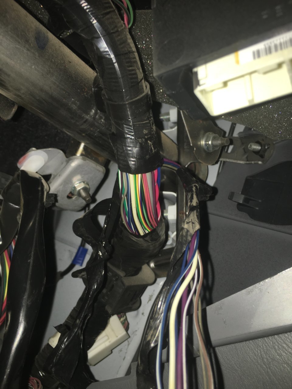

    I’m taping into this wire loom to look for the solid red and brown/white wires correct?
    Or am I tapping the two plugs from the 4x4 ECU together? I have a 2012 and the second plug doesn’t have a red wire
    Littles likes this.
  17. Sep 8, 2021 at 8:41 PM
    #2317
    Littles
    Littles Stupid is as stupid does.
    May 14, 2014
    #129837
    3,434
    Bryan
    Elizabeth, CO
    3 tons of fun
    llamasmurf and Rames[QUOTED] like this.
