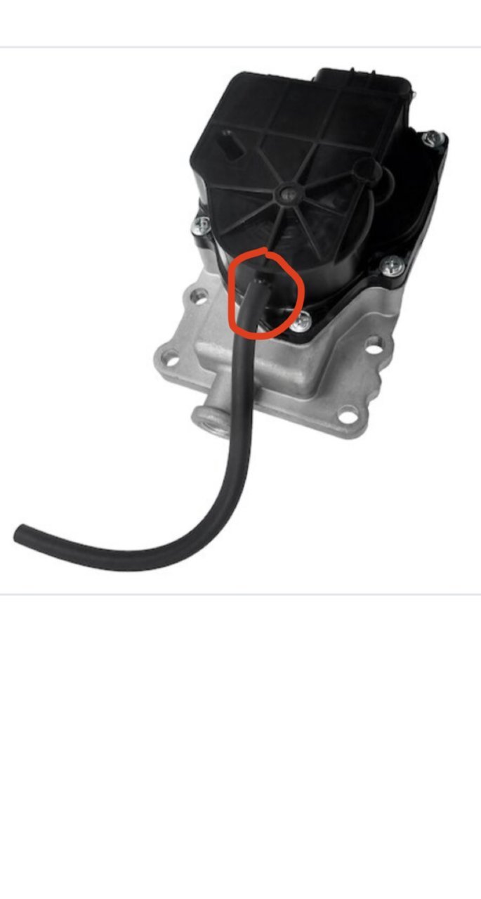

    Anyone ever have this vacuum line nipple break? Mine broke a while back and I used some plastic glue but only worked for so long and now it’s broken again! Anyone have a replacement cover they can send my way? Or else I have to bu a whole damn unit lol.

    I would cut it off flush and thread something like this into the box. Did this on one of my T100's vacuum hoses and it was there for years without an issue.

    A little replacement brass nipple might do the trick.

    If nothing works I have an extra whole actuator I don’t need anymore I’d sell ya.

    Nipple broke on the housing for vent hose and allowed water to get in there.

    Yup, seen a lot of fellas reporting that from occurring. The guy the used the awd 4runner drivetrain to convert his pre runner to awd had that same issue and he posted the pictures of the process and part no.’s if I’m correct. Cheers bro
