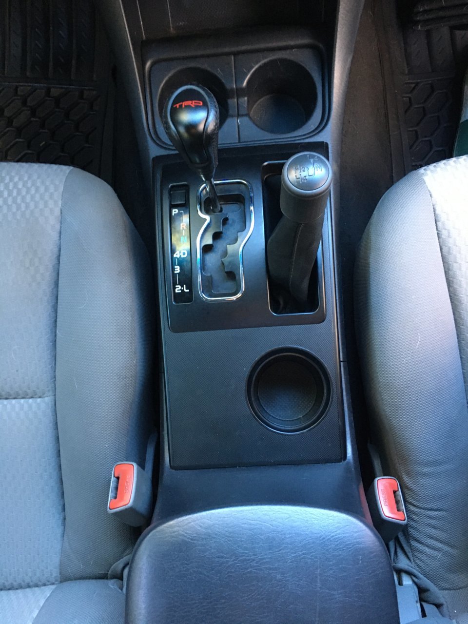

    Finally all done. I’ve had 5 different iterations for the shifter relocation. Ended up with a S bend near the top to clear my hand shifting thru to D as it sat too close originally. Reverse gave me the most issues. Also it sits as far back as possible in 2hi to help with the clearance, it drops about 2” into 4hi. The throw takes up the entire width of the pencil holder. With the S bend, that centers the shifter. The actual 1/2” rod is pretty much against the driver side in 2hi and against the passenger side in 4low.

    I believe so. This is factory location for me.

    Yes exactly.

    Planning on leaving it there or moving to pen slot?

    I keep going back and forth. I like my pen slot/cellphone holder. On my last tacoma I had twin sticks and had them routed all fancy. I kinda just wanna make it work where it's at this time but that's probably not going to work out.

    from what I’ve seen leaving it in stock location is the worst of both worlds, losing half your pen slot and cup holder

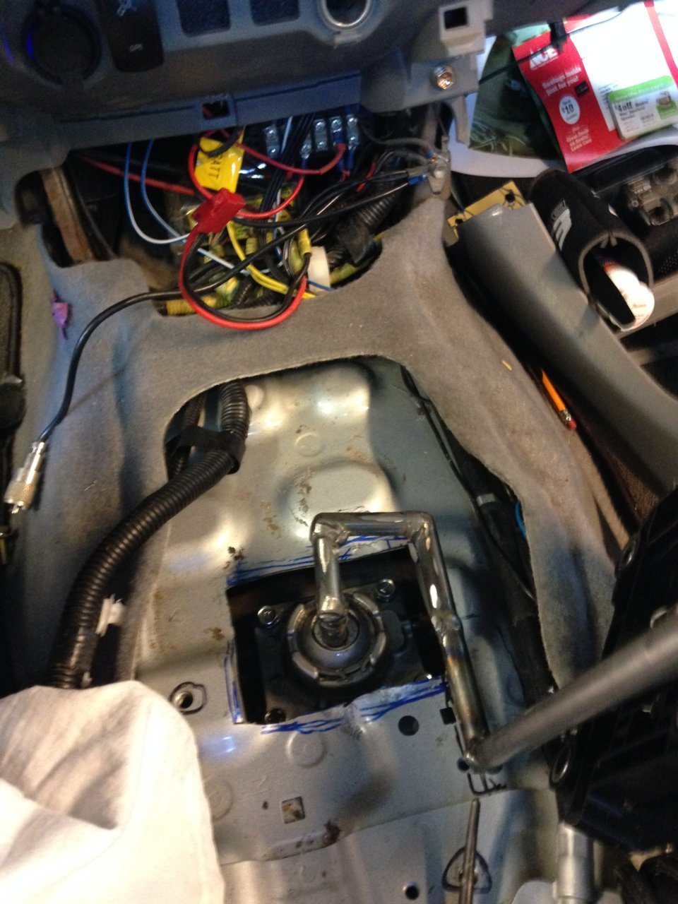

    Agreed just take the time to weld something up. I lost one of my bolts for the shifter but it’s still plenty stable. Took me bout an hour to make this POS

    That’s a real nice POS! :D

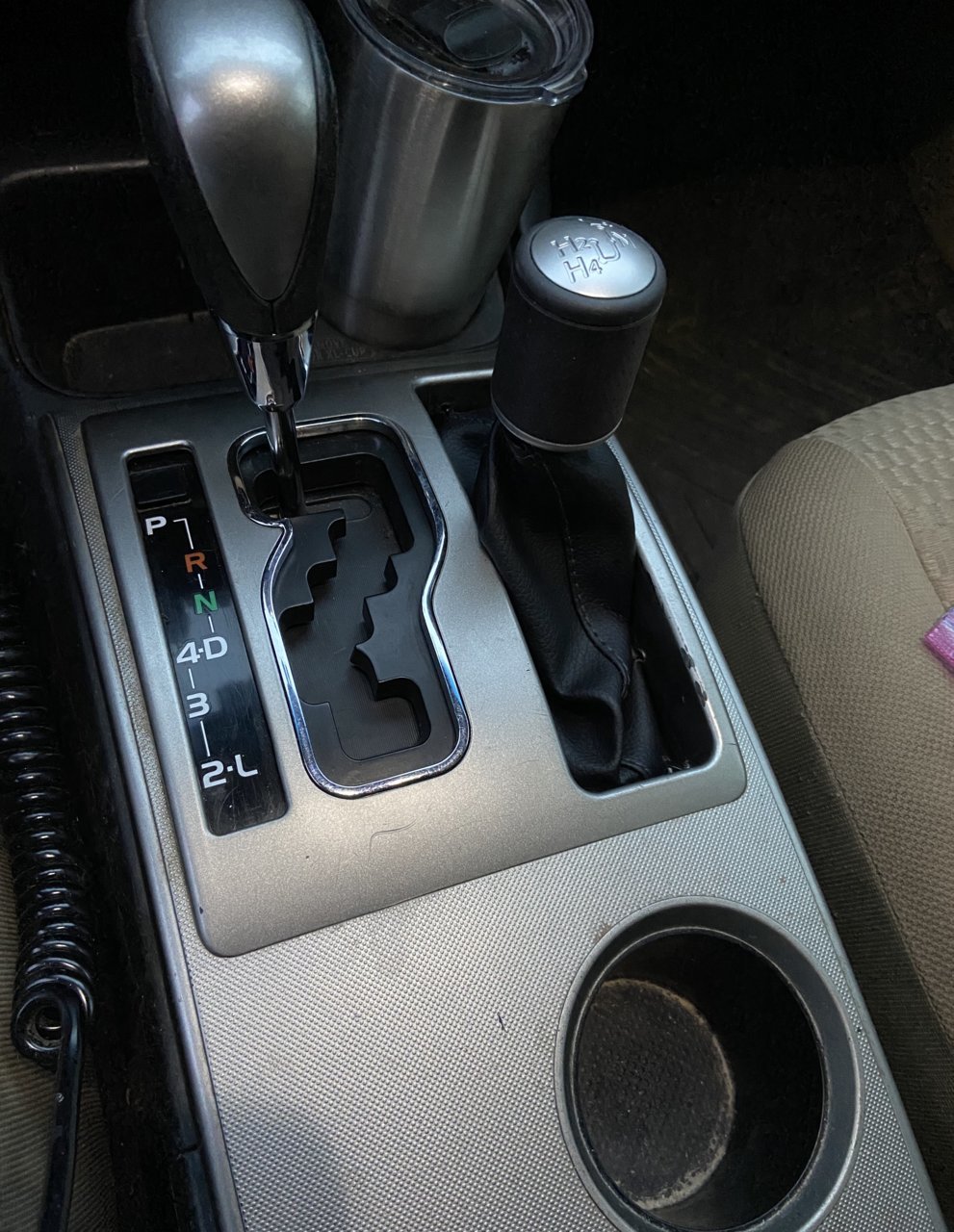

    Top picture is mine, so somebody copied somebody...

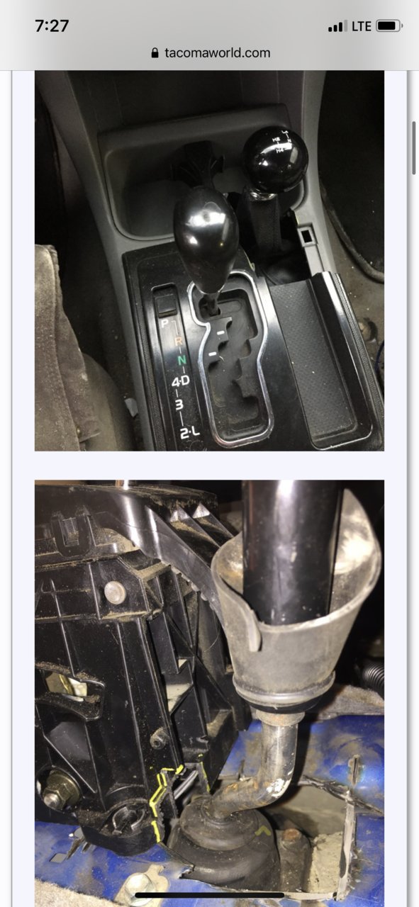

    thank you for posting this picture!! Gives me a reference on shape to sorta work from. I went ahead and bought my FJ case today!
