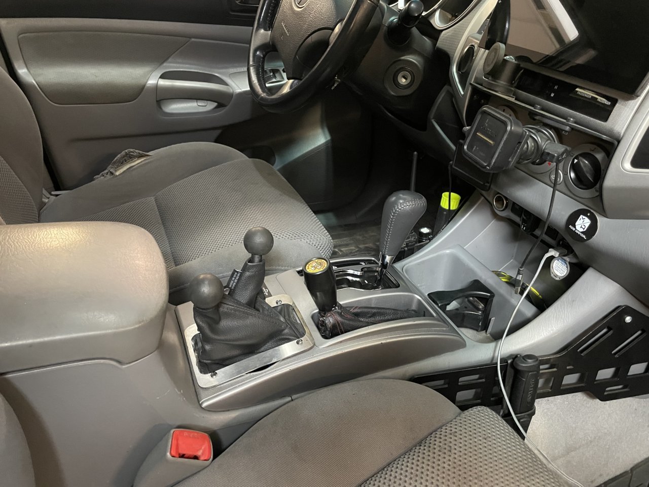

    Little more tweaking to do on the boots, but everythings in and rockin.

    Alright it’s time! Before I crack this open and duck it up. It’s a straight swap for auto tranny. Switchem cut the hole, make the console work. Idgaf about the 4wd light being on I’ll know where it is. Anything I’m missing m?

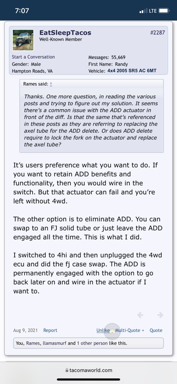

    You didnt mention ADD. Planning to delete it or rewire to a switch?

    My understanding is I can just turn the switch on and leave it. Correct? @EatSleepTacos I’ll rewire it later.

    Yea I think that works, you'd just want to turn the switch before you pull the taco case so you can get the signal from the tcase actuator.

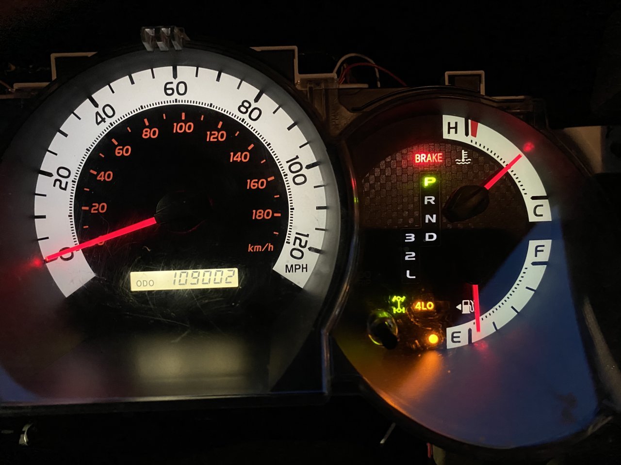

    Yep it’s still going strong. I also highly recommend wiring up the dash lights, it’s incredibly easy and nice to know when I’m fully out of 4wd. You just swap the sensors from your case to the fj case and then jump two wires at the 4wd ecu

    The wires from my donor TCase came burnt up. I’ve had enough J shift cases to know where I am. I’m going to roll with it for now

    Which is why I said transfer the sensors over from your old case so it’s plug and play.

    I agree with @EatSleepTacos
    Getting the dash lights to play ball is awesomeness.

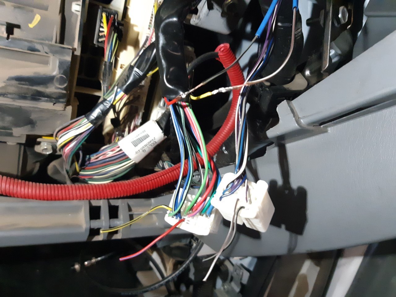

    How did you do yours? Ive tried so many times by sticking bare wire in the pin connectors, nothing.

    I know you weren't asking me, but here's how I did mine. Cut behind the 4wd ecu connectors and soldered the them.

    I was prerunner, no 4wd ecu :(

    Ah. I forgot you were a 2wd to 4wd conversion. I have nothing to offer here.

    I took a bag of money, and beat my good friend with it. Then the lights all worked.
