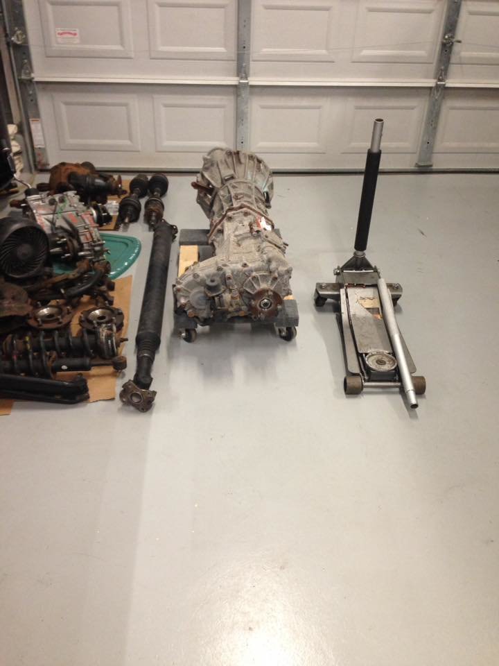

    Yesterday we took action to get another member electronic free, and pulled @MY50cal 's drivetrain to do the swap :D
    42314547_10117720439104874_1100486250344_520e9834f6d420287f59cdff4753120a146a9088.jpg
    No downside to the ADD delete other than the front driveshaft and ring gear spinning all the time which results in a small parasitic loss and possibly increased wear on the front diff. But if you look at the 6 speed FJ cruisers, they were obviously designed this way from the factory so it has already been evaluated by toyota engineers to be acceptable.
