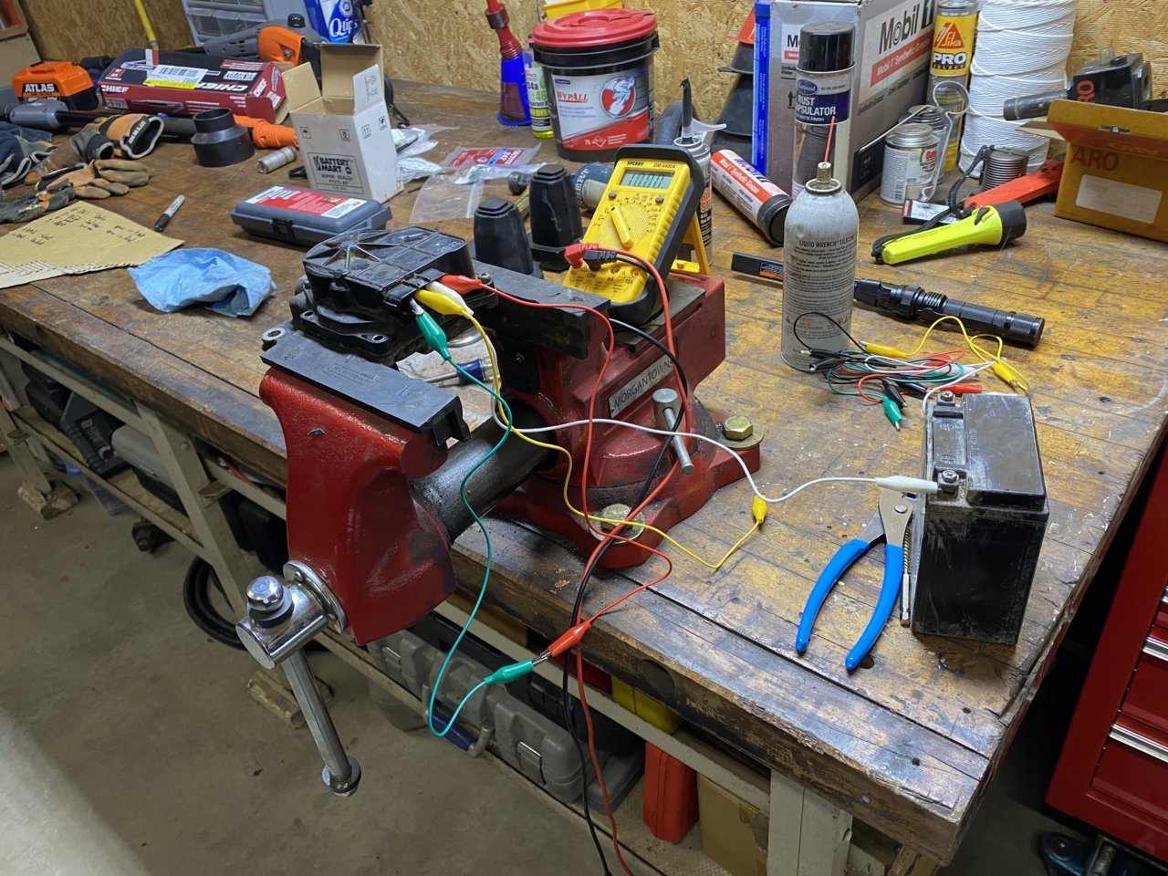

    TCase is in, anybody has issues getting the add to activate one last time? I couldn’t get it to change for shit now I just have blinking lights and 2lo

    Is the tcase actuator plugged in? If I recall correctly the ECU looks for a signal from the tcase actuator to engage the front shaft before it will flip the ADD actuator.

    I have both Plugs in the case. I just need to jump start the ADD to think it’s in 4wd so I can leave it

    pin 1 and 2 will need to apply 12v and ground respectively to lock. Use a small motorcycle battery or even a 9volt will work.

    Which color is pin 1&2?

    I think he meant in your pic so he has some sort of reference.

    oh, yeah that makes sense haha. It will be the red and white wires. If you’re not sure take an ohmmeter and measure through them to get the motor resistance. You should read around 4-6 ohms.
