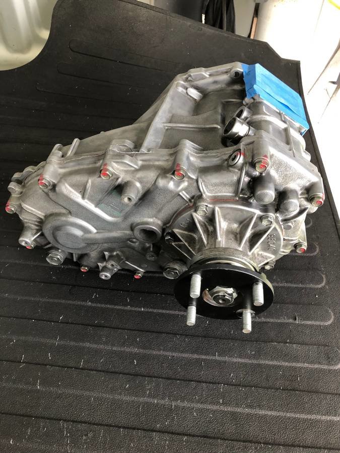

    Will this transfer case work with a 2007 Tacoma 6speed? The guy on Craigslist told me he bought it for his 06 tundra649D635E-E8AC-4CF9-93A2-2CE54E1DAC2C.jpgD44B7721-C354-4EB4-953A-D2C46D817247.jpg

    It looks like it would. Im assuming his tundra had the 4.0 V6 in it. You will need to swap the input shaft over from your current case because you’re a 6 speed.

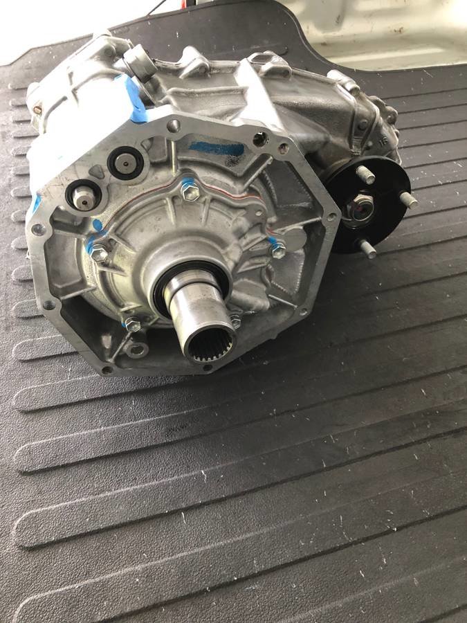

    I was curious because the spline on that output is a female and usually it’s a male splined output that I keep seeing on this thread. He said he purchased this from RST a couple years ago. If I’m not mistaken he said he had a v8.

    It depends on the transmission which is why I mentioned swapping the input shaft. The one on there in your pic is how they come from the factory but it's easy enough to crack open that case and your current case and swap them over. Also I have no idea what t case was used on the V8, it very well could be the same. I was just speculating because I know the first gen tundras also came with the 4.0 V6 that comes in our trucks.

    That's the input shaft, and the splines on all the FJ cases are male, there is a coupler on your picture to adapt to a 23 male output spline at the transmission for a truck with the slush box. The 6 speed transfer case will require a 22 spline male thread to engage into the transmission.
