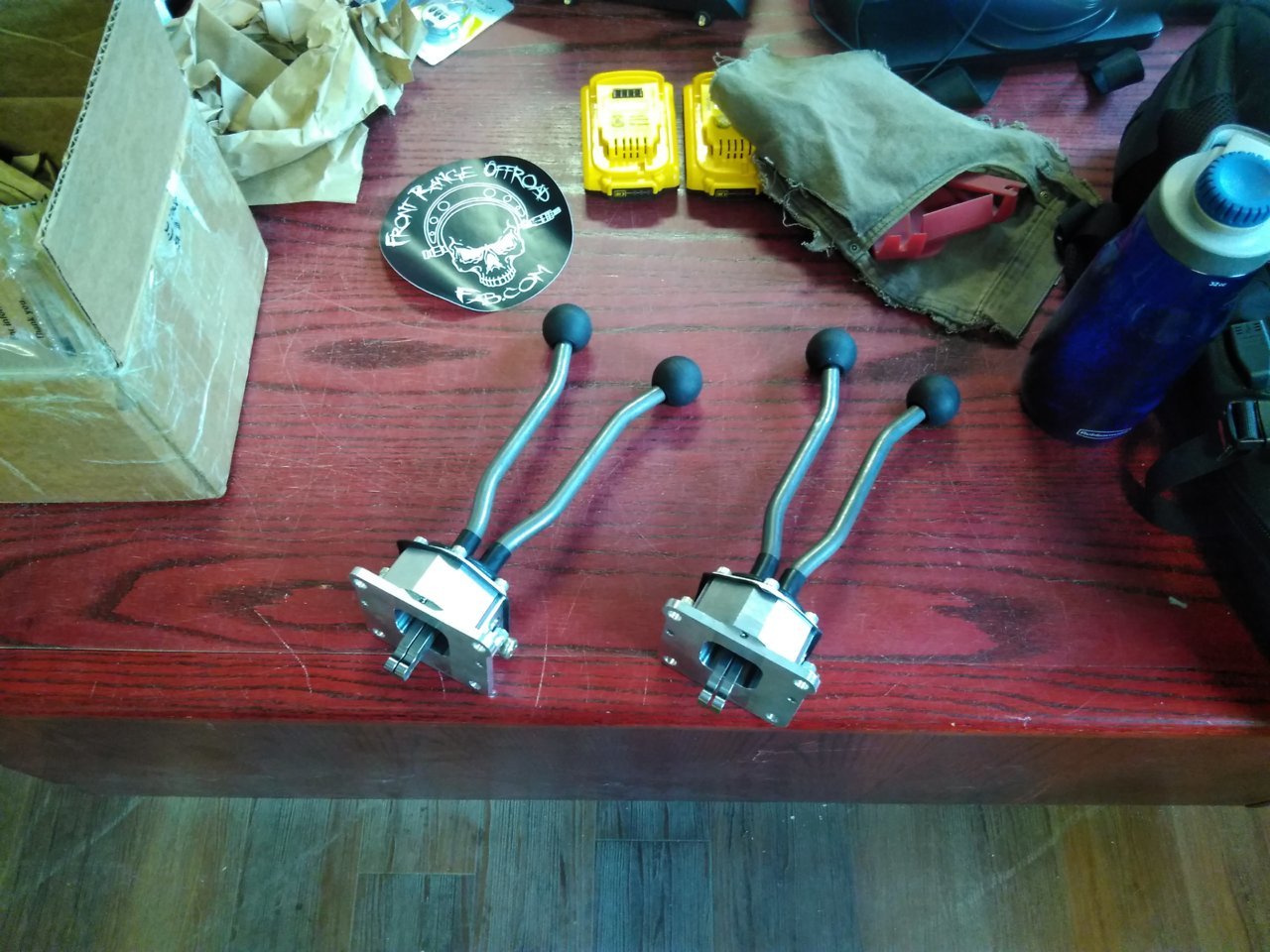

    Shit bolted onto other shit, and junk.
    Anybody still make twin stick kits?

    Pretty sure front range off-road does

    FJ t-case with twin sticks, UTE bed, some other things :D
    Yep that is where I got mine!

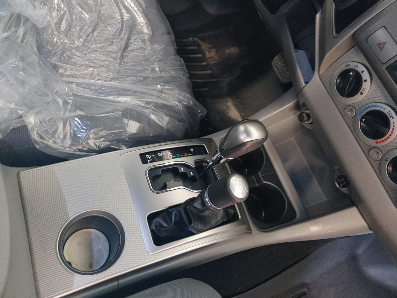

    Jwithers
    Jwithers Master baiter
    Nov 24, 2019
    #311615
    593
    Jacob
    Charlotte NC
    07 ACLB SR5
    OME 885 & Bilstien 5100 JBA UC DAKARS & OME NITROS Timbren Active bumps SOS Hybrid Front SOS sliders and skids
    Finished up the interior today. I wanted to keep all The console intact I think it turned out great 9B114268-F970-4510-B3BB-EBBDF0766823.jpg

    _Rhoades
    _Rhoades Well-Known Member
    Sep 20, 2018
    #266928
    240
    Dustin
    Washington State
    2014 Black Tacoma TRD OR
    Do you have a picture of before you put the console back?
