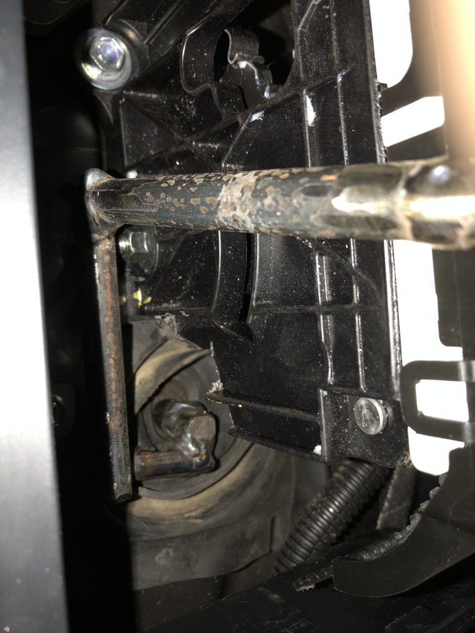

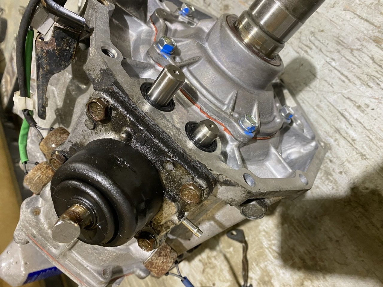

    Can anyone assure me, before I crack this monster open, that I'm in 2WD?
    llamasmurf likes this.
  4. Jan 11, 2022 at 5:02 AM
    #2464
    BassAckwards
    BassAckwards Well-Known Member
    May 3, 2016
    #186002
    27,954
    2009 Tacoma AWD Turbo 2TR-FE
    Full-time AWD & BorgWarner EFR 6258
    Spin the input shaft and watch which outputs turn. Only the rear one should
  5. Jan 11, 2022 at 10:34 AM

    Don't stress if the little peace's fall out they're not super hard to get back in place. Mine still fell out even in 2H. I had to pull up the service manual to figure out were they go. and used some grease to help hold them in place. Found there service manual here.

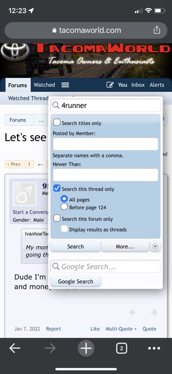

    welcome, and yeah it’ll work. Pro forum tip, the search function is kinda shitty but also kinda good if you’re looking for something super specific by checking the “search within this thread” box. I had to search in this thread a handful of times while I was mid swap to find an answer.

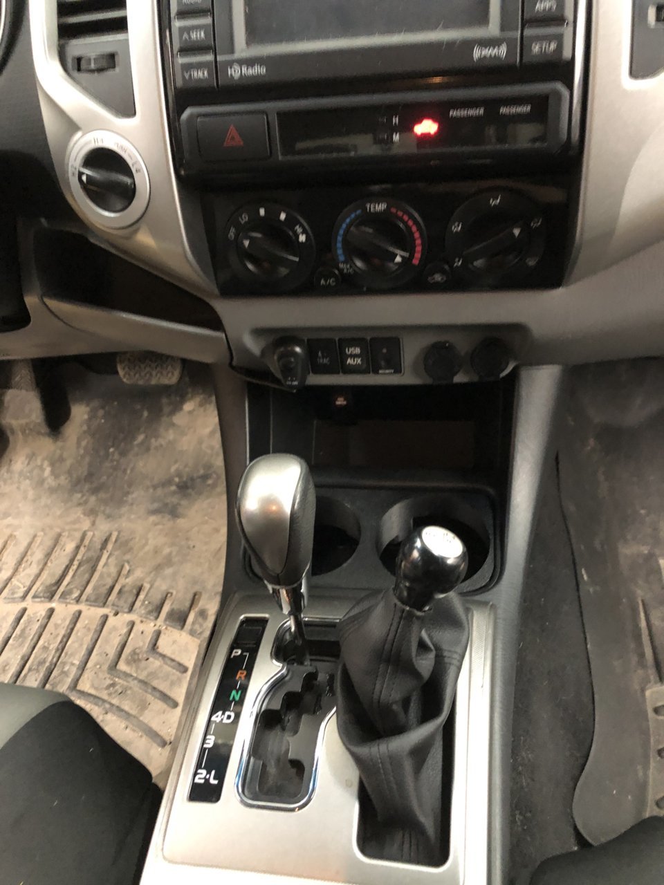

  20. Mar 22, 2022 at 10:12 PM
    #2480
    blakeape
    blakeape Member
    Feb 26, 2022
    #391245
    10
    2012 Tacoma TRD Offroad 4DSB
    8D03B38B-AC82-47E8-91C2-F620DB9798DA.jpg C5B9BF81-FF6E-411F-8590-F3554911AA68.jpg

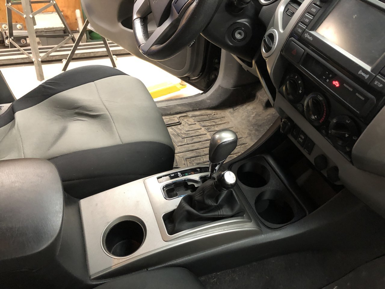

    So everything seems to be working. I have my 4wd and low range lights wired in and am just waiting for a few things to do the locker anytime mod. When I put it into 4wd my traction control and atrack lights come on. I don’t remember that being the case before when I used the knob to just go to 4wd?? Thanks for the great thread
