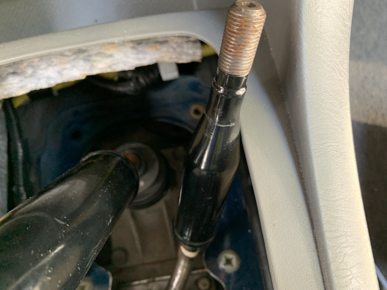

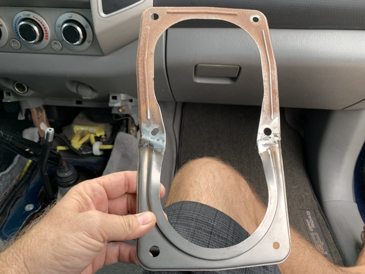

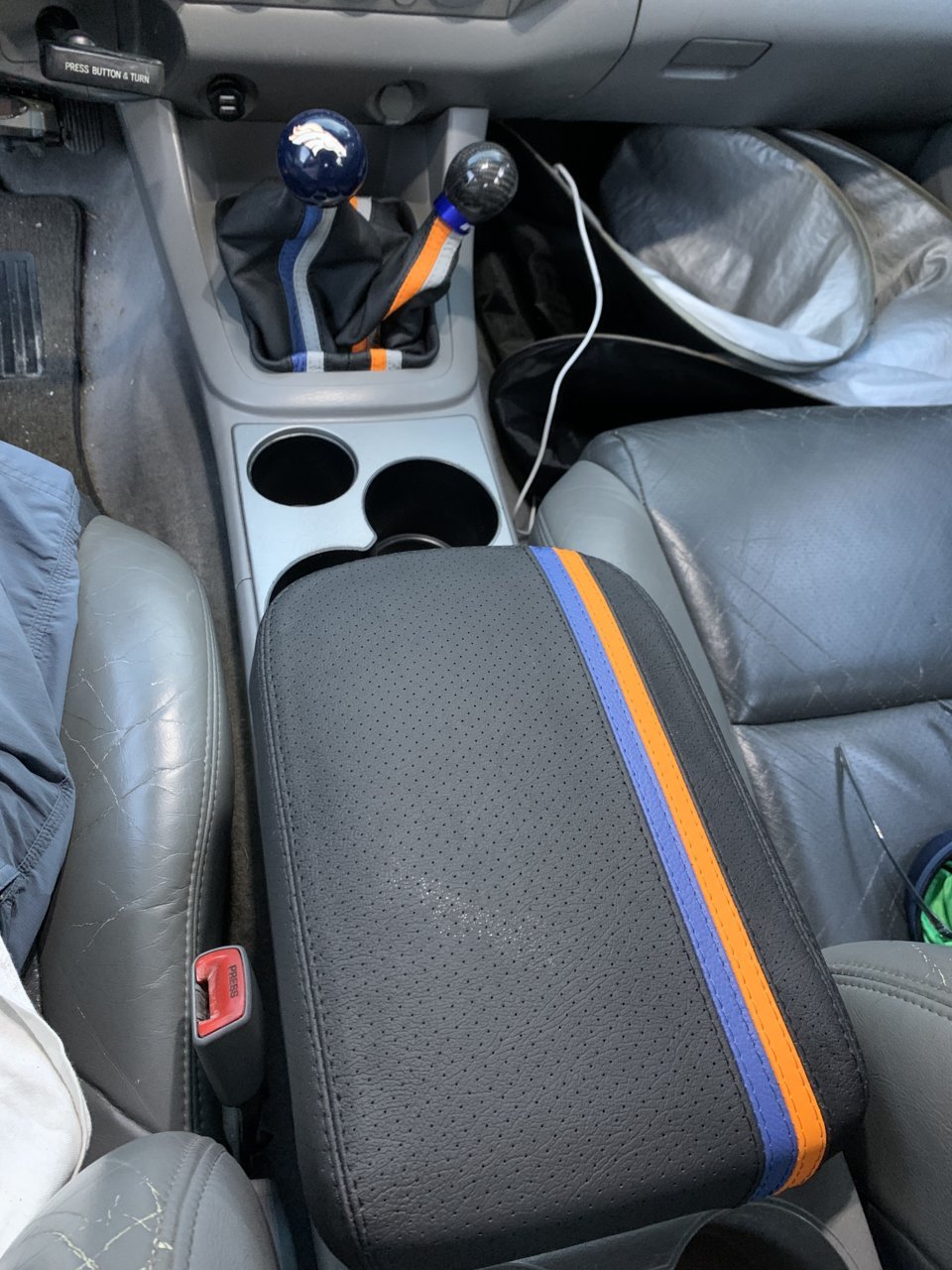

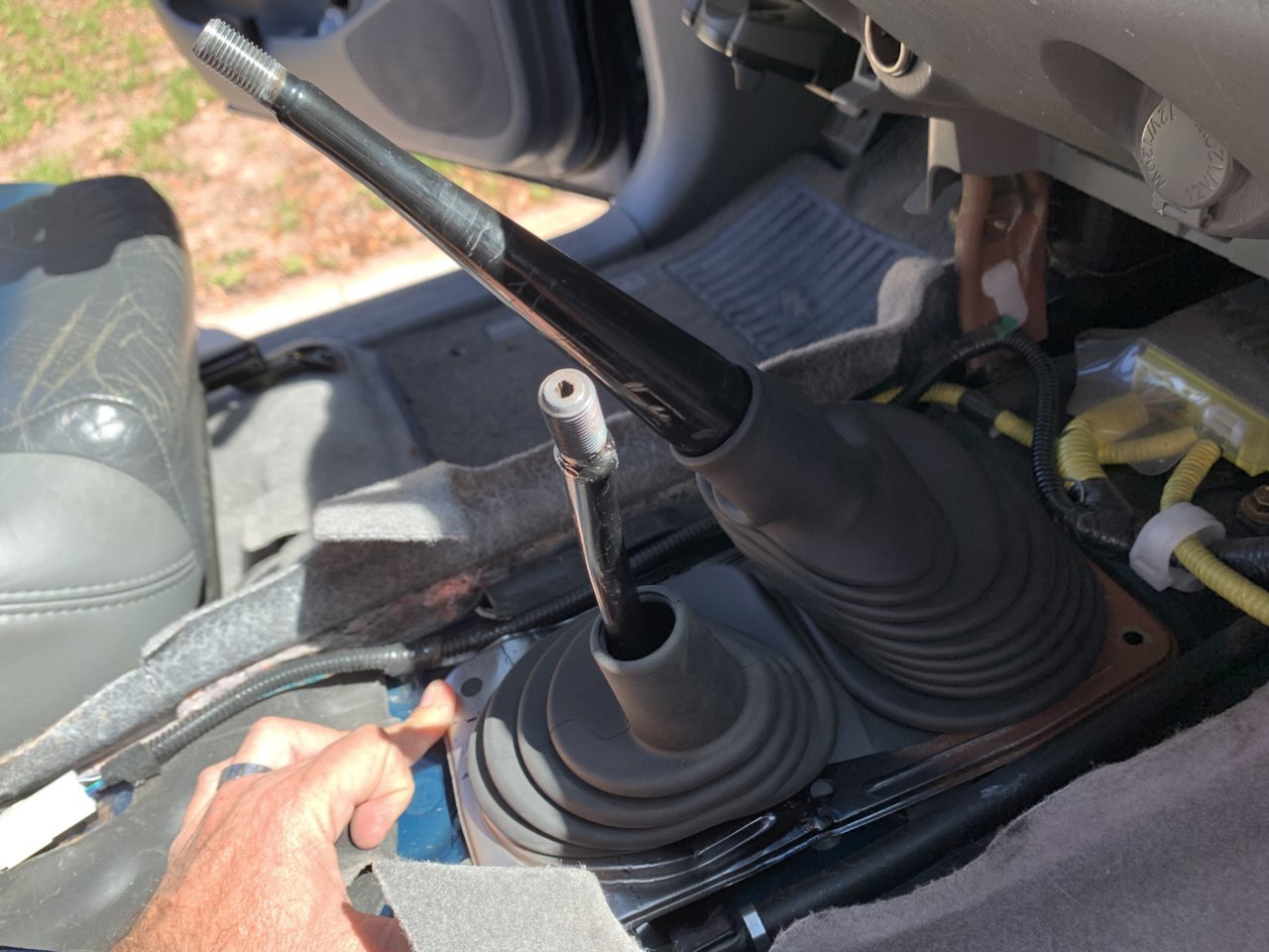

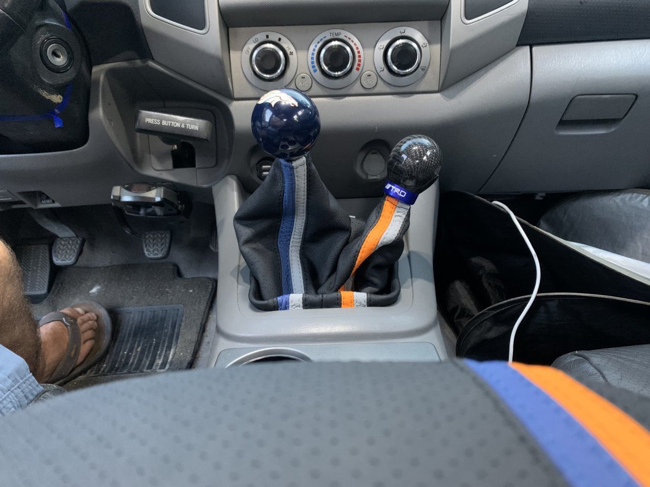

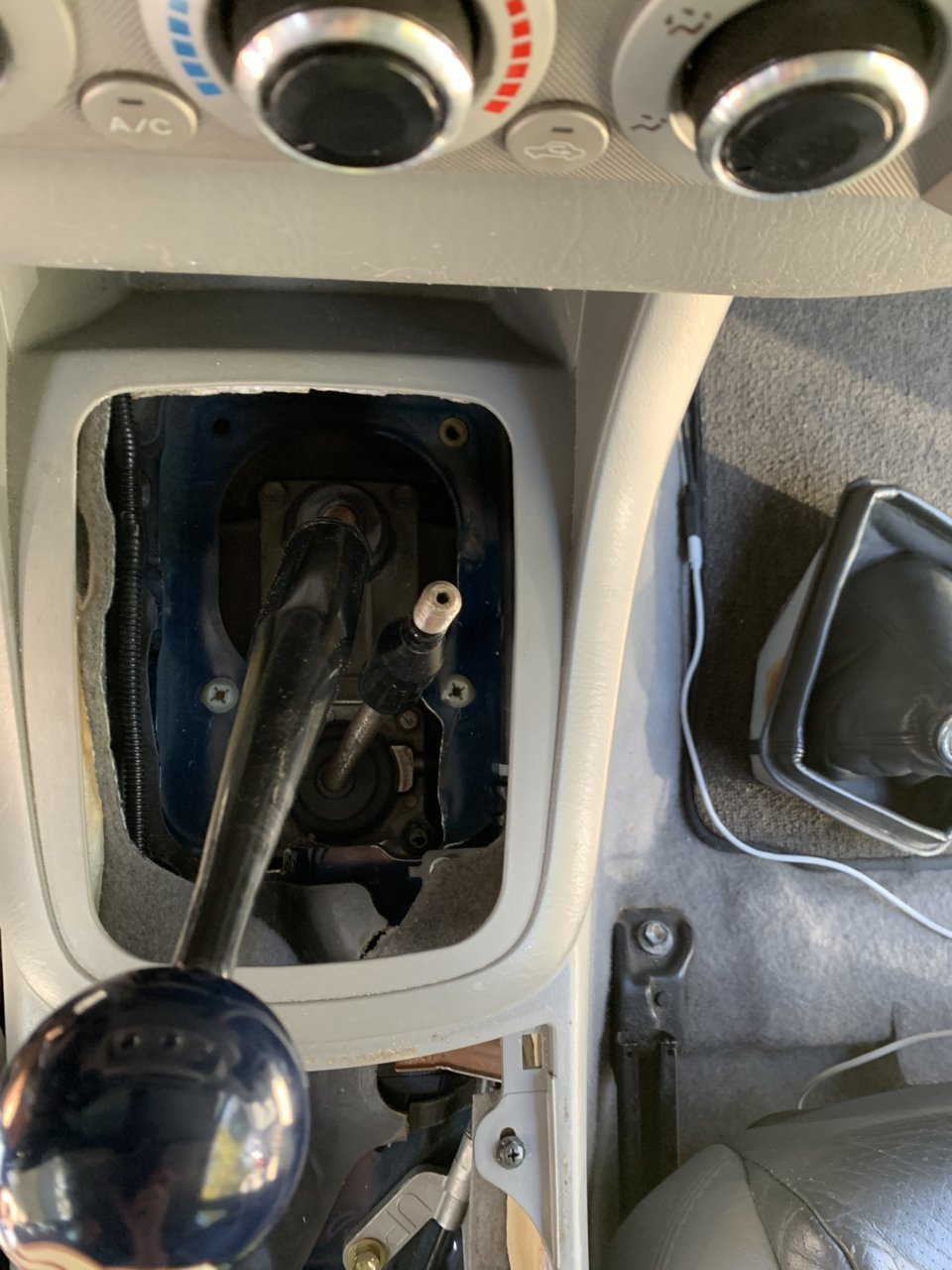

    I want to sincerely thank the TW community once again, for providing the information and knowledge needed to get this swap accomplished. Dash lights and everything work perfectly. This has to be one of the greatest threads going. I look at every tacoma now differently.....
    I have 2 items remaining to do:
    1- need to get the T-Case lever adjusted with the help of a welder's torch (scheduled for Friday) so that I can get into 6th gear with the transmission, and that will hopefully also take care of the minor side of the plastic housing rub that is also present currently when into 4low.
    1a- have the welder mesh the FJ and Taco rubber boot frame. [EDIT: Complete]
    2- buy a nice shift boot from Redline Goods to finish this out. [EDIT: Complete]

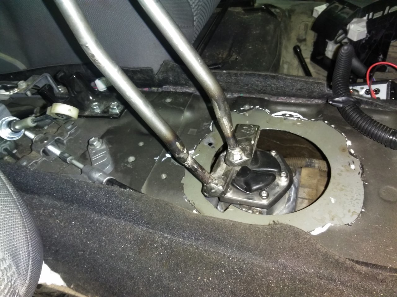

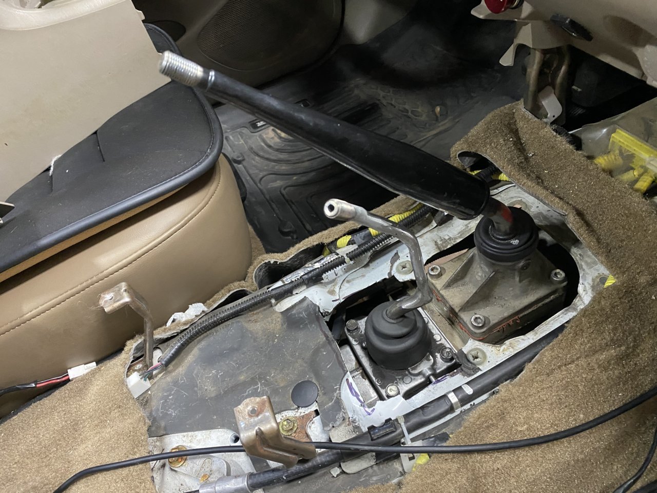

    My shift lever ended up looking like a rotten pile of dog shit but it ended up working out really well. I could've remade it once I found where the angles needed to be but I didn't think it was worth it.

    2018 new Frame (thank you Rust!), FJ T-case swap. SPC(LR) UCAs, Bilstein 5100s front - rear, OME 883 at 0, HeadStrongOffRoad 3 leaf progressive AAL, MESO custom 2nd gen (Red/White) LED dome & Ultimate Maps, Spyder Halo Projector w LEDs (which SUCK), Spyder LED tails

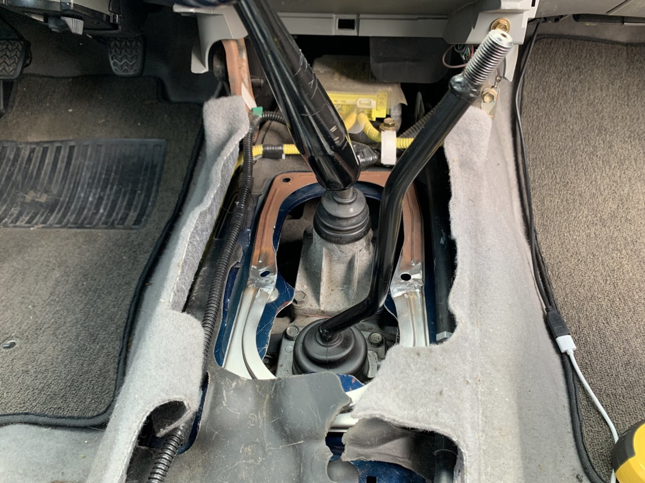

    This week I had the new case lever modified so I have 6th gear again... But it still rubs the side of the stock plastic housing in 4Lo, but I can live with it....
    I also see now the reasoning behind the Toyota dampered shift levers......
    I'm not a welder, and sure wish I was... the ring should have been a bit longer and wider, but again, it will work....
