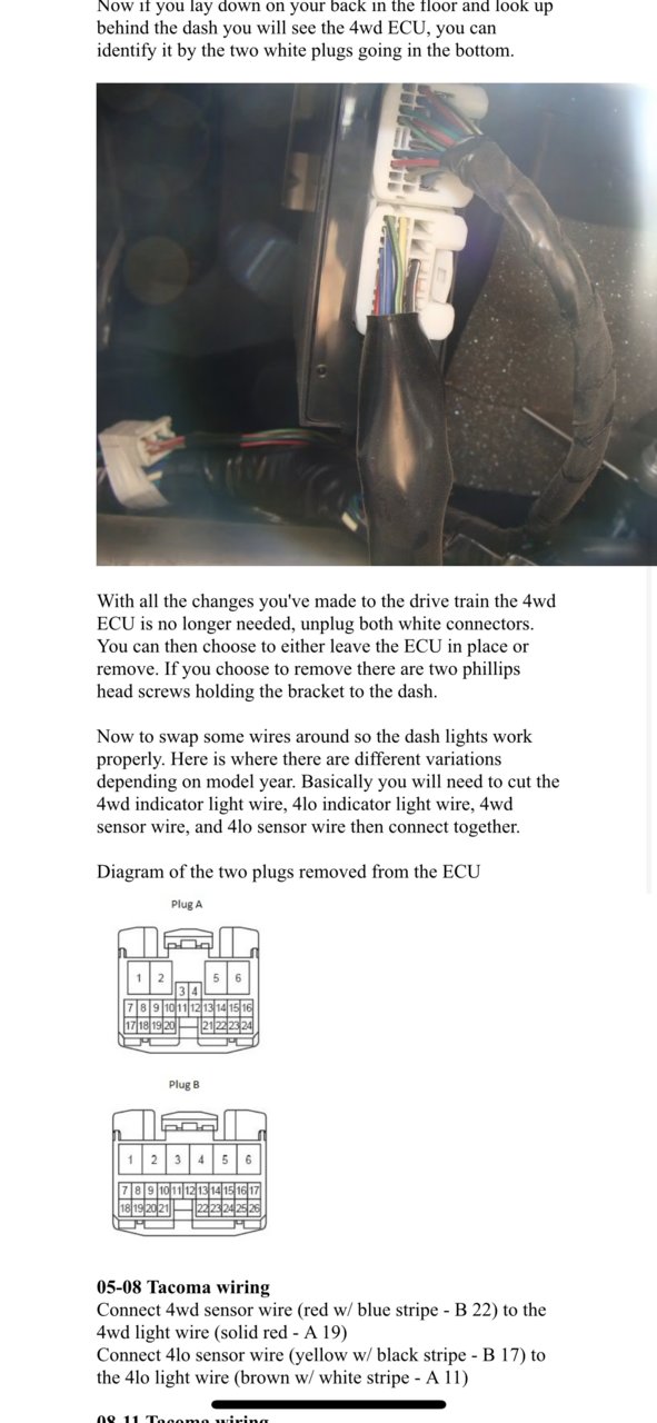

    I haven't ever found anything on the wiring other than the butt connectors you need at the 4wd ECU. Going from a single plug on the E-CASE to the MANUAL with 3 plugs on it. I'm guessing just grab a wiring diagram and make new connections? Never set mine up just always had the flashing lights on the dash...
  4. Apr 26, 2022 at 8:00 PM
    #2504
    fatfurious2
    Jun 28, 2014
    #132884
    49,908
    David
    Ashburn, VA
    2010 TRD OR Access Cab
    Does above help?

    For those with 2012-2015, the process of jumping two wires from the 4wd computer together is the same and the pins stayed the same but the wire colors are different, F12 pin 11 and 19.
    Huge thank you to the Certified Electron Pusher. :D

    Sup fellas. Looking to make sure I have everything in order to do this swap so hoping some of yall can give me some pointers if needed.
    Basically I'm going to be doing a ADD delete as well as the tcase swap (also throwing in a front diff from ECGS with an arb). I split the sticks myself using the RST write up and got some shifters from front range. I also ordered everything listed to do the ADD delete listed in the How to: Deleting ADD system. Aside from that stuff, what else do I need to get my trucks 4WD working? I'm under the impression that I won't need anything else. truck is a 2015 4.0/Auto.
    Just unsure on what will need to be done to the 4WD ECU (if anything). FWIW idc about dash lights working I just want some good ol manual 4wd shifting. thanks!

    Unplug the 4wd ecu and you won’t have any flashing dash lights as far as I’m aware. That was the case with my truck but mine’s old enough to lack traction control. Other than that, you can jump a few wires at the 4wd ecu to get your 4wd and LO lights to work on the dash, but that’s really it. None of this will impact your ability to still manually go into 4wd.

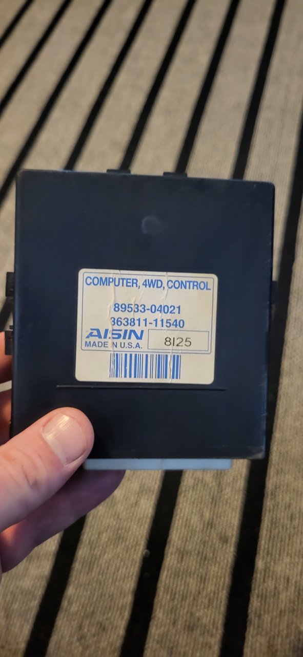

    Hoy there! I've been a long time lurker, and finally signed up. I never thought of it, but someday it will be helpful.
    Anyone went to delete ADD and ditch the 4WD control unit? I actually need to replace my burnt 4WD control unit if anyone have a spare? The part number on the sticker shows 89533-04020.
  17. Aug 13, 2022 at 11:16 PM
    #2517
    Ariyan
    Ariyan Well-Known Member
    Mar 3, 2014
    #124459
    500
    NM
    4x4 TRD Sport
    SAS, 40s, and some armor.
    if you decide to replace it I have one from my 2014 sitting on the shelf.
    4x4MA[QUOTED] likes this.
  18. Aug 13, 2022 at 11:23 PM
    #2518
    Key-Rei
    Key-Rei Well-Known Member
    Jun 20, 2017
    #221942
    7,863
    Key
    Florida
    2010 TRD Off-Road 6Spd 4x4 209BSM
    Locker anytime Fog Lights anytime Full LED light conversion TRD cat back Rear cat delete Exaust Y reroute away from actuator Alloy Clutch master 2000 4Runner "Dog Leg" shift leaver Marlin shift seats and bushing Rear seat delete Rear diff breather extension Chrome grille swap Debadge Rear seat delete Honda blower motor beefy plug and wire mod Anytime 12v and USB with volt gauge in bed Blue Sea fuse box Hella AND 70's Caddy horns Low profile recessed hex drain plug swaps Alluminum battery strap 7pin relocated Backup cam on anytime Various other creature comfort and personal taste mods.
    How'ed you burn it up? I'm sure it's happened to folks before but I've never heard about or seen a thread for it having happened.
  19. Aug 14, 2022 at 6:03 AM
    #2519
    Littles
    Littles Stupid is as stupid does.
    May 14, 2014
    #129837
    3,434
    Bryan
    Elizabeth, CO
    3 tons of fun
    Don't know if it will work for you as the P/N is different and it's out of a manual, but you can have it. Edit: out of a 2009.
