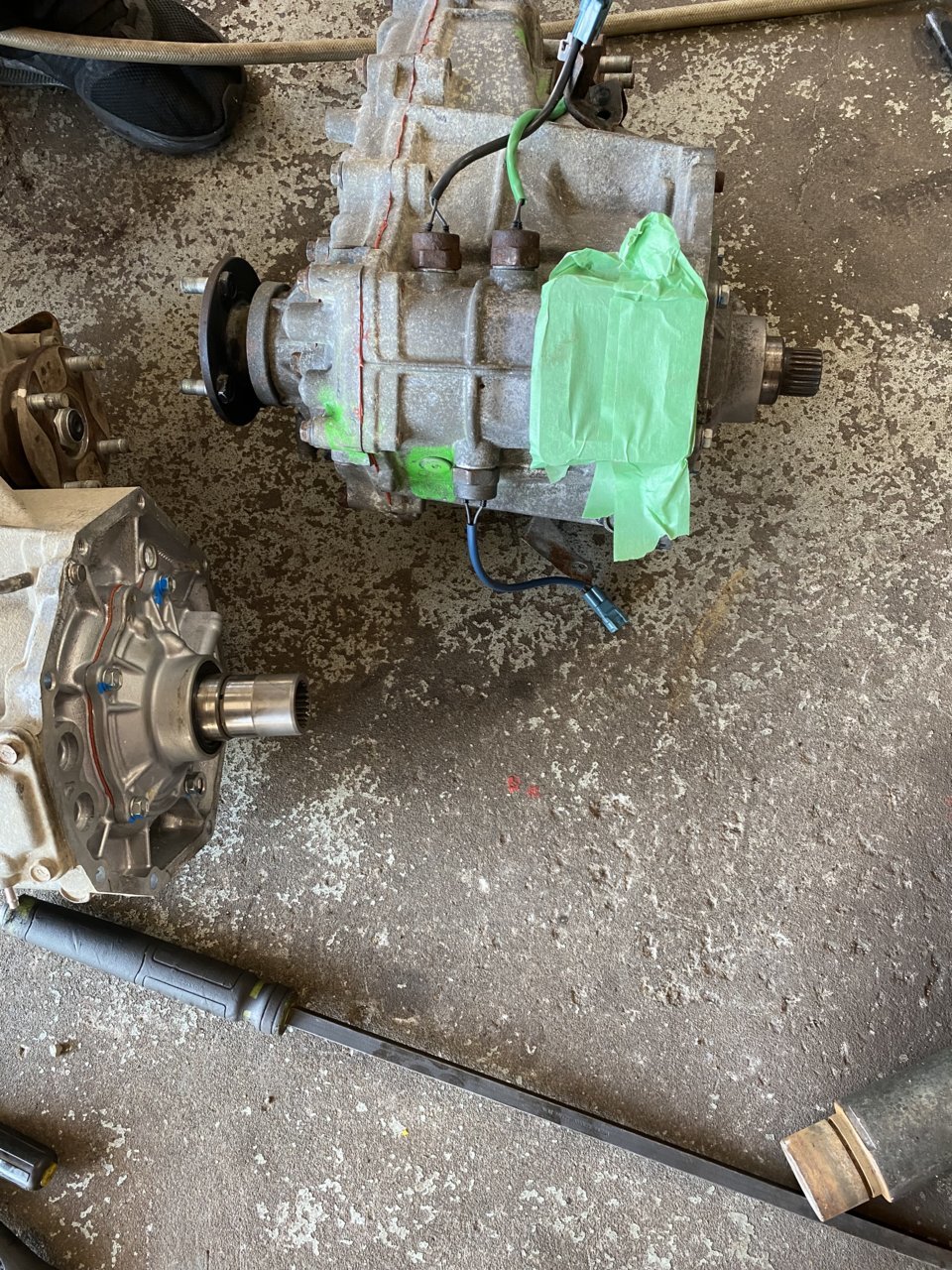

    So I guess I didn’t do enough research or I messed up but how do I get the sleeve off the shaft.. didn’t realize I had one there as the FJ case didn’t come with. Any help would be great. Trucks on the lift apart and I’m scratching my head where I went wrong

    No clue how to get just the sleeve off, but if it comes down to it you can swap over the entire input shaft. Typically that sleeve is on the FJ case too.

    i used a punch and hammerr one time to get it off. the other time used a nut welded to the sleeve and made a makeshift slide hammer

    Ended up throwing the original case back in so I could drive home. Basically my situation was I work at a ford dealer and had to be out by 4 so I was on a time crunch. I’m no mechanic just a parts bitch so I’m not pro at this stuff. Going to order a new sleeve and just get one on the fj case and be ready to do the swap in the next upcoming weeks… did get the front diff with the fj tube installed though - that was fairly easy.
    Getting the sleeve on I assume is pretty straight forward?
