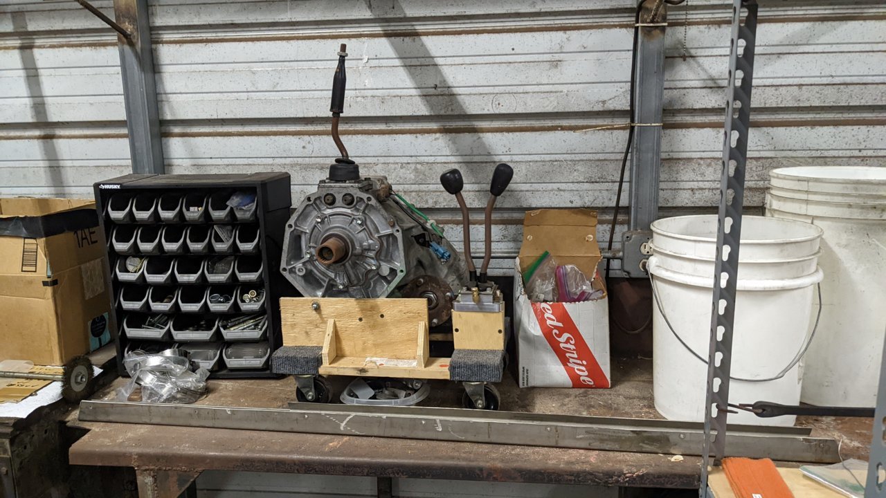

    Use a bearing puller to remove. Use a shop press to reinstall.

    Dunno if it counts as progress but I got it off the floor and on the bench.

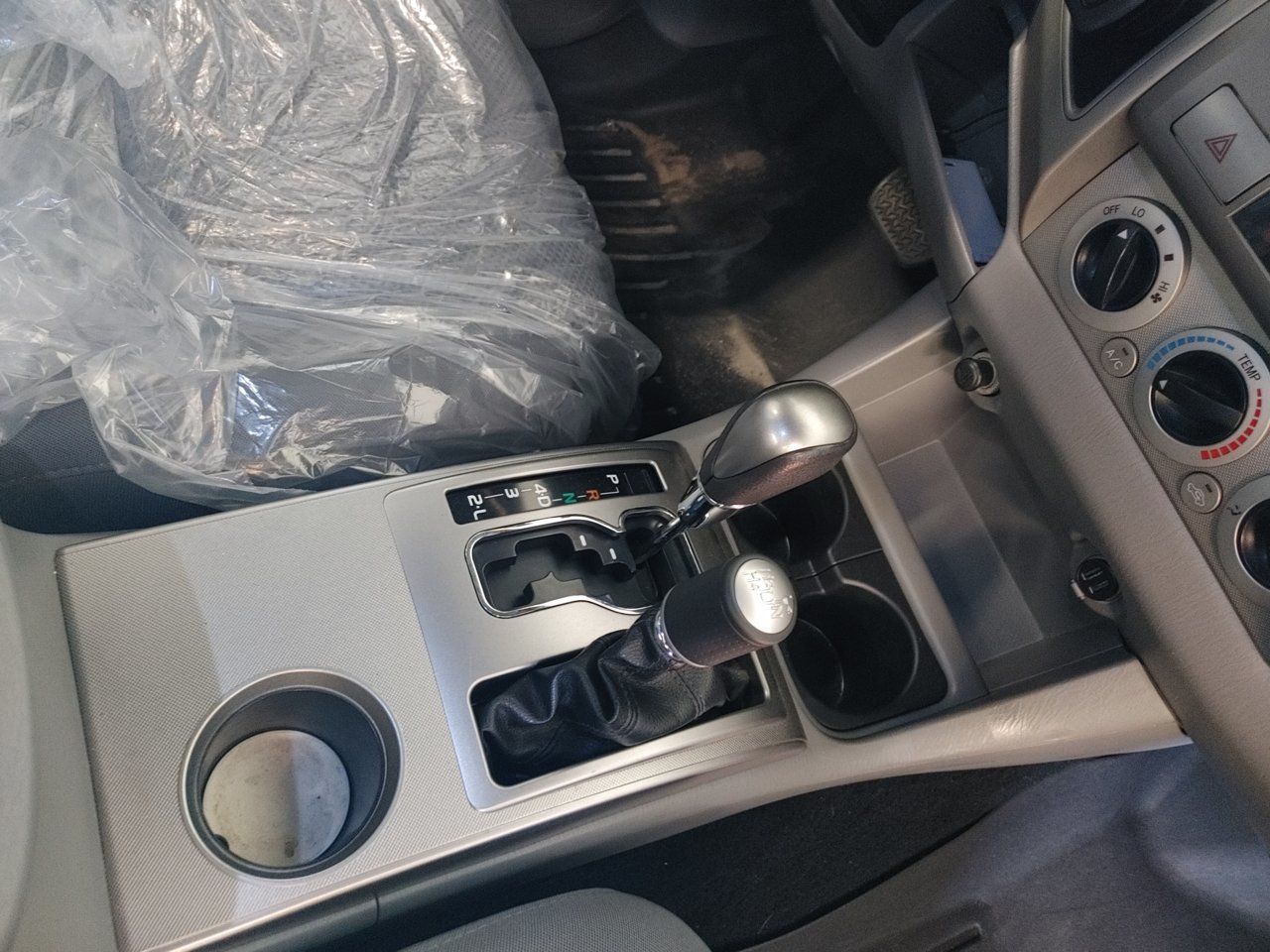

    3F4167D3-A537-447F-AF43-BA7E49BEA709.jpg Well she’s in.. got some cleaning up to do On the shifter/floor for clearance and finish the shifters but case swap complete. Thanks to everyone who’s helped and posted their own swaps.

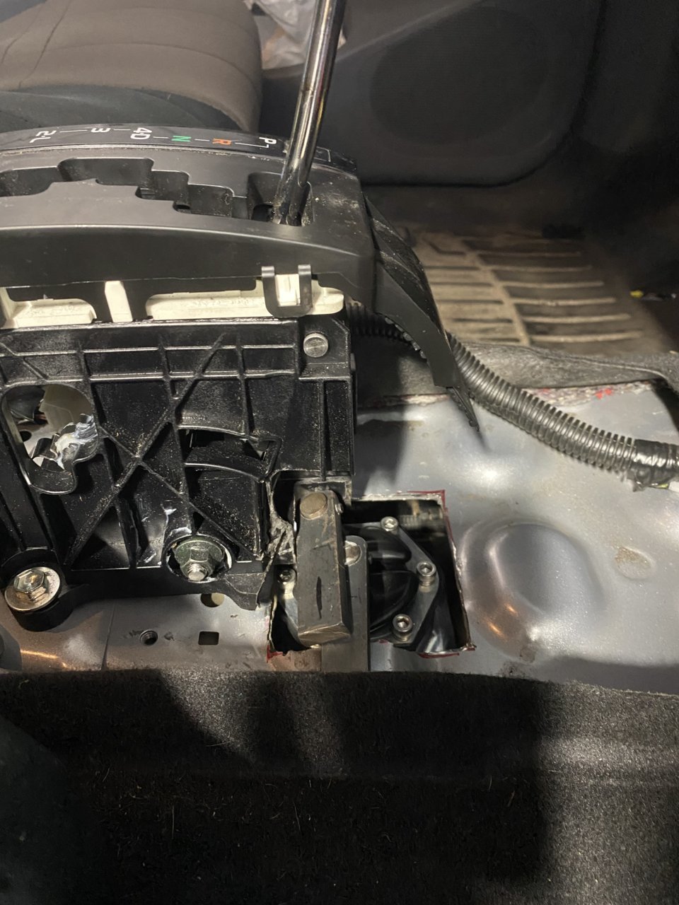

    Good job, thats exactly where I cut my hole.
    Came out like this:
