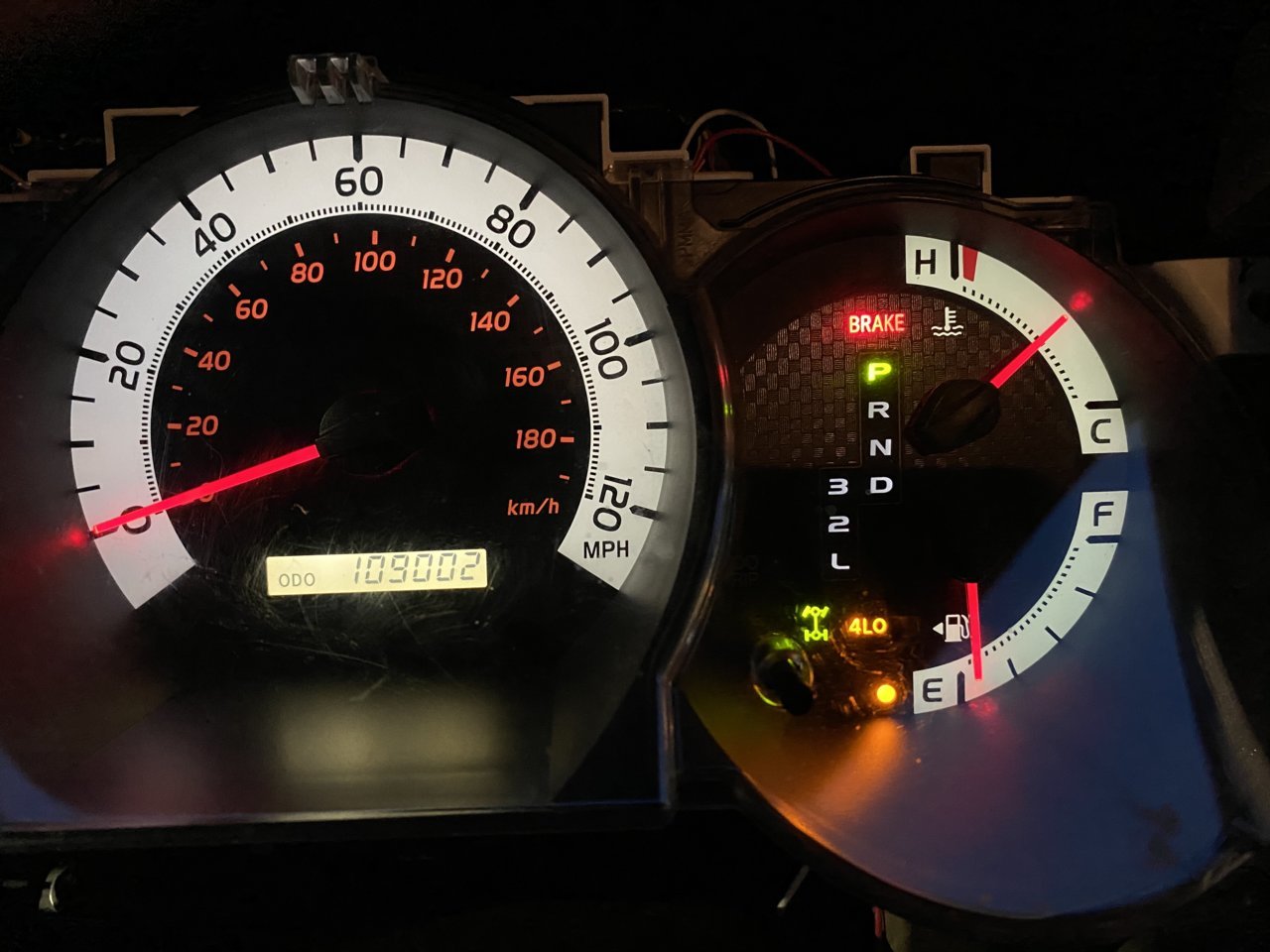

    Yes, see the red and white wire in my pic. Thats all you would need to disconnect. Yours will be diffrent color as i had no wires so i just used my own.

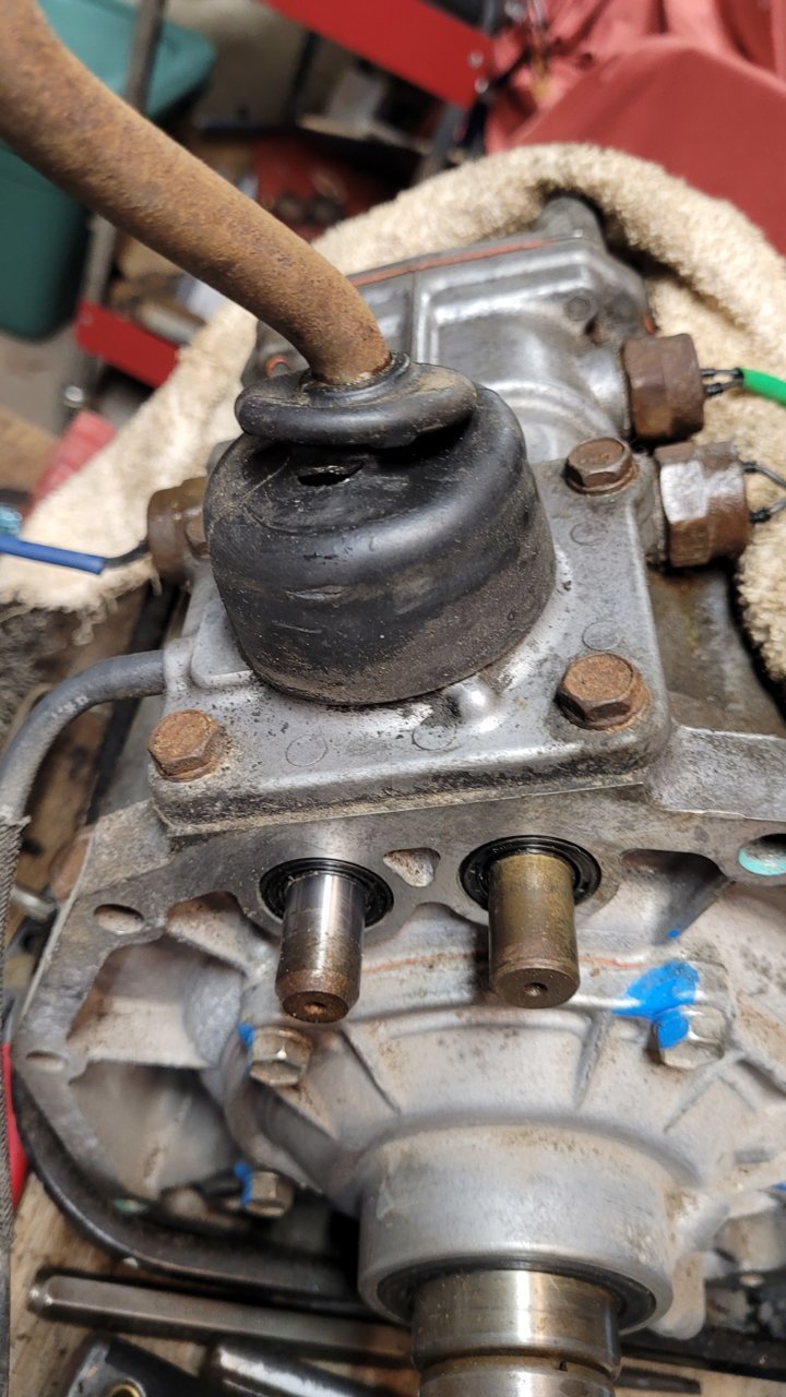

    Do these two rods (that travel in/out of the case when the shift lever is moved) engage anything in the transmission? Or is the usefulness limited to what occurs inside the t-case? Picked up this case from a 2010 4runner automatic. 20221222_181306.jpg

    They don’t do anything inside the transmission

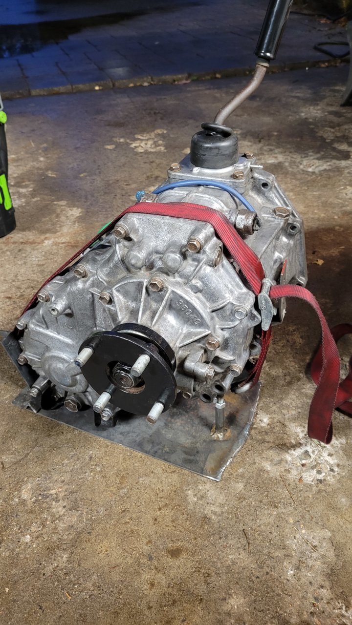

    Picked up a used Tcase. Took off the shifter assembly (undid 4 bolts on top) as well as the filll and drain plug, the shone a flashlight inside. Looked clean inside. Didn't see any chunks of metal or shavings etc. Case has 130k km or 81k miles on it. There wasn't a lot of gear oil in the case, but I'm assuming the wrecker I bought it from drained it before removal.
    I don't want to split the case unless necessary. Anything to check before I put into service.... or just bolt 'er up and see what happens?

    I'd just bolt it up

    I would just cycle through the different modes and ensure it all works as it should. You can spin the output flange with your hand while you do it.

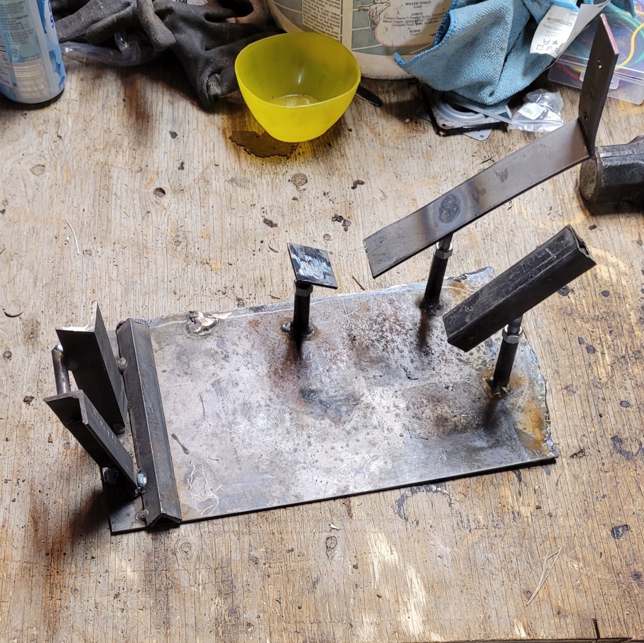

    Had some spare time and some scrap steel. Welded up an adapter to hold the tcase with some basic adjustment so the tcase can be leveled out. When I eventually get around to installing this in warmer weather, will weld the adapter to something that can be attached to my jack.

    i have been wanting to do something like that for a while

    I wouldn’t be too worried about it. You got a pretty low mile case. Mine had well over 250k kms, so while I had it apart for the twin stick I re did some gaskets and stuff just to make sure. Just got a rebuild kit from toyota for it.
