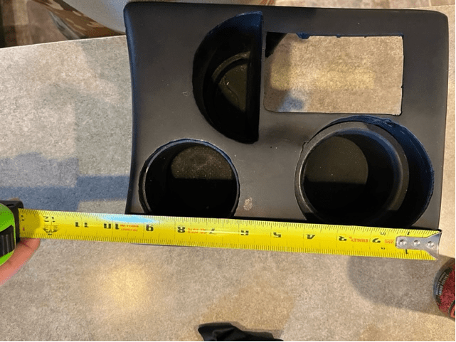

    so, for anyone that has a 6spd with a crawl box, I am going to get a new cupholder piece 3d printed at the end of the month. the company that makes it may sell them afterwards. it will look like the pic below however, the red marks will not be a half cup holder like i have in my truck currently and the big full cupholder will be slightly smaller so that the hole for the shifter can be enlarged slightly. once paid and I am happy with it, ill post up the final pic in here
    this is what it currently looks like
    this is what i plan on having changed (in red)
    also, it should come with tabs for a shift boot to be installed
    this is what it currently looks like in my truck
