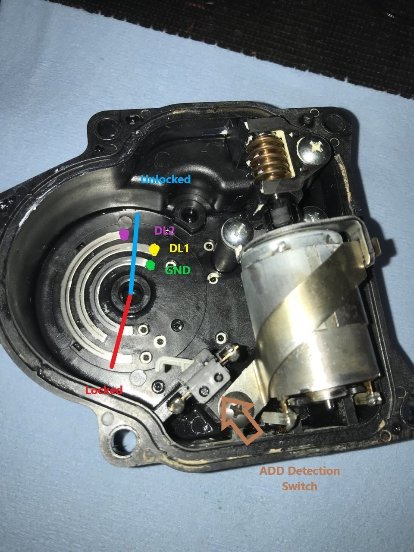

    I would leave the whole unit tied up and rig some kind of bag around the shift fork. There is a seal there that keeps the gear oil from going into the motor housing, but leaving that area exposed to the elements could cause the shift fork shaft to seize up if dirt or grime gets in there.

    On the opposite side of the electronics box is the fork itself
