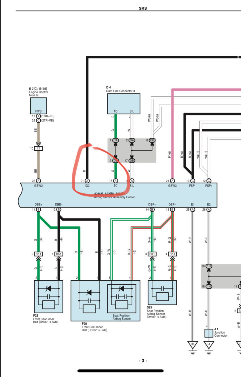

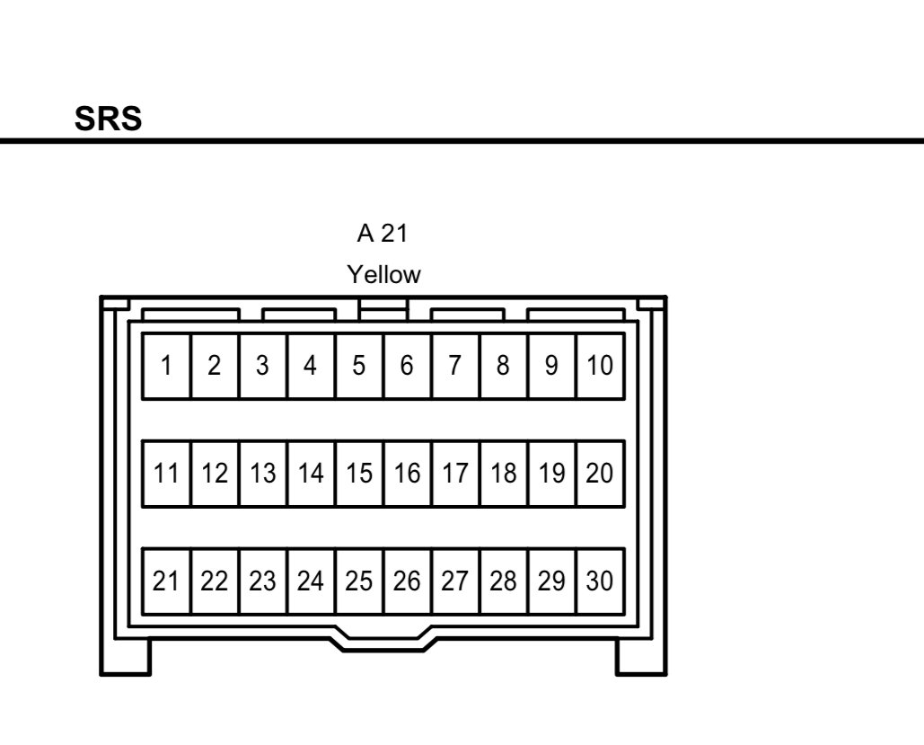

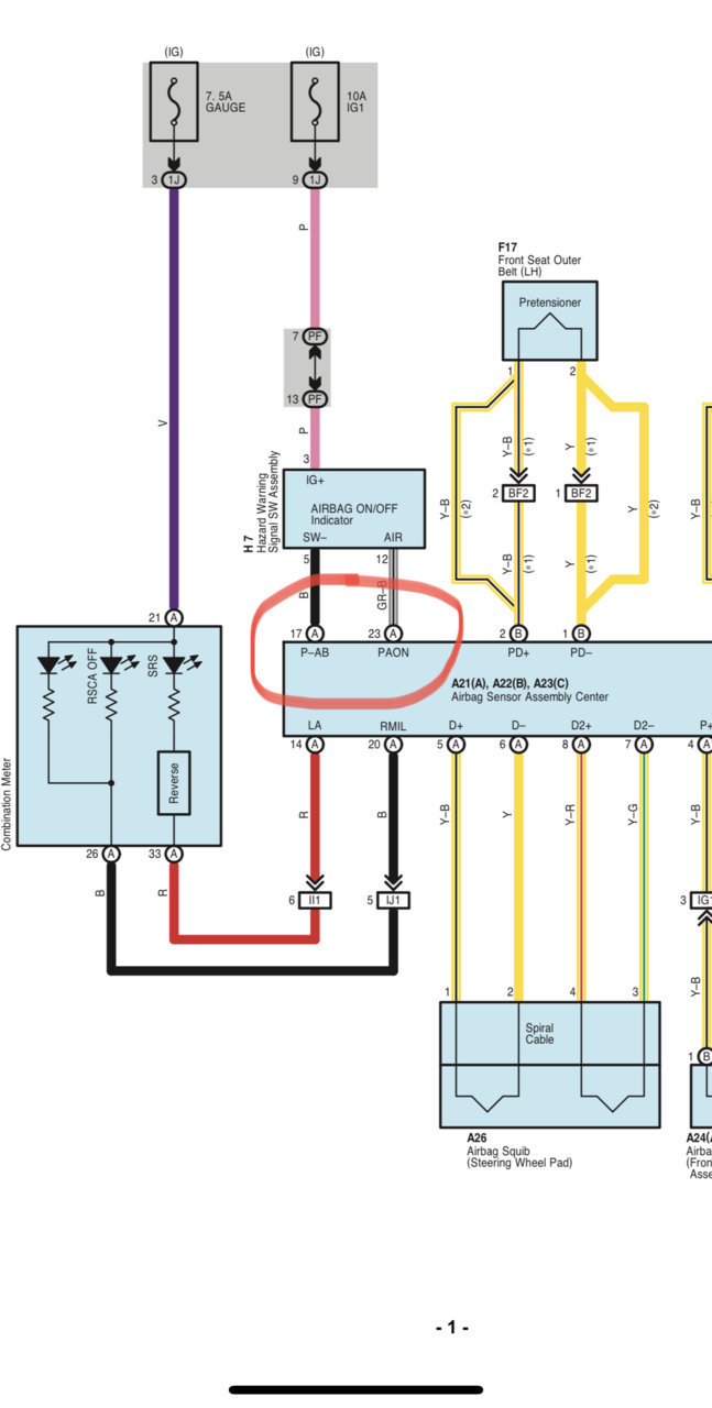

    the squib valves are energized to actuate so removing ABS ECU power would do just fine. Connector A by the center console, in front of the shifter area, namely pins 17, 21, and 23. I’m sure you’ll get some lights on the dash but shouldn’t cause any issues for drivability as far as engine ECM is concerned.
