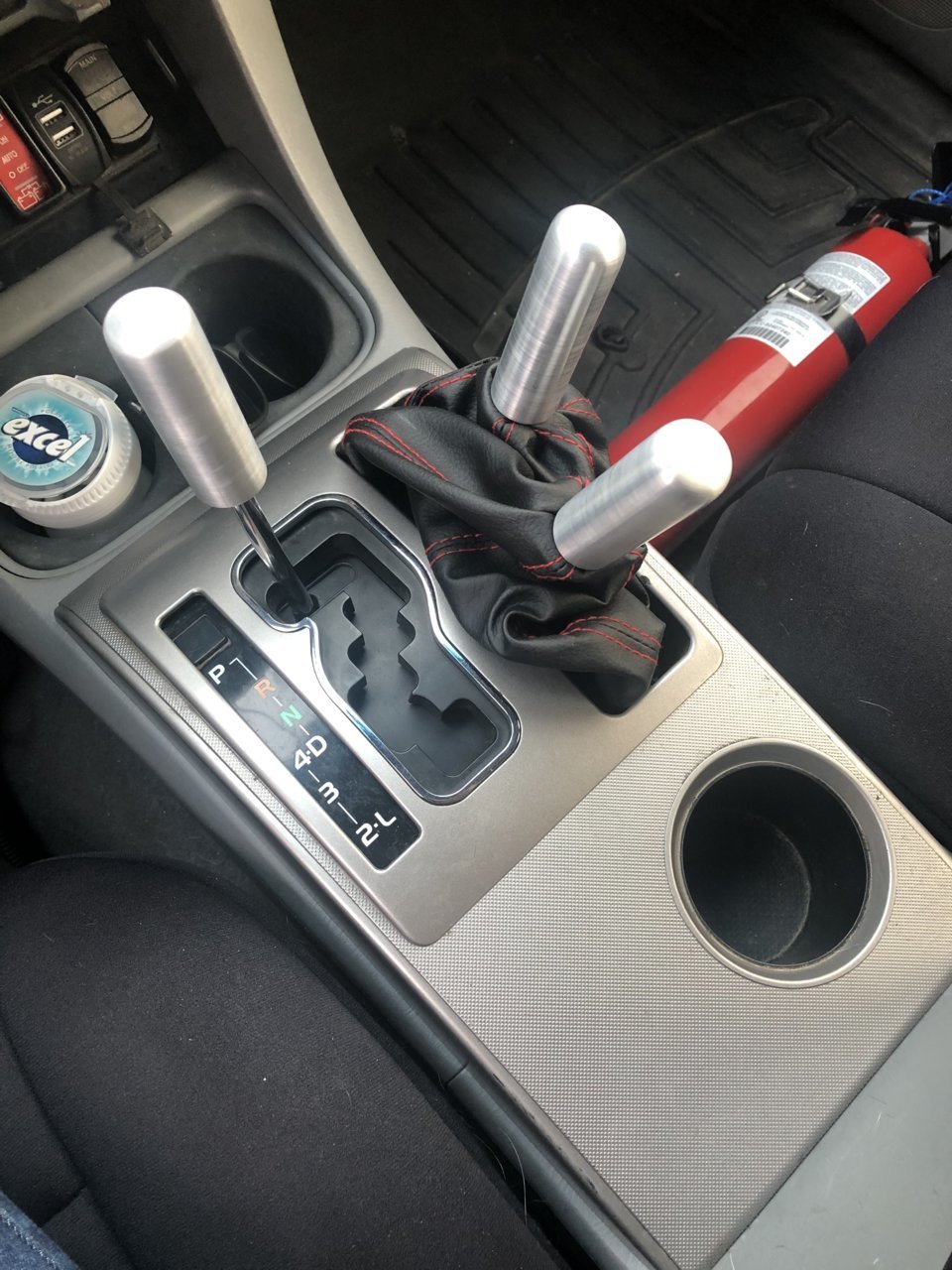

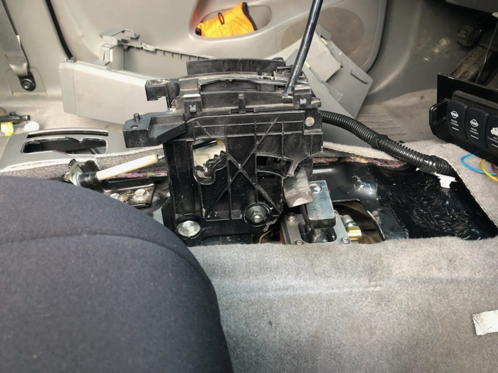

    Mines in the pencil tray. For me 2L is nice so I can stay in low all day on the trail and be in and out of 4wd when needed. We run trails with all level trucks/drivers so sometimes it’s a crawl that I can be in 2wd for while the stock truck is working their way and learning how to drive. Prior to it was also stop, neutral and going from 2hi and 4lo. And 2hi was too much too.
    And the pic of how it all looks.
    Under the column
    not sure where you are in Canada but more then happy to show you and answer any questions. Little rusty on some stuff since I did it a few years ago now but let me know.

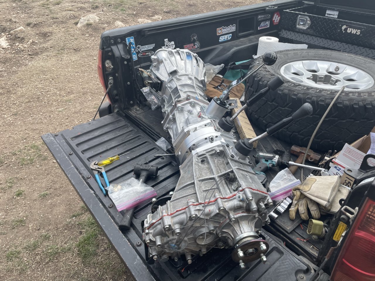

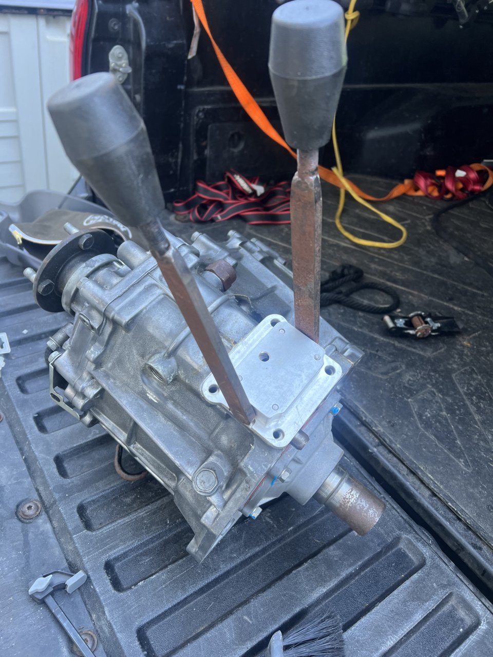

    Does anyone know what shifter this is? Looking for a proper boot. All the boots I’ve found seem to be for a sticks closer together.
  10. Apr 11, 2023 at 8:21 AM
    #2670
    6 gearT444E
    6 gearT444E Certified Electron Pusher
    Feb 3, 2018
    #243372
    7,795
    Deep South
    Herculiner Hootus
    looks home made to me.
    Taco47[QUOTED] likes this.

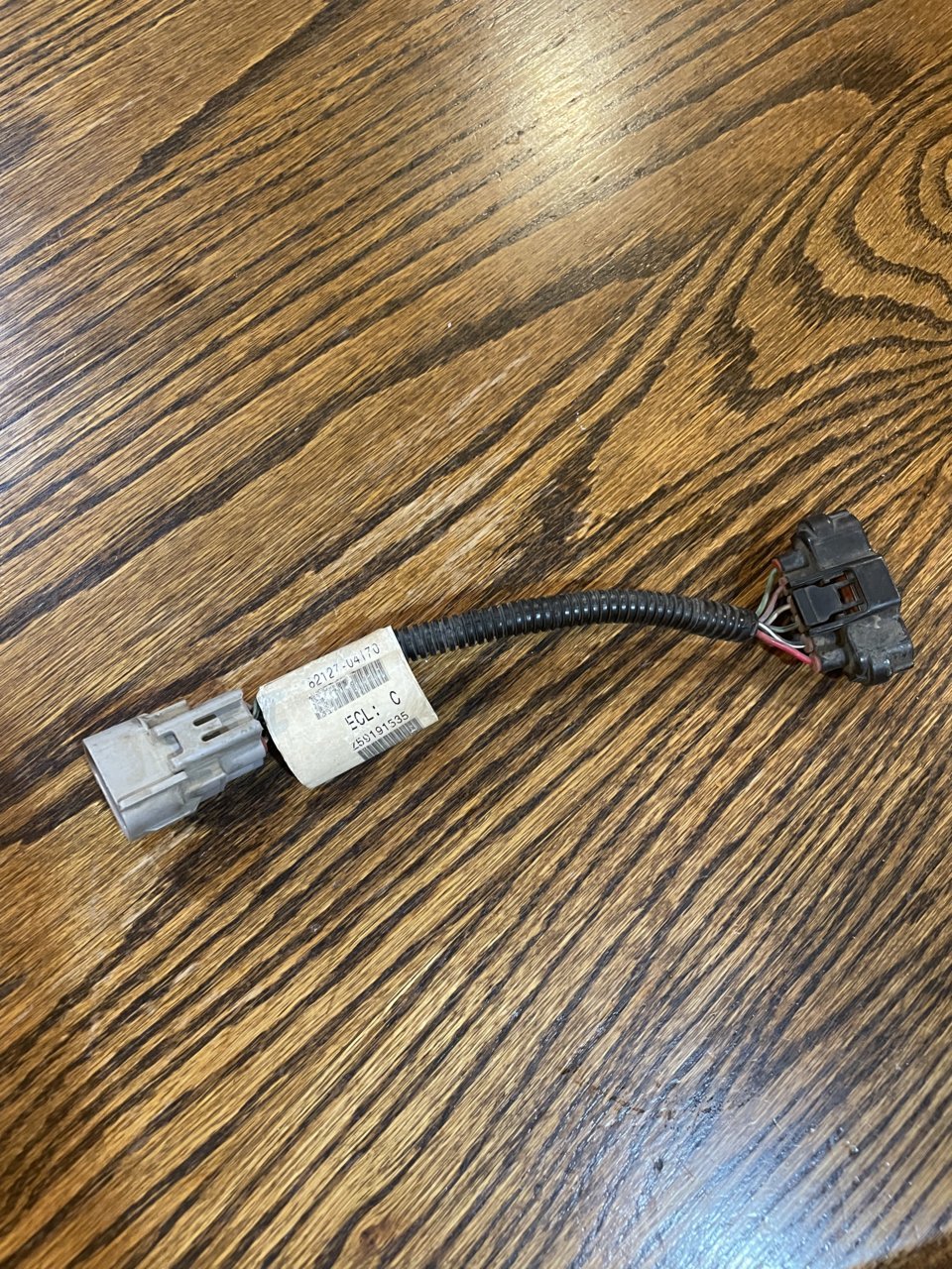

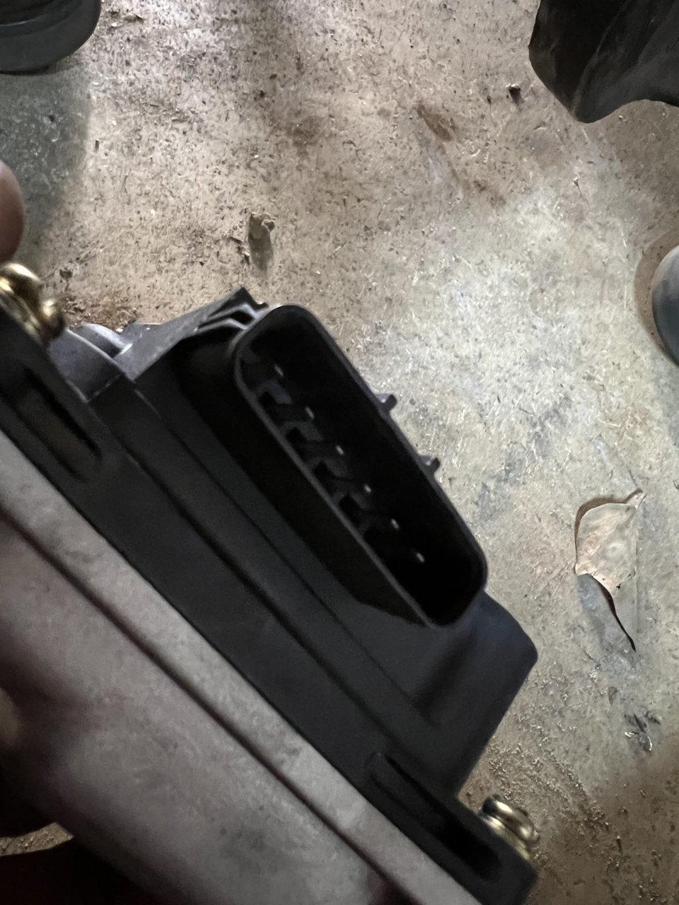

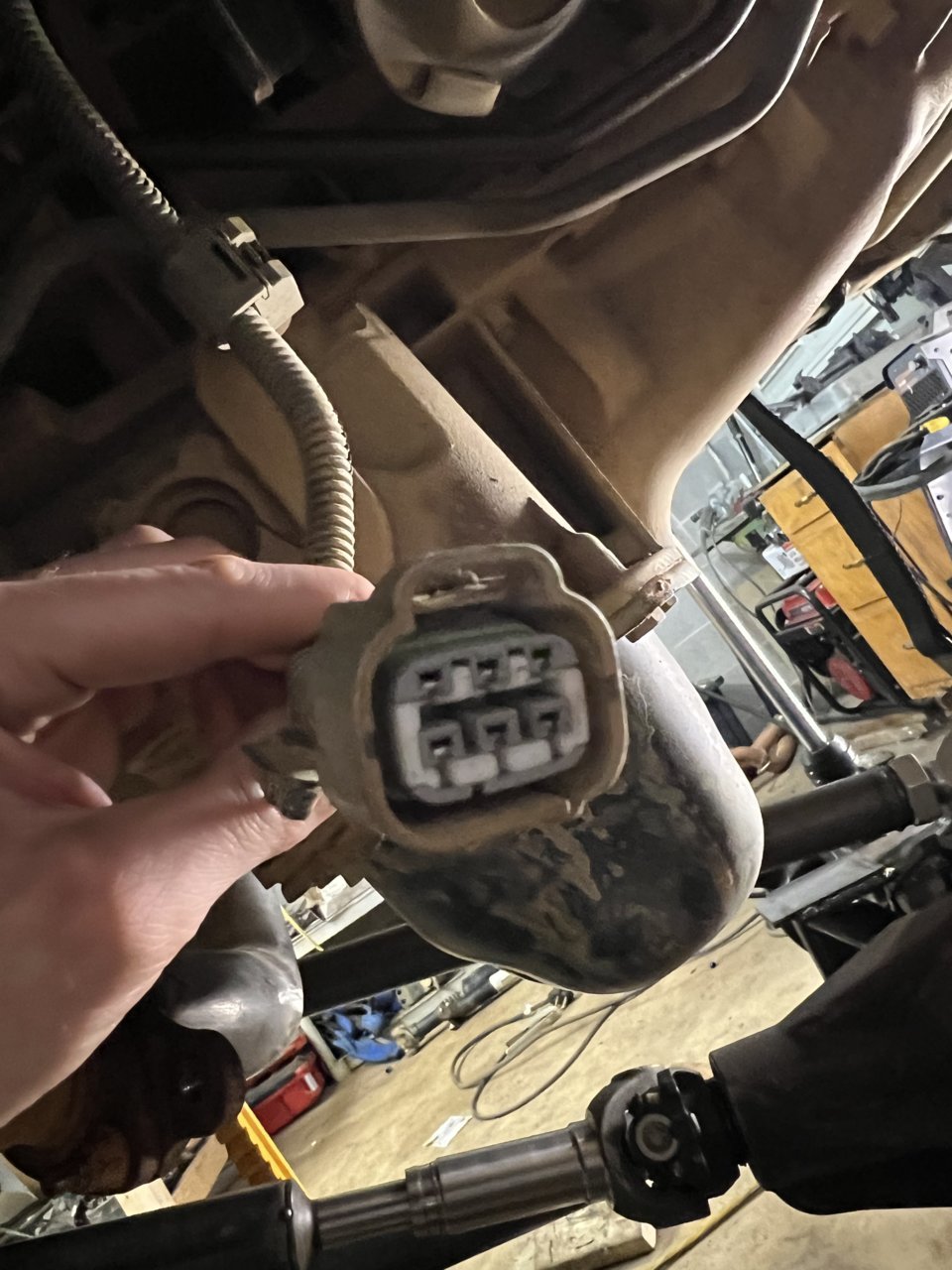

    Hope someone either has one laying around or can point me to one. Didn’t realize I needed a harness from the frame side to the actuator. I sold mine with the front diff :annoyed:
    Ricardo13x likes this.
  12. Apr 12, 2023 at 7:20 PM
    #2672
    BassAckwards
    BassAckwards Well-Known Member
    May 3, 2016
    #186002
    27,952
    2009 Tacoma AWD Turbo 2TR-FE
    Full-time AWD & BorgWarner EFR 6258
    Is this what you need? You can have this one if so, I deleted my ADD

    You’re the greatest person alive. That had me so worried. I couldn’t find one anywhere online. Charge me what you want. I’ll send a PM
  14. Apr 12, 2023 at 7:29 PM
    #2674
    BassAckwards
    May 3, 2016
    #186002
    27,952
    Just cover shipping and it’s yours. It’s been sitting on the shelf for months, im glad to see it get put to use. I just need to find some time to get it shipped. I am slammed right now with the tax deadline. Might be early next week before I can ship it out.
