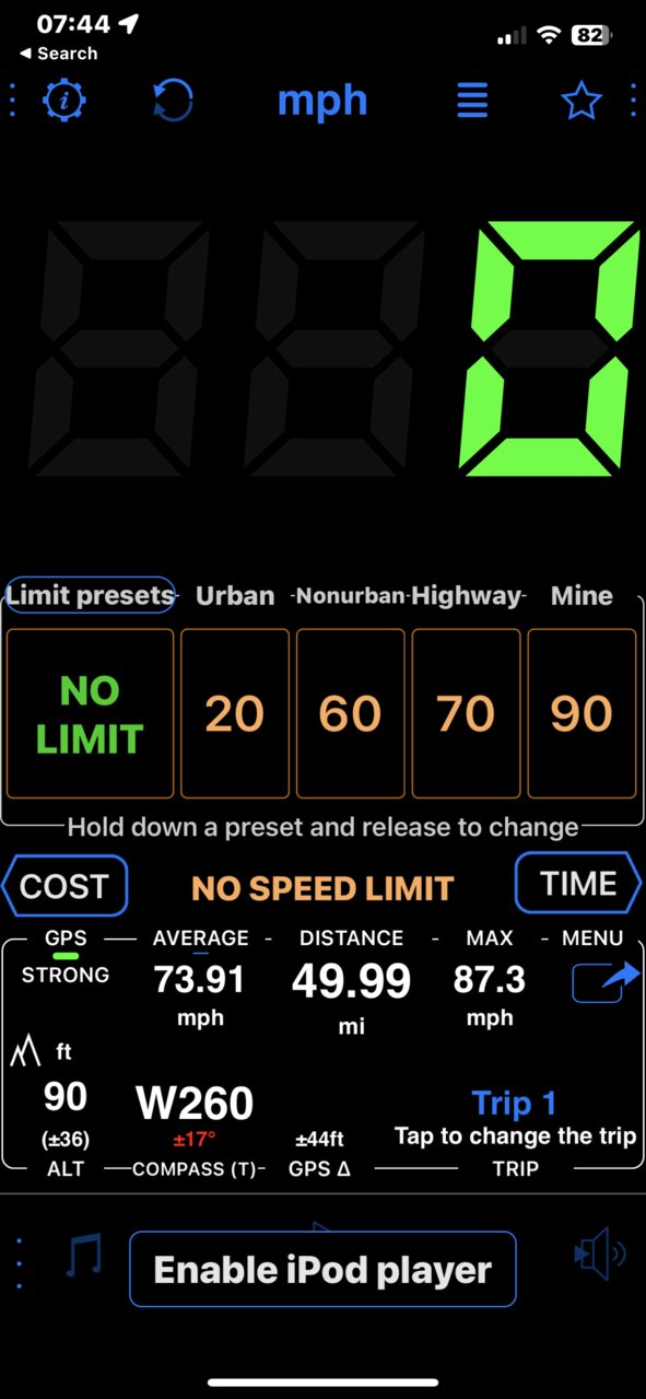

    true I usually end up using my app anyway, my Speedo slightly off and was too lazy to change the worm gear :oops:

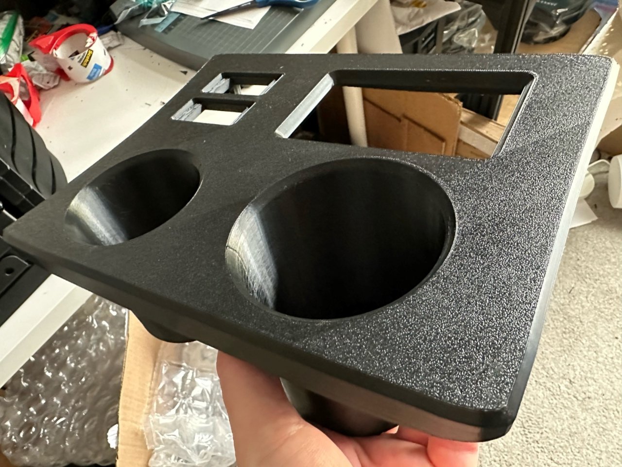

    So this is what the part is going to look like. I will get it in the mail on Wednesday and post pics here.

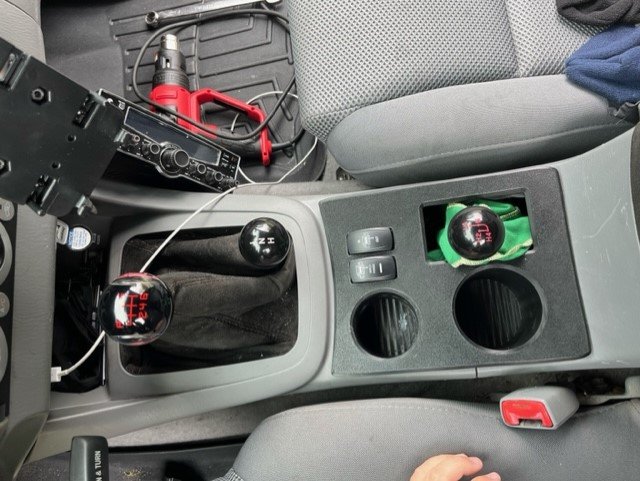

    parts and stuff
    got my 3d printed cupholder from https://bluedogdesignwerks.com/collections/all its a custom piece made and not on his website. He said he would be willing to sell them if people asked. this will work with a crawl box and FJC tcase. I did run into an issue installing it. the outside diameter of the cup holders are a little big and had to trim down the console side to get it to fit. they are bigger underneath to have them reinforced. 5 mins with a Dremel and its fine now.

    #2685
    EatSleepTacos
    Mar 24, 2015
    #151688
    59,846
    Randy
    West Valley, AZ
    2017 4Runner
    That’s super clean.

    yeah. so much better than the hacked up crap I had before

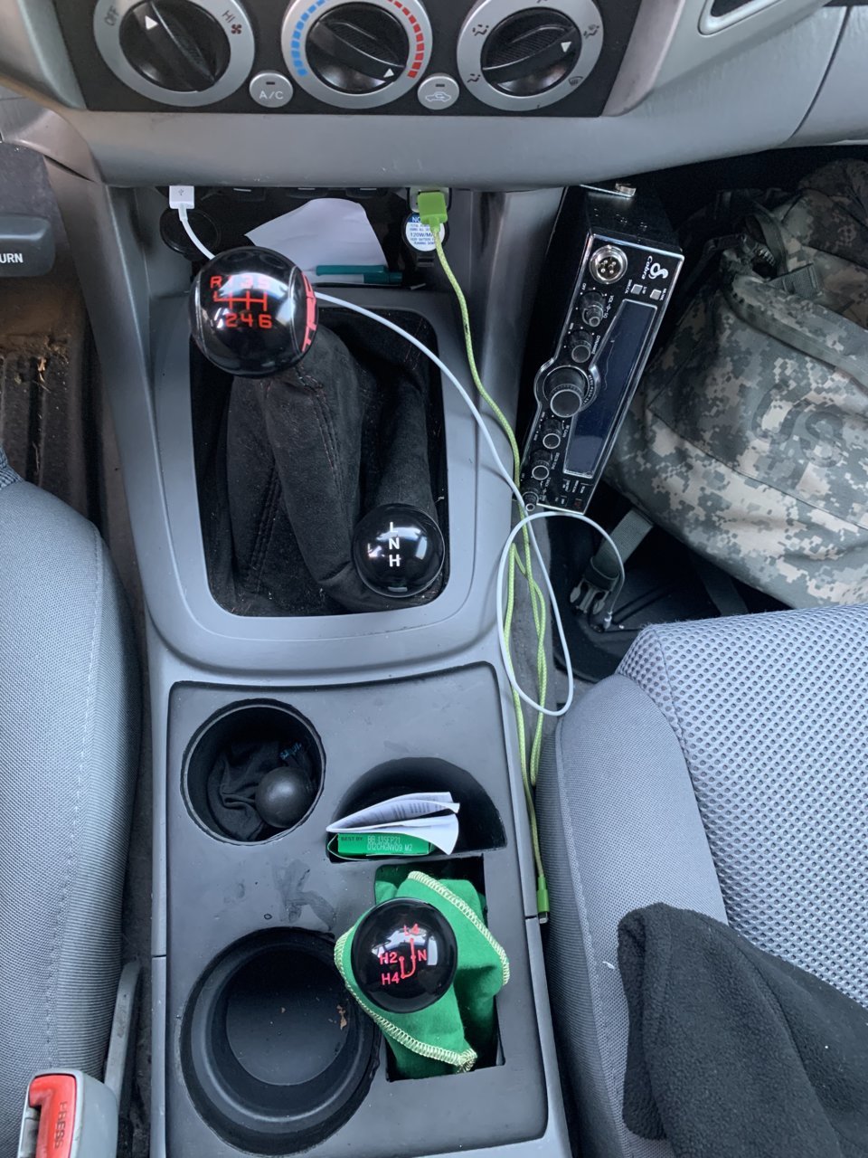

    Hey all,

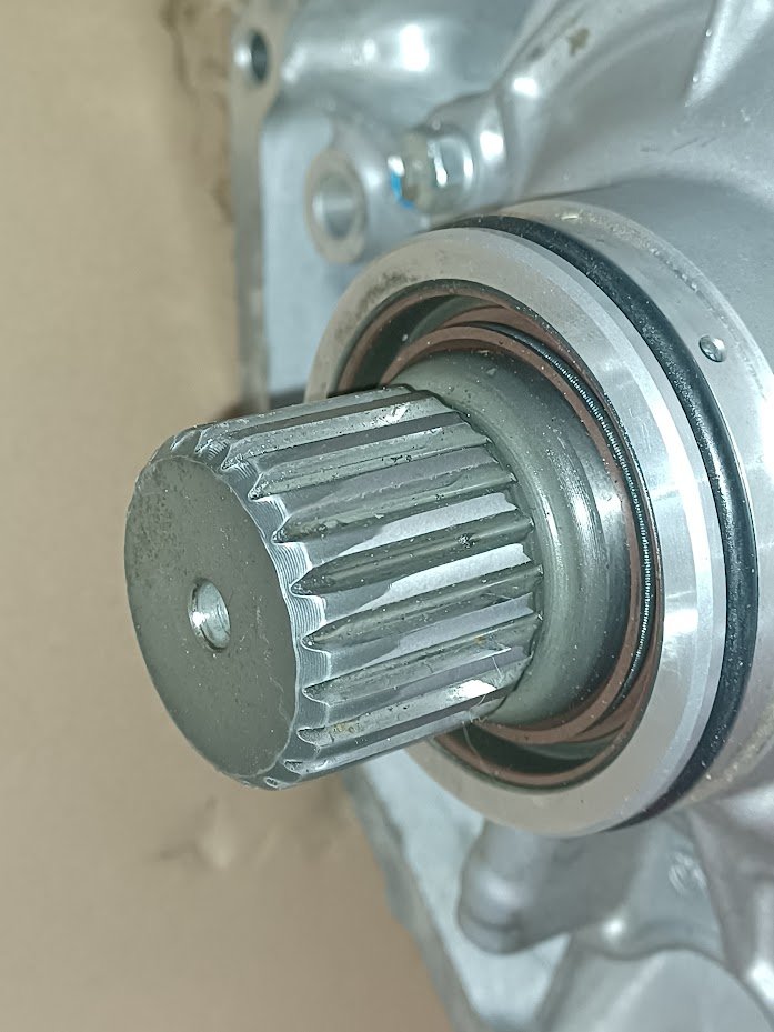

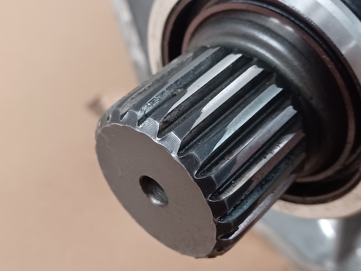

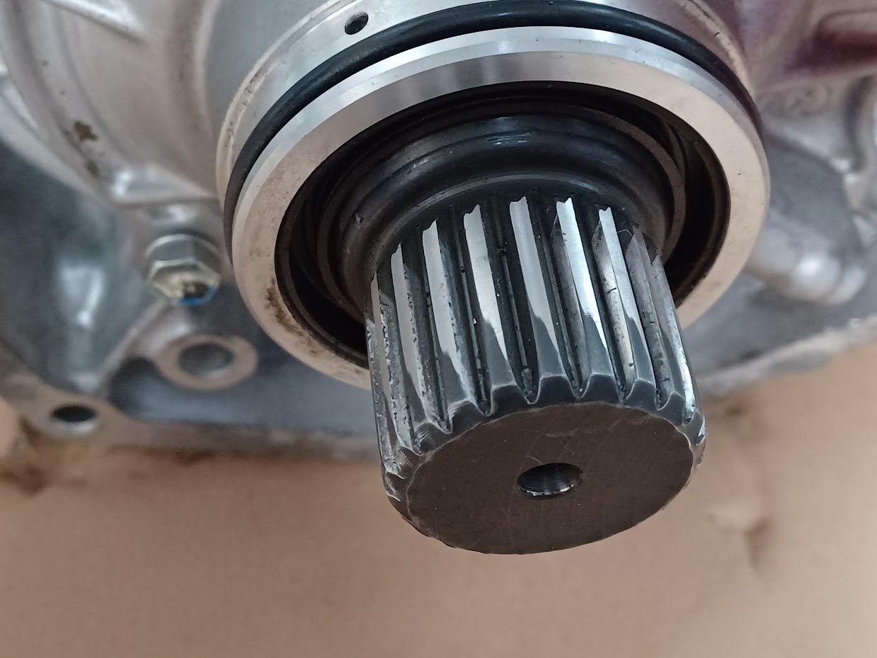

    So...biting off a lot here but doing a RC62f 3rd gen manual trans swap in to my 2014 DCLB. Since I needed to swap t-case input shafts from auto to manual, I figured I'd finally do the FJ/4Runner sticked t-case. Found a low mile 2020 4Runner t-case from a wrecker here in the PNW and also got a 2007 manual splined t-case for $100 so that I could swap input shafts. It says it had 107k on the truck but the input splines seem pretty worn. Notice the rough leading edges on the left side of the pic. Am I being picky or is this something I should be concerned about?

    Mine looked about the same same at 115k in terms of coloration and condition. As long as splines aren't twisted or otherwise chewed up, I would say you are fine.

    I wouldn’t hesitate to run that
