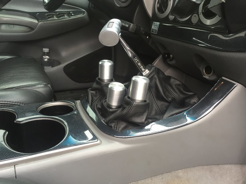

    Going to look like this?

    where did you come up with the carbon fiber overlay pieces? That is as clean as it gets!!

    When I bought the truck back in 2010 I purchased the interior overlay kit from Carid.com I ended up modifying it a bit to work with the alterations.
    This was way before I got into modding the truck for off road/overland use.
    Originally the Tacoma was my DD for work. Once the modding bug really dug in it necessitated purchasing another vehicle for work. :oops:
    first was a scion Tc, then an FRS, and now I DD a turbo BRZ.

    Do you recall if it was this?
    Did you go with the real carbon fiber for +$50 ?
    B&I® - 2D Dash Kit more details on - https://www.carid.com/2006-toyota-t...483543.html?parentsubmodel[]=SUBMODEL|4+Doors

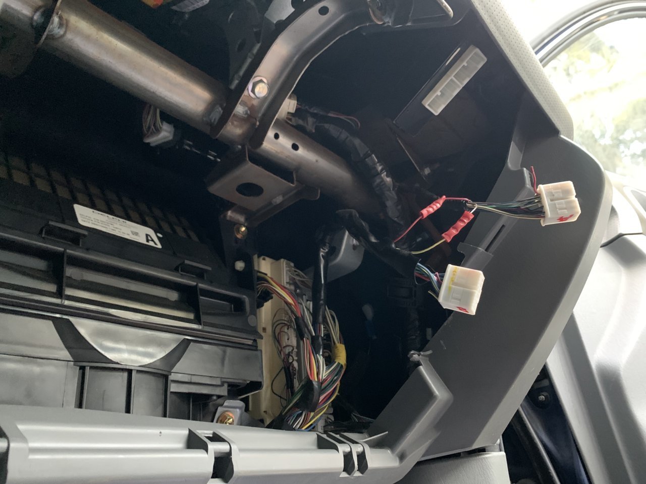

    1). Does anyone know the complementing female connectors to the 4x4 ECU plugs? @6 gearT444E @HomerTaco @EatSleepTacos
    I'd like to make an intermediate pigtail between the two connector plugs for illumination so it's PNP.
    It would be for the two male plugs pictured (that plug in to the 4x4 ECU).

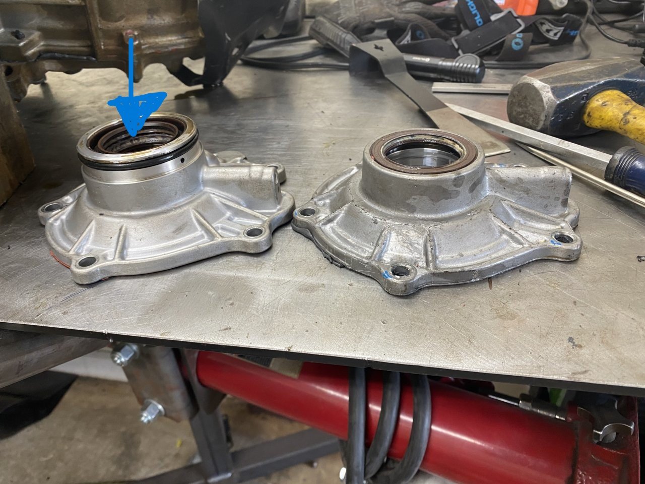

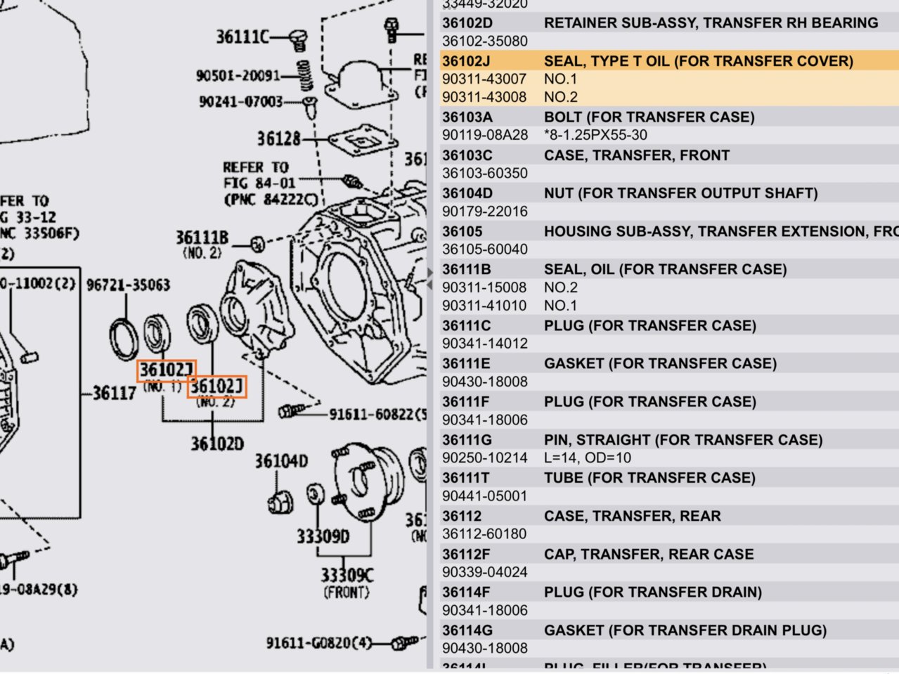

    2). I'm still not 100% sure which parts I'll need to re-seal/re-new the manual trans input shaft housing when I swap to a manual trans input shaft. Anyone know the part numbers to the seal(s) the manual input shaft houseing? Are there two seals there in addition to the o-ring or just one seal?
    PN for o-ring is 96721-35063 but not sure what the actual shaft seal(s) part number(s) is/are?

    Unfortunately there are no female plugs for those, best you can probably do is source the plug with the pins possibly from here (https://www.hi-1000ec.com/), similar to what's one the 2LO module.
    I'd just leave the seals alone unless you find they are degraded. What's wrong with the seal? I've never had my old manual trans electronic case apart to notice the seals, just that there is the o-ring on there. Maybe @EatSleepTacos can comment I know he's had the cases apart in more detail not that long ago I believe.

    Was hoping somebody knew which connector it was without hunting. As you know, Toyota uses several types and can likely be found with some effort. I'll keep hunting.
    Thanks!l so much. I couldn't find any info past the 36102J part

    This is awesome. Thank you!!

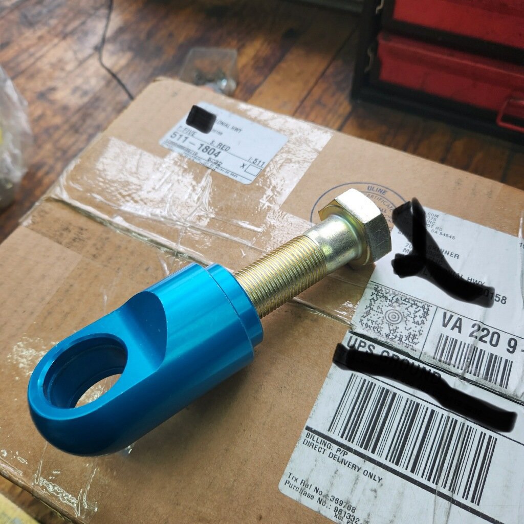

    If anyone wants to know or cares.. King 2.5 rod end thread pitch is 0.875"x14, and the FJC shifter is 12x1.25
    My friend is making me a shift knob adapter with his lathe
