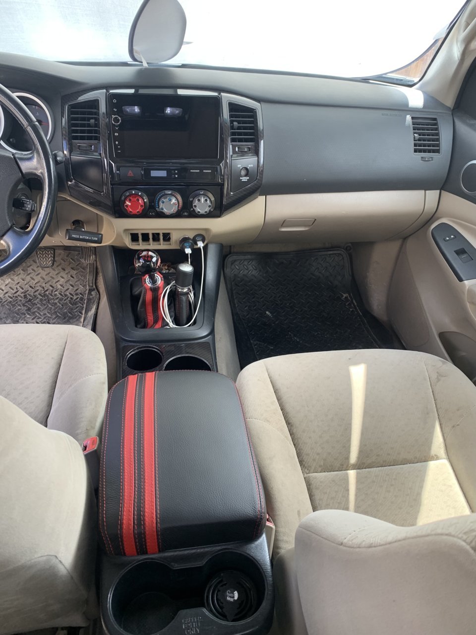

    offroadtoyboy
    offroadtoyboy Well-Known Member
    Jun 22, 2012
    #81130
    171
    Middle of nowhere Cali
    2006 Pre-Runner / converted to full manual 4WD / RC62 swap / Manual 4R trasfer case mod
    Got it finally.

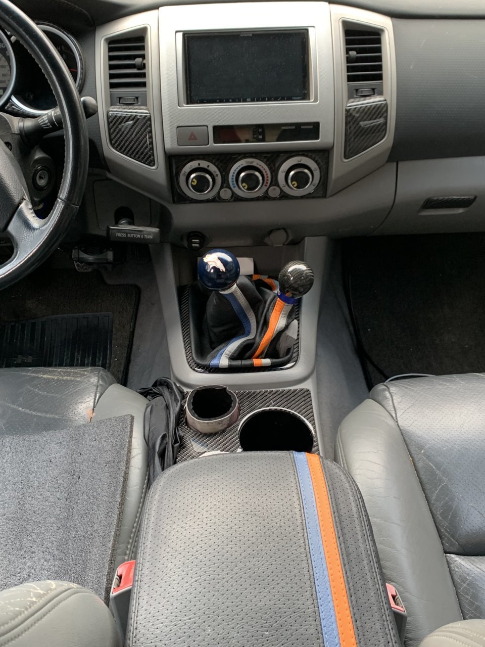

    dborrer
    dborrer Well-Known Member
    Apr 28, 2018
    #251944
    550
    Mr. Dan
    St. Augustine, FL
    2006 Tacoma TRD Sport 4x MT
    2018 new Frame (thank you Rust!), FJ T-case swap. SPC(LR) UCAs, Bilstein 5100s front - rear, OME 883 at 0, HeadStrongOffRoad 3 leaf progressive AAL, MESO custom 2nd gen (Red/White) LED dome & Ultimate Maps, Spyder Halo Projector w LEDs (which SUCK), Spyder LED tails
    Some may think the leather boot is over rated, and no disrespect for a great purple bag as an alternative, but for me too at least, a Redline leather boot was icing on the cake for this mod....
  19. Jul 18, 2023 at 4:38 PM
    #2739
    JAGCanada
    JAGCanada Well-Known Member
    Oct 25, 2011
    #65834
    595
    Canada
    2010 TRD Sport V6 Auto Double Cab MGM
    Looks really sharp!

  20. Jul 19, 2023 at 6:22 AM
    #2740
    DesertRatliff
    DesertRatliff Well-Known Member
    Jan 14, 2012
    #70618
    2,493
    Mt. Hood, OR
    Mas Tacos Por Favor
    Looks really nice. Do you just call or send Redline an email to place a custom order like this?
