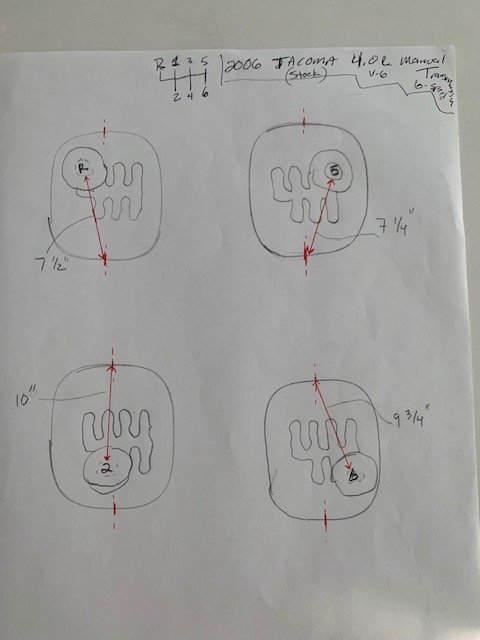

    You'll probably have to communicate through email to give them measurements. they straight up refused to speak with me on the phone when I asked them to call me. If you're doing a boot for twin or triple sticks, I can share some base measurements so they don't f up yours like they did mine.

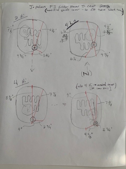

    This is definitely a customer email order thing!!
    I ordered mine as it turns out at the beginning of the Russian invasion; had several mis-understandings with making the measurements for them, then the first one might even have been lost and they actually had to make a new one and ship it, but did eventually get to me, shipped via DHL straight from Poland, where it was made...
    I think the attached, is what I ended up using. I trimmed Nothing on my plastic console area. I did cut out the metal wire from the OEM boot to put into the Redline boot, it doesn't come with that, nor top plastic thing like OEM, but that is just fine.

    Also need to take into consideration the throw at the base of the console, not just the top of the shifter.

    If one choses to buy from Redline, they provide very specific instructions how to measure....

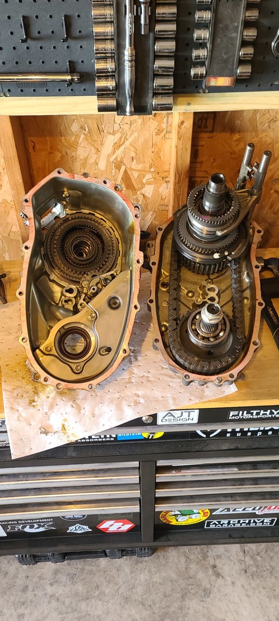

    Started my swap yesterday. Opened up the fj case for twin sticks, to swap shafts, planetary gear sets, and ring gear. Dropped my stock case. Hoping to get everything swapped over this morning and have the fj case mated to my trans by noon so I can get some sleep before work tonight.
