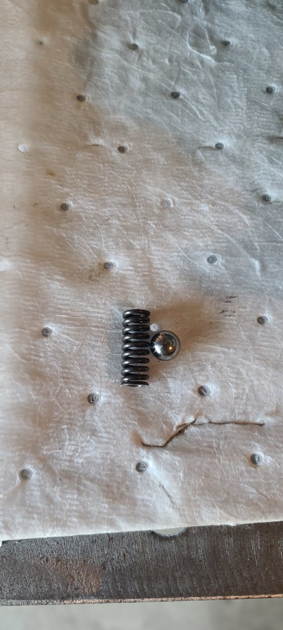

    Question for the folks that twin sticked their fj case. Does this spring and ball go back under the plug after removing the "pill"

    Yes

    Yep thanks realized that after moving the lo/n/hi side and how free it was sliding back and foward lol. She's all good now

    on my Lo-n-Hi shifter, i had to get marlins spring to keep it in gear. otherwise it was popping into neutral. the sprring just goes inside the stock spring.
    i didnt figure this out until i went wheeling and it popped out of gear going down hill :eek:o_O

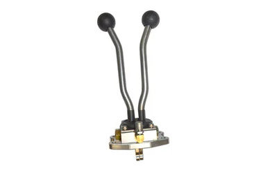

    Pretty much seeing only one twin stick on the market. Front range off road.
    Is that the best one?
    Do they work with 6-speed manual stock shifter?

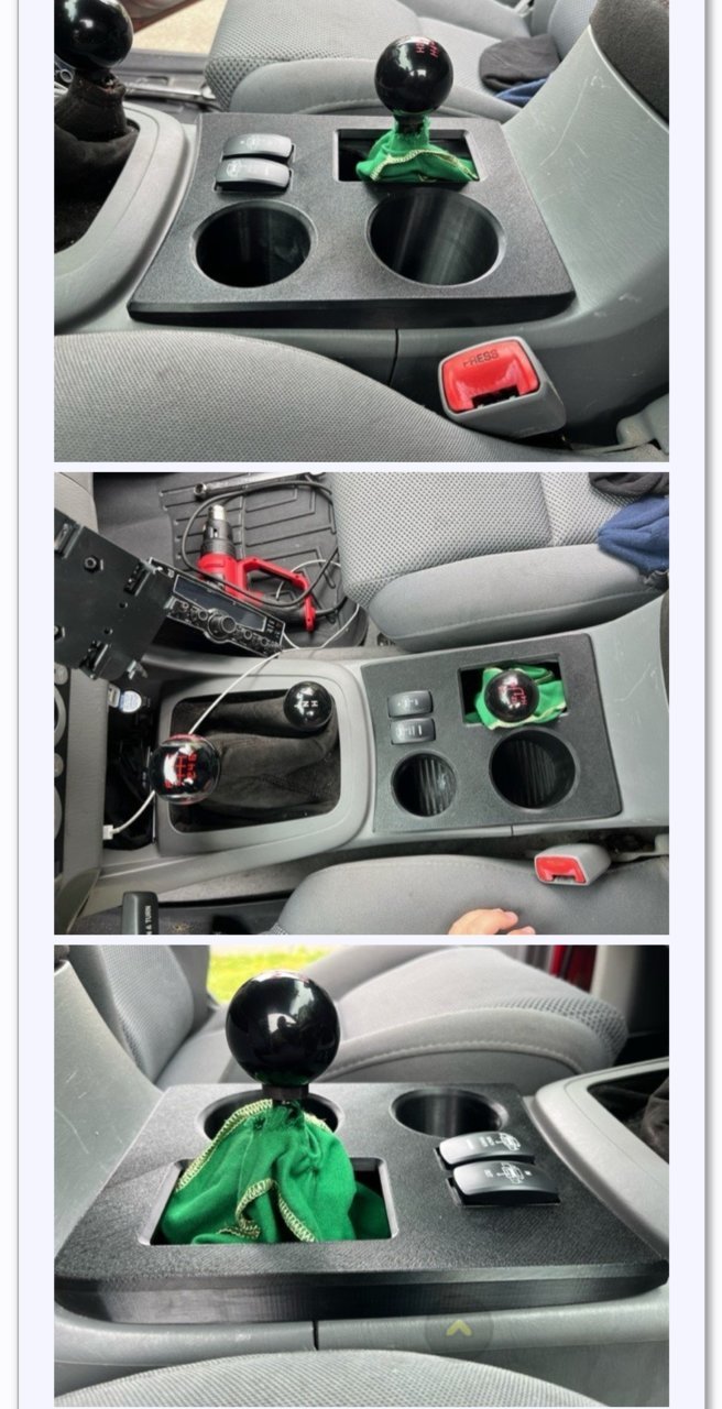

    long story short am hoping it won’t turn into 3 shifters too close together smacking into each other, unable to shift gears in the manual transIMG_6095.jpg

    Those are the sticks I ordered. From what I've gathered it's not a 1 stick fits all aplication and you'll need to cut, bend, weld, etc... the sticks to your liking and fitment. As for the hole....I just took rough measurements back from my trans shifter and just cut a hole where I thought the center of the tcase shifter would be. I ordered a custom 3d printed center console area (cup holder area) from a company that was mentioned somewhere earlier in this thread. I didn't want to have 3 sticks bundled up in the stock trans shifter location. I ordered this with a few changes thanks to @wrmathis
    I'm basically having mine made without the switch cut outs and a slightly larger shifter opening since I'm having both sticks in that location.

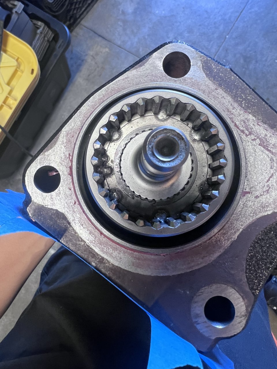

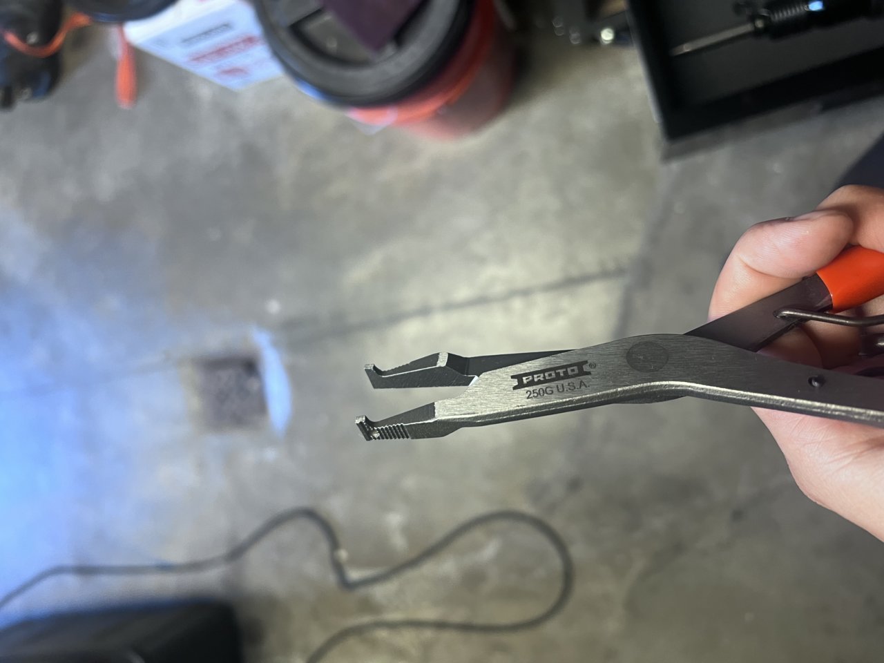

    made a little progress with the add delete. Now I need to make a block off plate. The retaining ring here needed a special tool since none of my 10 snap ring pliers worked. A smaller one pictures would be ideal for this job. It removed it fine but with the sleeve welded to the hub, the reassembly got tight with these. E433FCD0-4989-42F7-BDA9-E0DC4E8BA93C.jpg59D7C793-F924-4163-A889-1627326DF5AF.jpg
