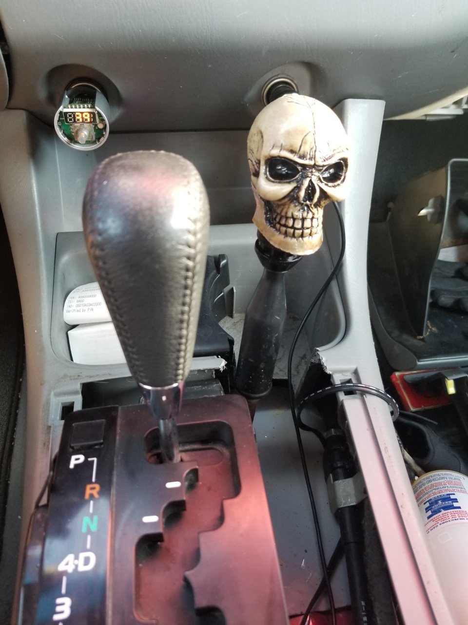

    I’d like to see some pics of the stock fj shifter coming through the console as I want to use single shifter

    Manual or auto?
  12. Oct 8, 2018 at 1:06 PM
    #272
    Jamie_logan2
    Jamie_logan2 Member
    Jul 5, 2018
    #258378
    14
    Jamie
    Tacoma
    Auto
    Thanks
