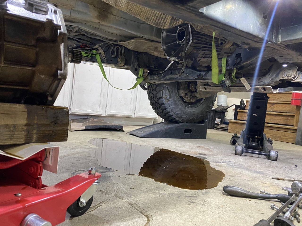

    Unfortunately my case is coming back down lol fml. Didn't realize I had to swap the snout over from my stock case. Didn't even notice the o-ring.

    Can someone tell me the part number for the input shaft oil seal ? Mine needs to be replaced. Its leaking.

    I didn’t realize that until I went on a test drive. Dropped the case to see wtf was up and had a bunch of trans oil come out.

    In case anyone else is concerned because they don’t know wtf we’re talking about, it’s only when putting a case behind a manual trans.

    I found this out from your exact post lol. I was scrolling through the thread looking at what different people came up with for their shifters and then I saw that post and instantly a light bulb turned on in my head and I went "fuuuuuuuuuck" lol.

    Definitely glad I'm not cleaning up oil on my garage floor. I am getting good at dropping this case though :rofl:
