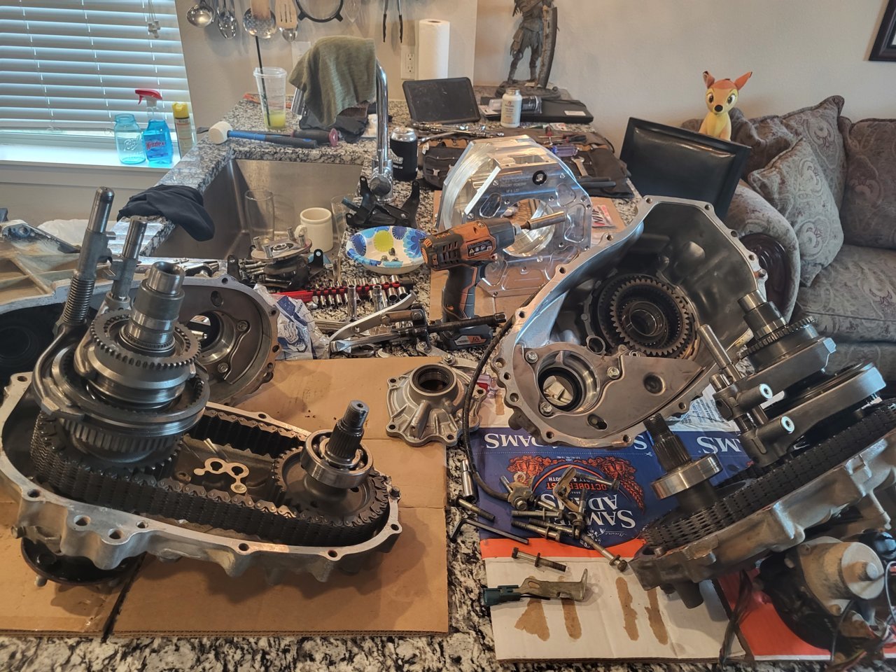

    Good catch! That's what I get for chatting with the neighbor while doing it. I was wondering how y'all got em out. Lol

    @gtrotter07 it should look like the case on the left when separated.

    I gotcha. Bonehead move on my part. Also, how do you get away with doing that on the kitchen counter?

    Lol. You can get away with a lot when you don't live with your girlfriend. That shit doesn't fly anymore.

    Is that Yhorm the Giant helping you?

    Yep, thats Yhorm, my supervisor and Bambi, head of quality control.

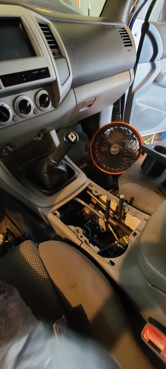

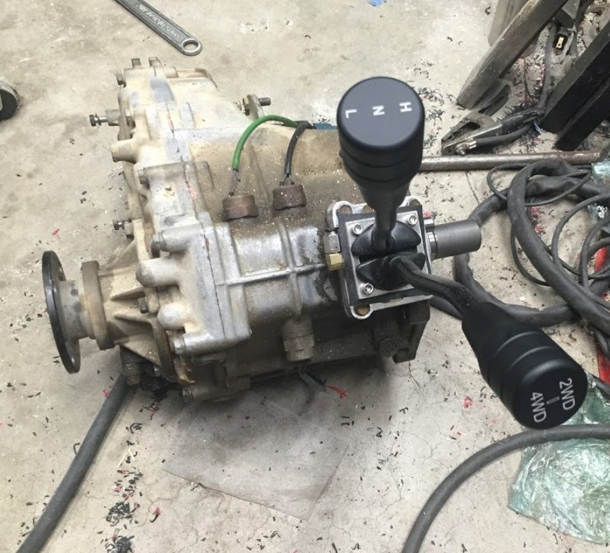

    Got some progress done on the truck today. Got the sticks pretty much where I want em.
    I just need to seal the floor and weld the threaded tips on for knobs. Oh, and of course I had to delete the 4x4 switch

    https://core-shifters.com/collectio...wler-toyota-twin-stick?variant=39635228688502
    I’m not sure what the thread pitch on the front range sticks are, but these might work

    No problem, not 100% sure they're a direct fit though. That's just what I was gonna go with.
    Edit: Just got confirmation the advanced adapter knobs screw right on.

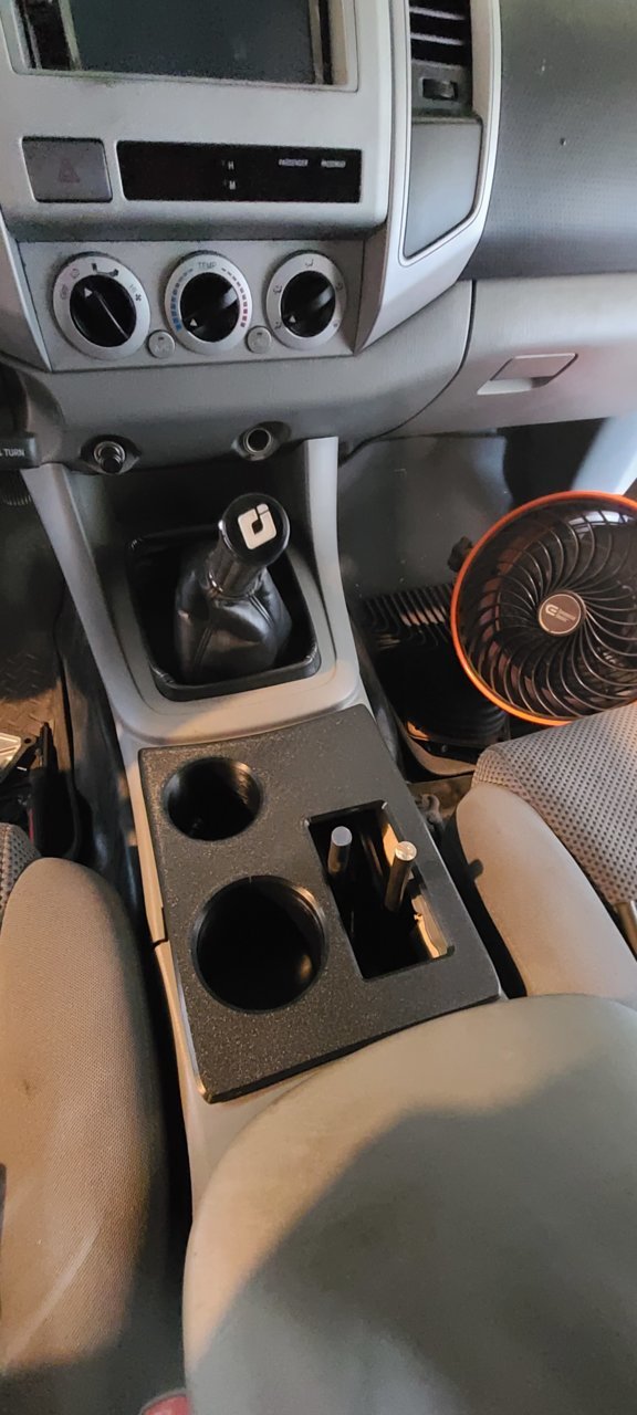

    that cup holder from blue dog designs?

    Sure is
