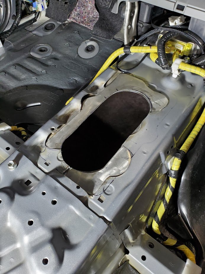

    Nice
    it’s so much easier to deal with than trying to hack up the stock one.

    Oh absolutely. I was charged $100. Would gladly do it again to keep the clean look

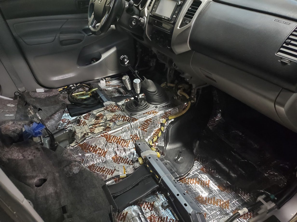

    Waiting on my advance adapter knobs and some parts to seal the floor, but she's pretty much wrapped up

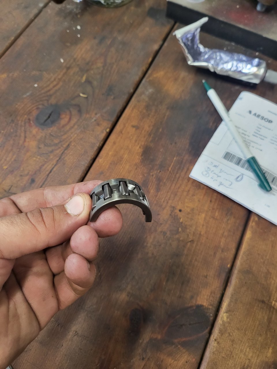

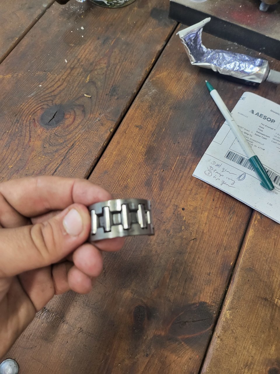

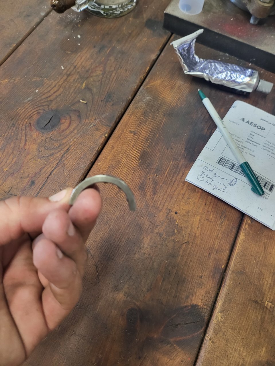

    Anyone have a clue where.this little fella goes? Split the case, and just fell out. Note I didn't lose the keys lol

    Those sit on the inside of the Planetary assembly. See from my thread where I pulled them with the magnet. Easiest way to get them in is slap some grease on them and drop them in before you slide the two halves of the case together. Grease should hold them in place. Hope that makes sense?
    https://www.tacomaworld.com/threads...l-and-b-s-thread.356319/page-23#post-21537934
    BassAckwards likes this.

    Seems to make sense. I think I can get em in there, I was just baffled where it even came from. I was more worried about those little keys everyone talks about.

    Yeah, pray they don't. They suck to get back in.

    Mine fell out and that shit had me so heated. I fought them for 20 minutes and had to walk away to cool down. Came back and they fell right into place. :rolleyes:

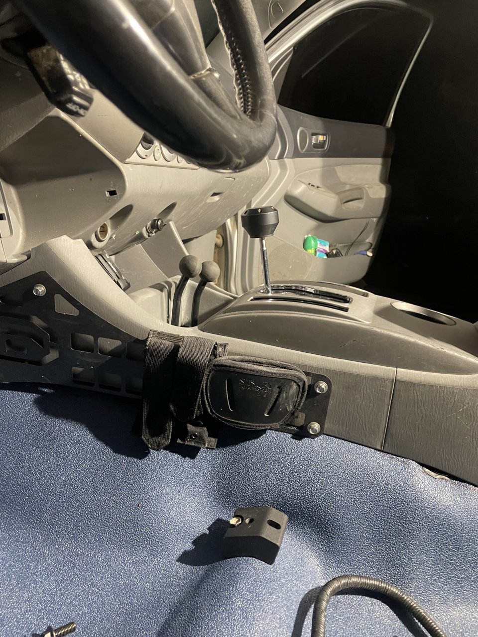

    Neat swap! What made you wanna go with the hand brake?

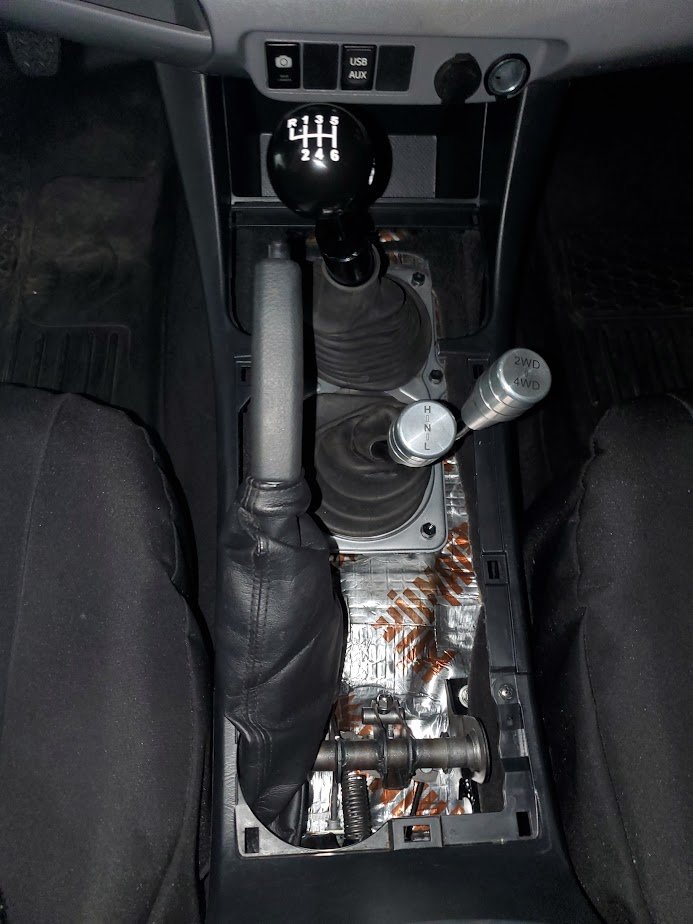

    As for the handbrake, I don't mind the old Toyota hand brake location (kinda nostalgic for me, actually) but the auto trans cabs don't have the studs for the OEM 2nd gen handbrake assembly and because of that, crawling under the dash to locate, fabb and install a homemade bracket sounded like a big pain (some claiming it was the absolute worst part of their swap). After pulling the center console top bezel and seeing the brake cables right there, it made sense to me to figure out a handbrake option at the center console like the 3rd gens have. I'd still be fabbing brackets but at least I wouldn't be crawling under the dash again to do it.

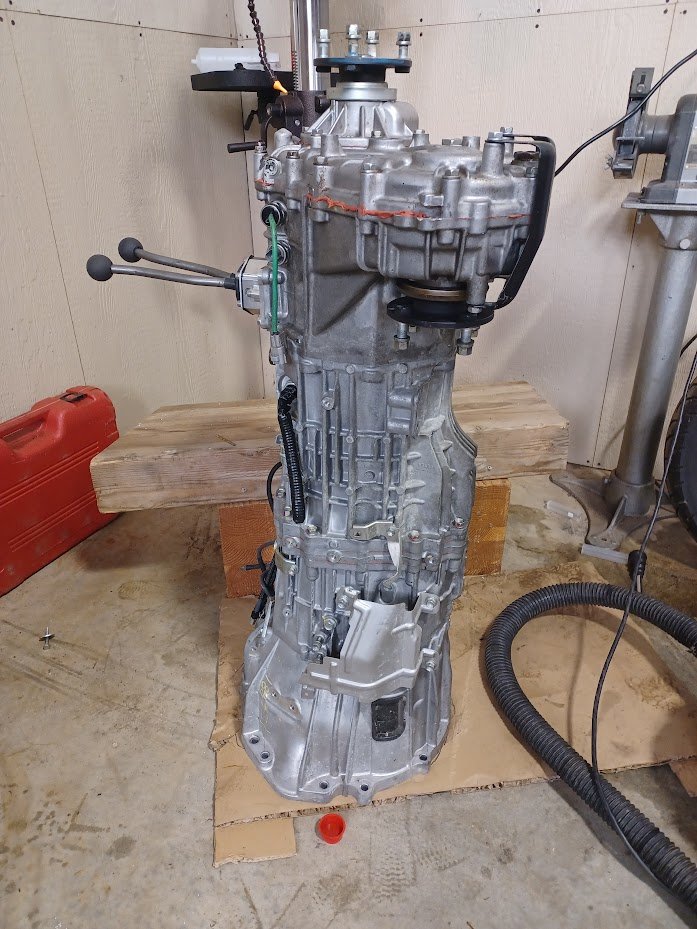

    Just bumping this thread looking for leather-style twin stick shifter boots to trim out my Front Range Twin sticks.
    I know Redline will make custom boots and I found these guys who make twin stick boots for NP205 twin stick cases but really nothing else:
    81-93 Dodge Transfer-Case Boot Twin-Stick | strongholdshiftboots
    Can you guys recommend anything else?
