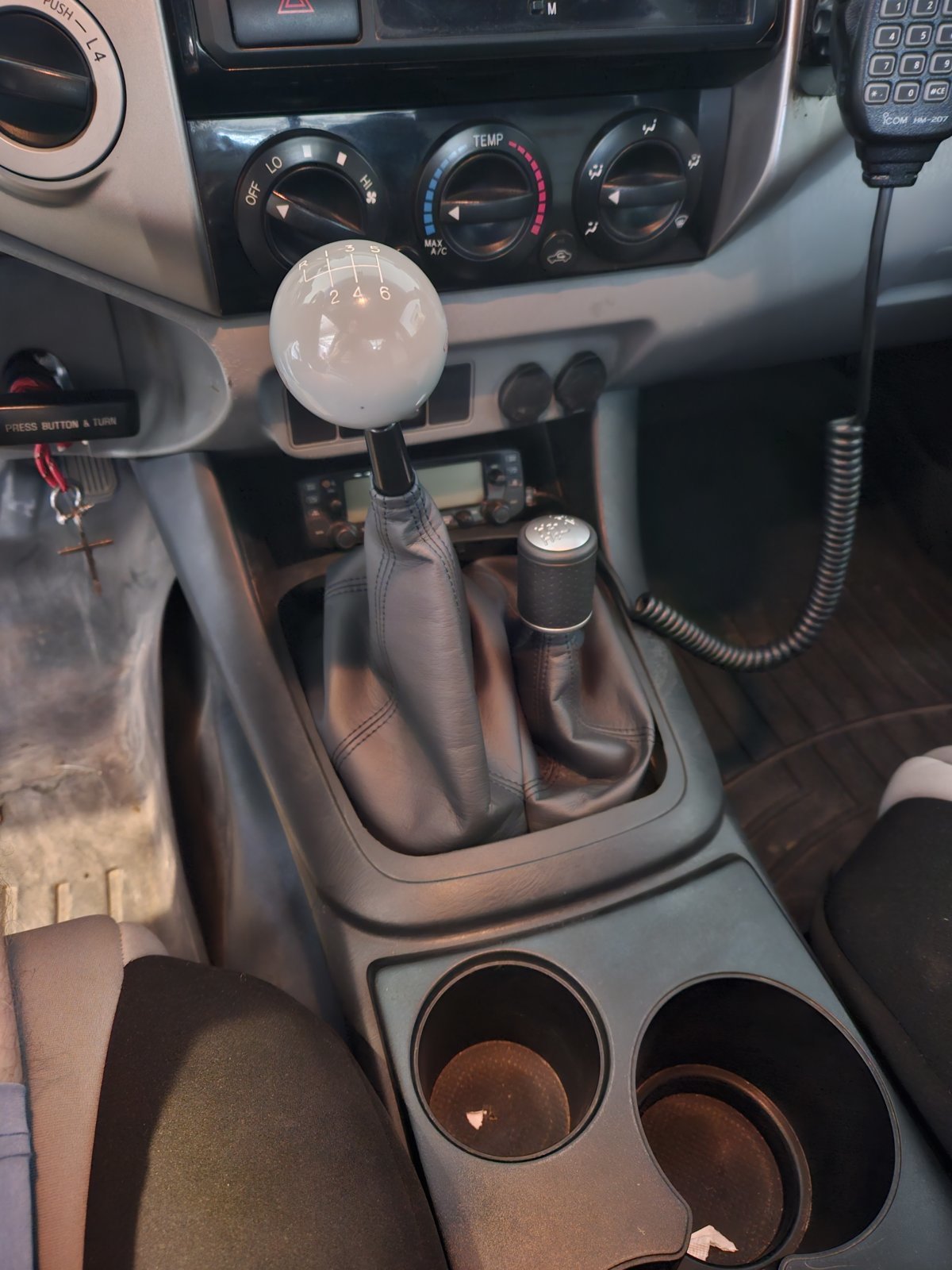

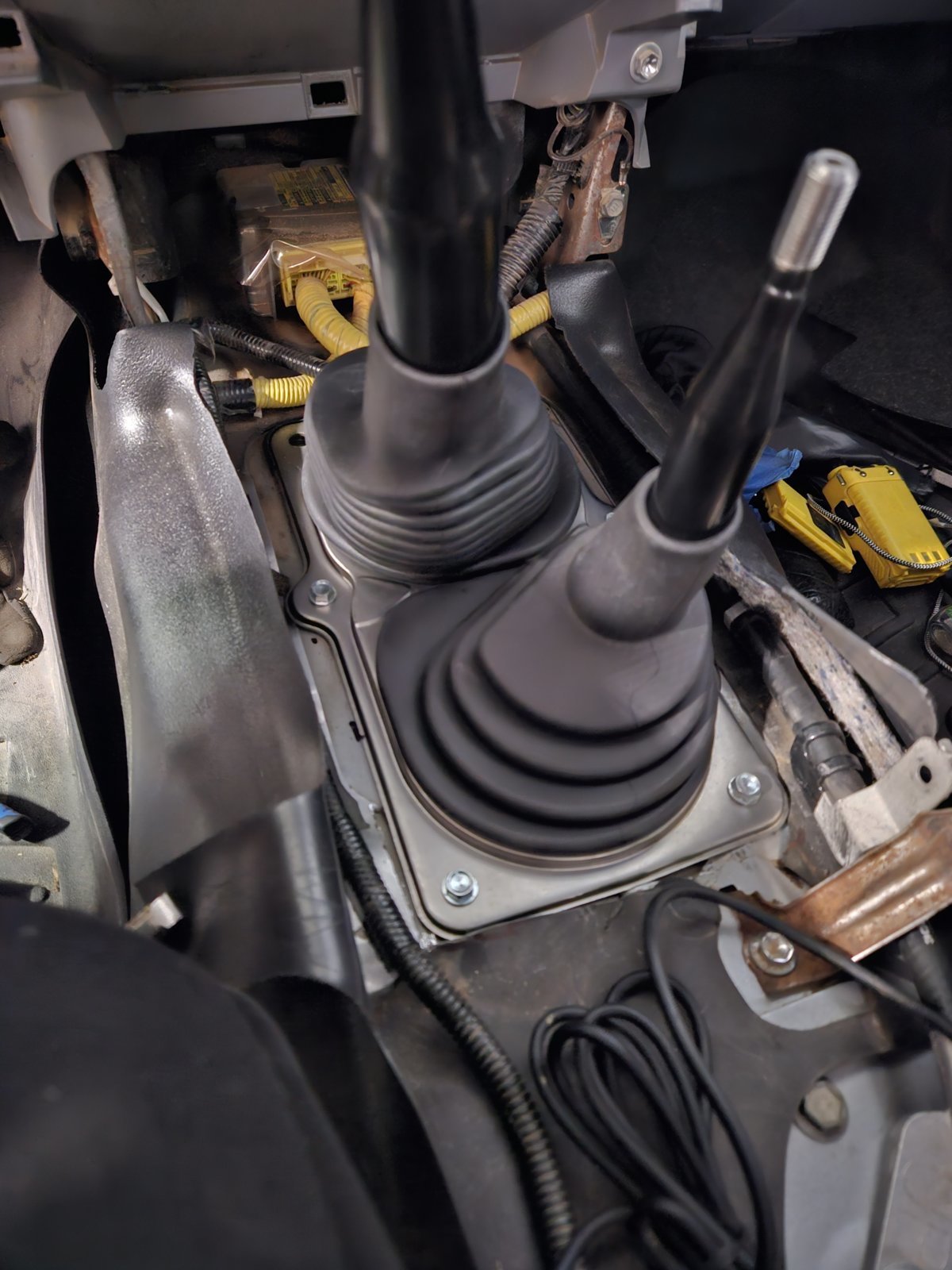

    Need a way to secure the boot

    cant take the wire out of the stock boot to put in new boot?

    I ended up enlarging the opening so I lost the snap in points for the wire. It's a good thought though. I think the boot would have been pretty scrunched up if i did that.

    i used the wire in mine. but the second shifter for mine is for a crawl box. it just moves up and down and has no side to side like the FJ tcase so i didnt have to open mine up and was able to reuse the wire. mines not really scrunched up tho.

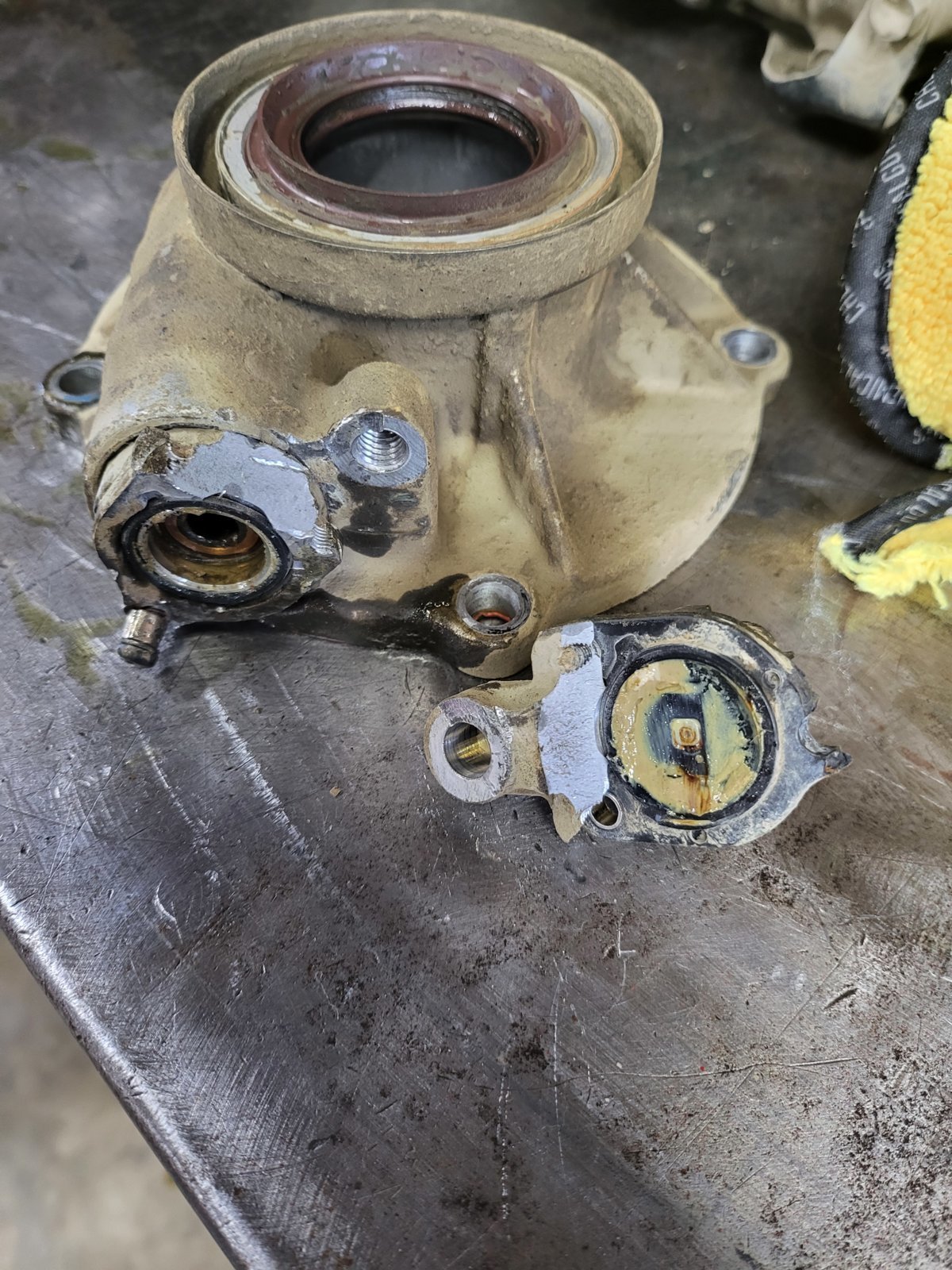

    My truck has the sensor on the case. I was a little um, ham fisted taking the sensor off. Is there a specific sensor I can order to attach to the fj case? It looks like it has a provision for a sensor? Orrrr am I stuck ordering another rear output cover for my truck and swapping it on? I currently have 4.88 gears and 37's, so it may be a good opportunity to get a more "correct" speedo gear anyway. I'm about 6" off at highway speeds.
    EDIT: my impatient, hamfisted results

    for the tcase sensors, you will replace 2 of the 3 with the 2 from the stock tcase. one left one right. dunno which ones are which tho. leave the 3rd one on the fj case where it is tho. it keeps oil from spewing out

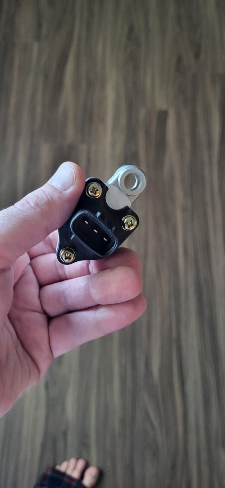

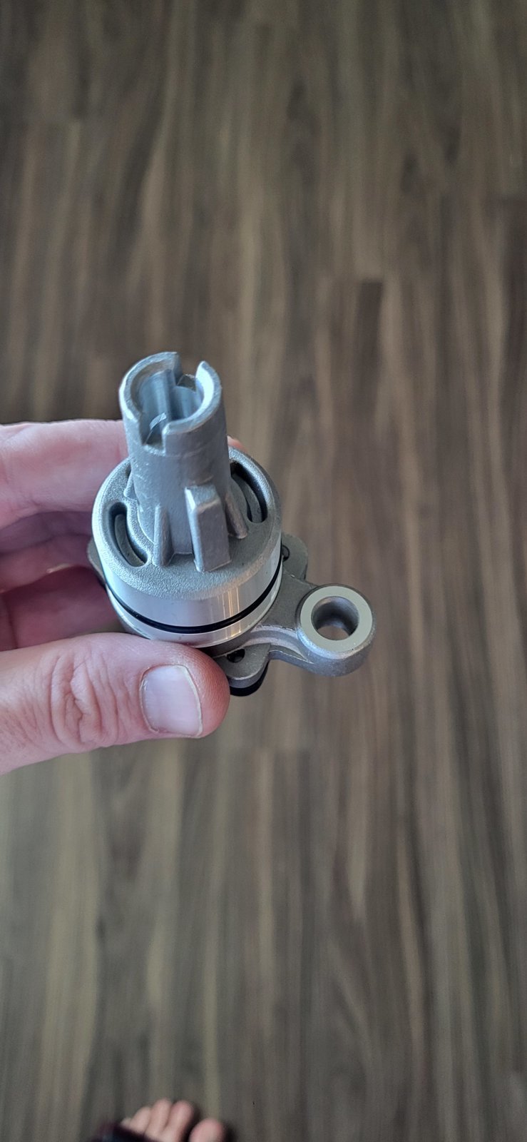

    The speed sensor does not come with a gear. Or at least mine didnt. You need to swap over the gear from your broken one. If i still have it, I think there's a brand new 5 year old AC Delco sensor laying around my garage I can send you. I thought mine was bad so I bought a new one but it turned out to be a bad harness. I'll check when I get home tonight.

    I lied its beck / arnley but at least I remembered the box was blue. I installed this briefly but when my speedo wasn't fixed by the new sensor, I traced my issue to the harness and put the original sensor back in. I'll give you a good deal on it if your interested.

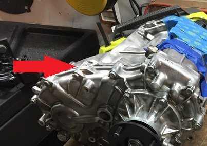

    Question for those of you who have pulled the back of the TCase off, I have a leak on that back end on my transfer case. Can I pull the back end off with it still mounted to the truck, or do I need to drop it? any other tips or things I need to know?
    Here is where the leak is:

    I think you need to pull the entire case. Pulling the case isn't too hard. Lots of videos / tips available on how to do it.

    Yeah that's no problem, I have swapped transmissions and transfer cases before. I was just hoping to pop the back off and reseal it lol. I have a couple spare cases so I can just swap it and work on it on my bench.

    There was a dude on here recently that pulled the rear half of the case with it still in the truck. Not the way I would do it, but to each their own.
