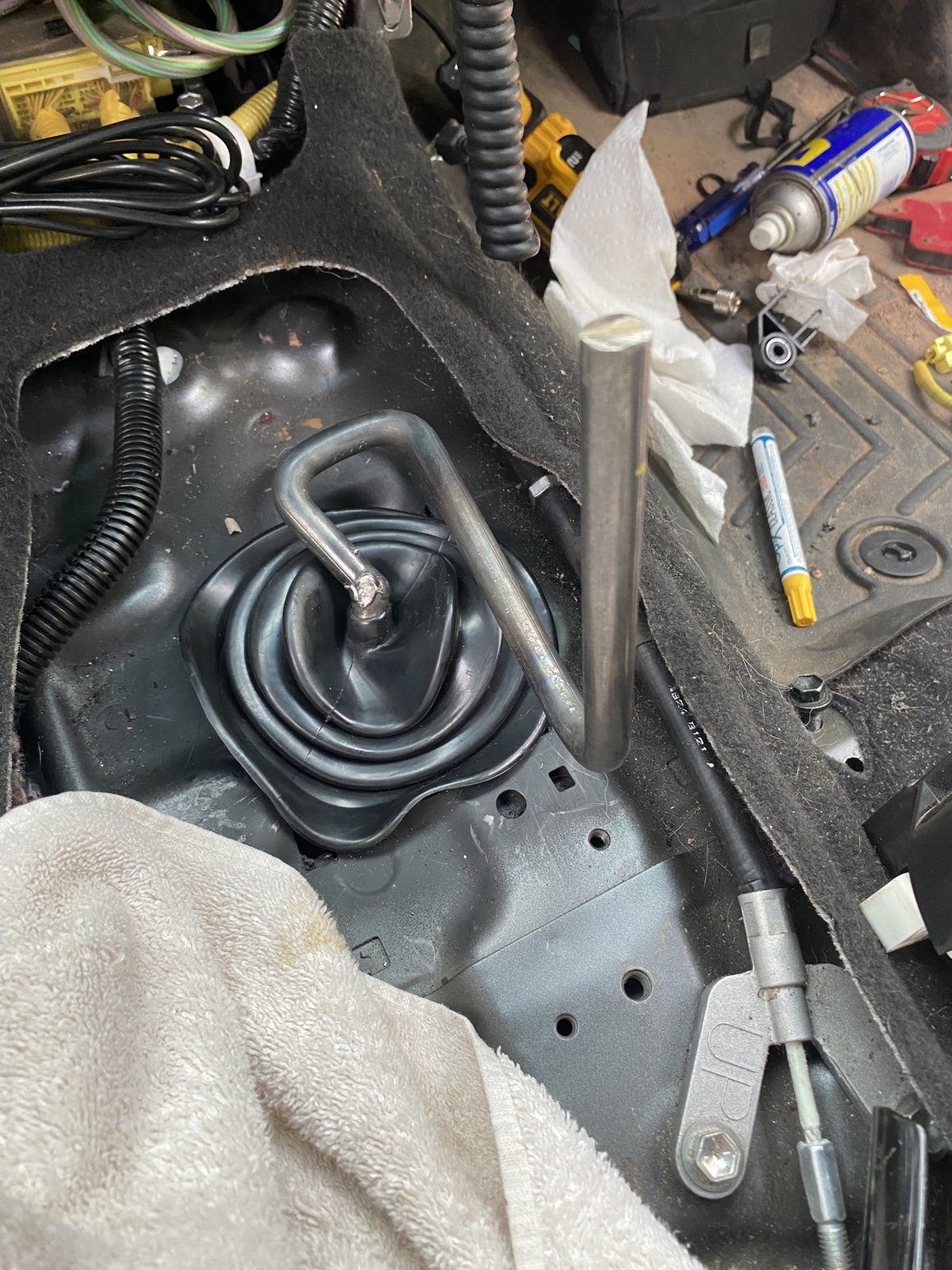

    So here is mine. Lever bounces a lot over big bumps. Hasn’t popped out of gear but wonder if it will. Any suggestions for how to improve this? Should I cut off the OE FJ vibration damper and just cut threads on the rod closer to the center console opening? Or add some weight to the bent rod closer to the transfer case? I like the position but worry it may pop out of gear or cause some kind of wear bouncing around..
    first pic was a test fit, ended up cutting it down a bit as the ‘u’ towards the front was too far forward and would pop out my cup holder lol..

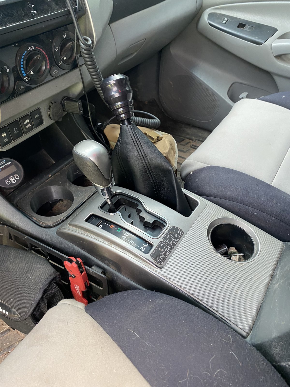

    Forgive my finished product, I "tried" to pretty it up as best I could, and make sure I kept the heat out. I do prefer the manual shifting that the FJ TC provides.

    My stick looks similar to that only shorter and bounces pretty good with only a golf ball for a knob (yeah, puns intended). It's never popped out of gear.

    Appreciate that. Just got back from a 6000 mile trip and no issues, but I do wonder if there is some wear and tear from the bouncing..
