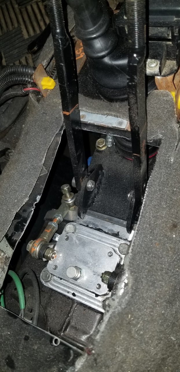

    Looks like the two main options for a twin stick are Front Range and Dave'z. Anyone care to share their experience with either one? The cost is about the same.
    The one from Front Range looks very strong and maybe rebuildable, or at least take apartable:

    The boot tore on my FROR sticks while I was on vacation, 6 hours from home, and leaked horribly. Had to stop and check my fluid level periodically. I wish I had just used the factory single shifter, twin sticks just weren’t worth it for me.

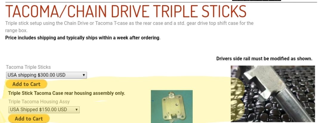

    I didn't see anything on Marlin Crawler's site either.
    The Rad ones look nice but I only saw triples for the chain drive case.
    I'm honestly liking the sealed-upness of the Dave'z shifter.

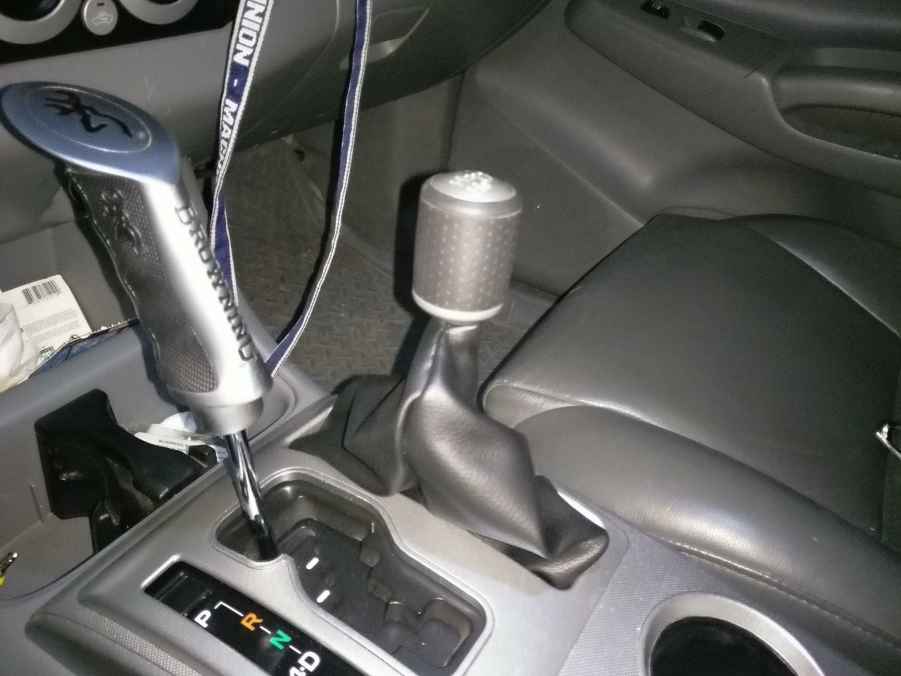

    Honestly, I wouldn’t have gone twin sticks if I had thought about it more. With the crawl box, I have 2wd low. So having twin sticks is kinda pointless

    x2, and even if RAD won't make the twinstick, it wouldnt be to tough at all to weld some shifter handles. The FROR twinstick is nice, just removed it to replace with a RAD setup for a crawlbox otherwise I'd still be running it. Didnt have any issues with the boot either.
    You can see where the 2 rod ends are and how they bolt to the individual shift rails. So instead of bolting you could easily weld some 1/2" rod and have a twinstick setup. Plus, I think RAD does sell the chain drive bases separately instead of having to buy the whole kit.
    Just checked, yup they do.
