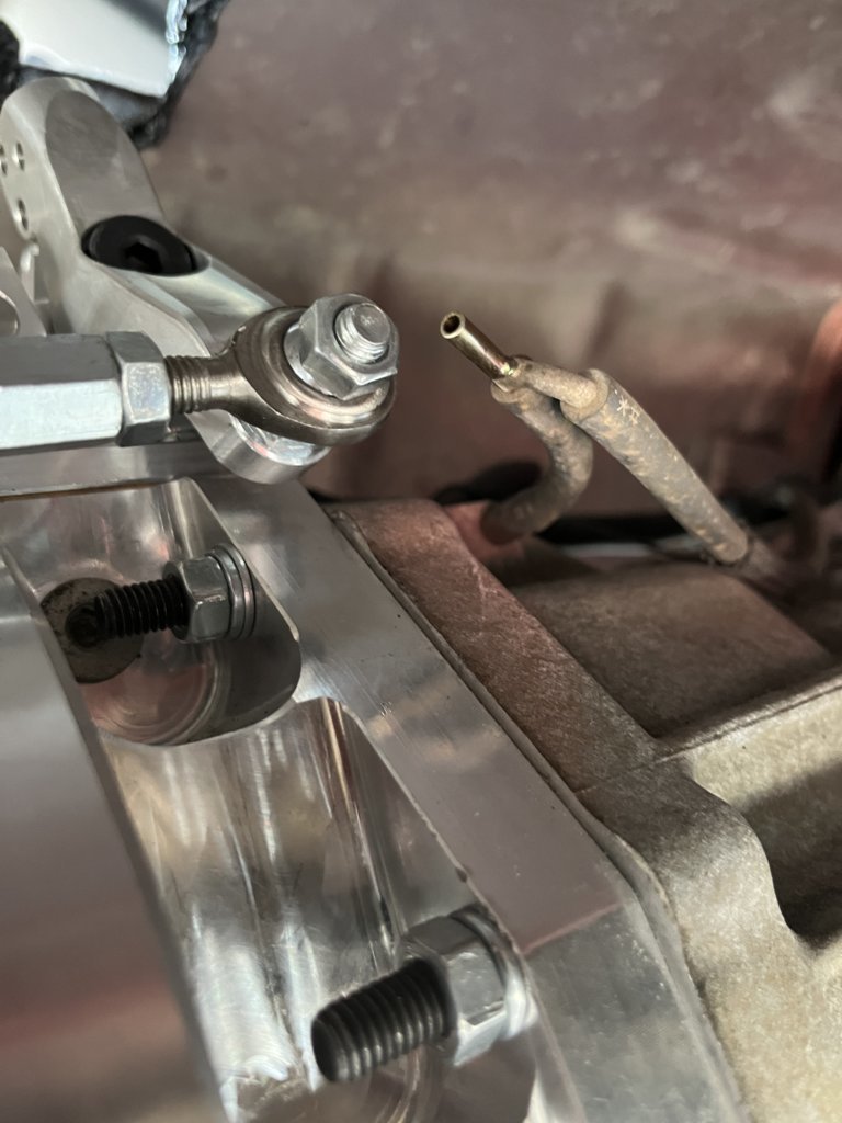

    Using a trident shifter so there’s no port to plug these breather hoses into from the trans into the t case or t case shifter. Suggestions on what to do with them?
    Ricardo13x likes this.

    #2994
    Ricardo13x
    Ricardo13x YT: @UrbanOpsOffRoad IG: @urban.ops.offroad
    Feb 9, 2020
    #318785
    2,922
    Upland, CA.
    05 OR DCSB ProRunner(4x4 conv.), Chevy 63”s, NWF EcoCrawler, 35”s
    Random stuff. Oh! and converted to non ADD 4x4.
    Add a line and secure by the windshield washer hoses.

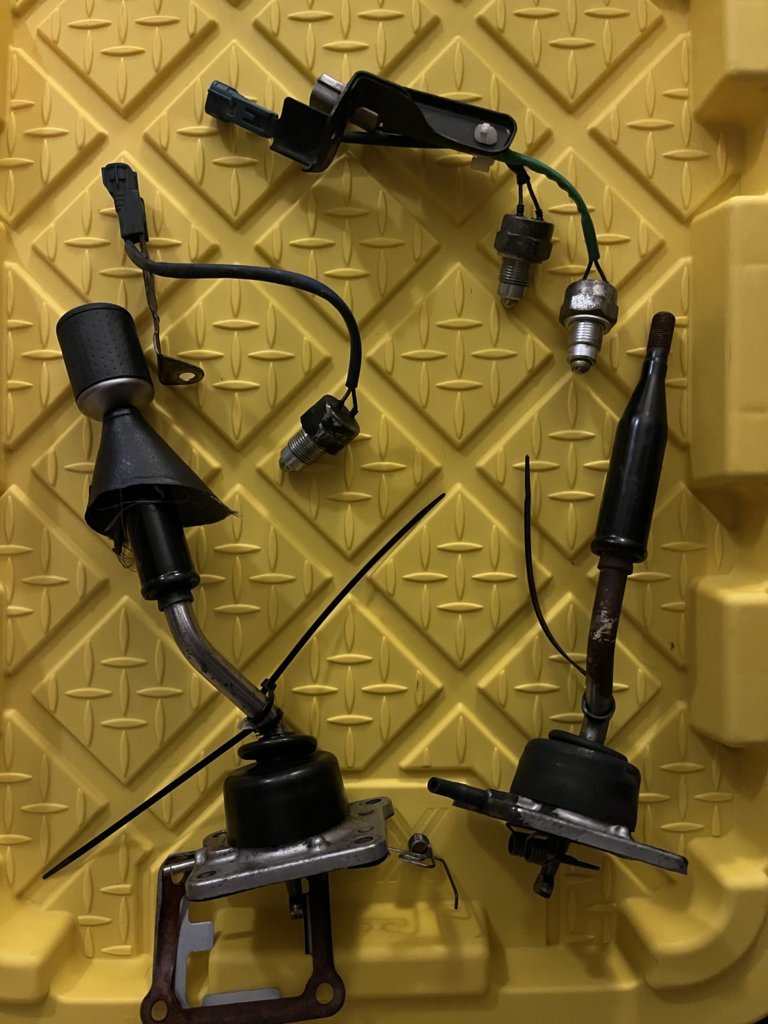

    BTW anybody need an fj shifter, sensor, or other misc parts? Let’s make your life better and my shop less cluttered :)IMG_2626.jpg IMG_2627.jpg
  17. Sep 2, 2024 at 4:41 AM
    #2997
    DesertRatliff
    DesertRatliff Well-Known Member
    Jan 14, 2012
    #70618
    2,462
    Mt. Hood, OR
    Mas Tacos Por Favor
    Do you have two shift knobs? How much for a shifter? Feel free to PM me. Thanks!
