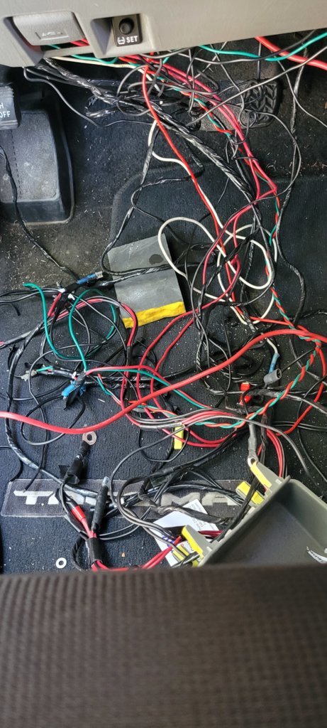

    There's still wiring for the dash lights :annoyed:
    And I need to do the anytime locker too. I can do it, just need to hype myself

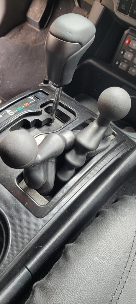

    Drumroll please!!! This is my finished product. I'm very happy with the end result, as it came out better than I expected.
    I wanna thanks TW, amd all those who chimed in on my every question, and annoyance to stuff that I probably missed along this 150-plus page thread. I'm really, really stoked on the outcome, and have no more thoughts o trade-ins. Lol!!! Thanks TW, big times for this one. We are one helluva Taco fam indeed!!! Brothers of the Taco 4-L!!!
    If you're holding out for some reason or other, just do it already. It won't be easy, but it won't be too hard either. It's easier hands on than just reading and looking at pics and watching vids. Just do it!!!

    @fatfurious2, hey man, take pics of the end result. I'm pretty stoked with mine. I even scored me a 2022 shift knob to more closely match the twin-stick knobs. Yet to come will be a boot for the shifter, but my steering cooler and Mitchmade Carrier are both on the way... Just keep moving forward, bro.

    Huge kudos to you! Looks great, the way it should have been done at the factory
    I went back to see when you started (page 20 1/19)! Thats tenacity my friend. A rarely seen quality. I did a nut for nut restoration on my 67 Mustang starting in 89'... raiseed 2 sons... got the final piece done in 03'. Ahh not again.
    Again Nice job!

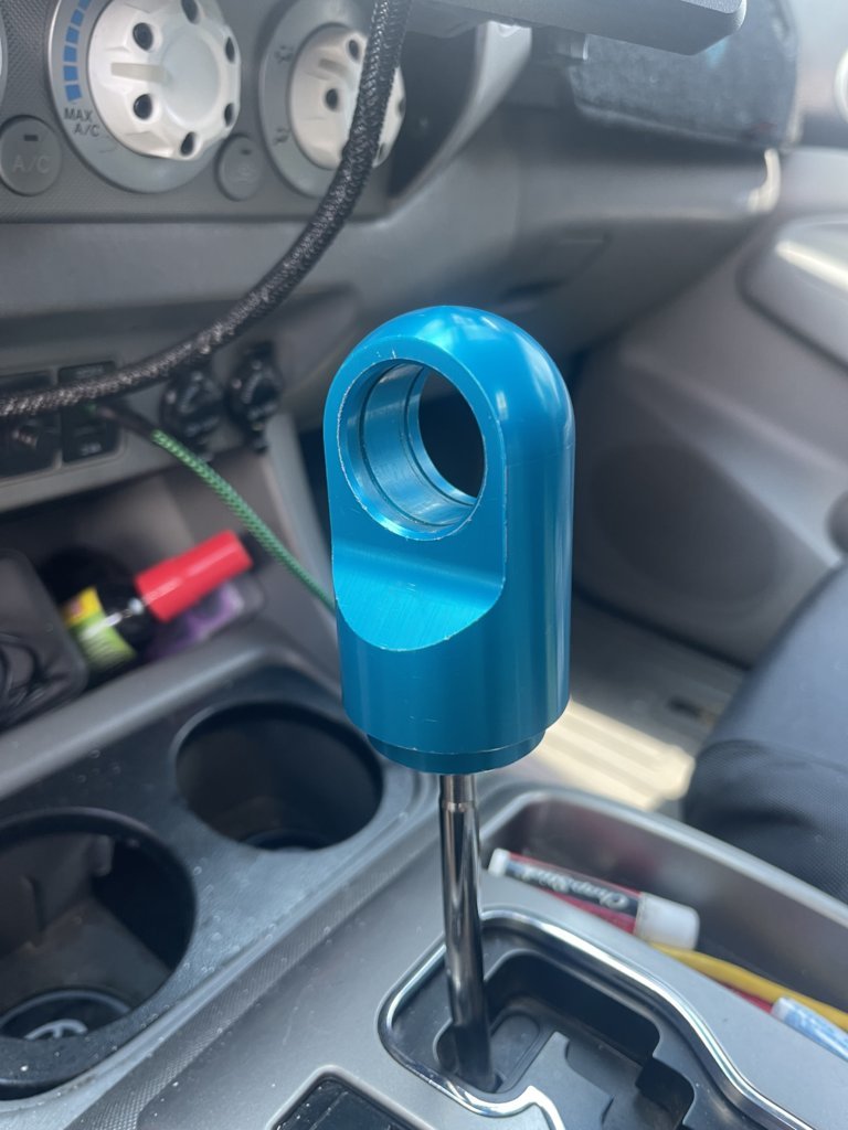

    I have this shift knob and a stock FJ knob. We will see if the king one will fit with the other one

    Thanks. I actually think that's when I started researching, and looking into what this was all about. Read, watched, and did it over and over til I finally found a case.
    Anyway, thanks for your kind words. Now I'm just trying to urge others to pull the trigger. It's only as hard as you make it. I'll send a pic of why it took me so long. What was once under the console I'd all gone now.. (pic below) 20240821_164429.jpg

    Fatfurious; I love the uniqueness you are going with. I'd like to see the King with shaved edges (where it rounds out underneath the eyelet). Hope it it's for ya bro. You got this. Yet be sure you want on stick over two. I figured this as soon as I knew I was getting a case... Good luck bro.

    How do I stop the blinking lights on the dash?

    I think that's the one where you gotta wire up the wires above the glove box area?? (if you haven't already)??

    No haven't done that.
    I just unplugged it and they stopped for now.
    Still gotta wire up 4h and low the sensors .
    I tried plugging them in but they didn't want to plug straight to the Tacoma plugs like someone already mentioned that they already fit but they don't seem to fit.

    @Toyotamudbogs , go to page 30 of this thread... Then go to YouTube and watch 2010 FJ case swap. He shows how to and what to wire at case, and in glove box.
