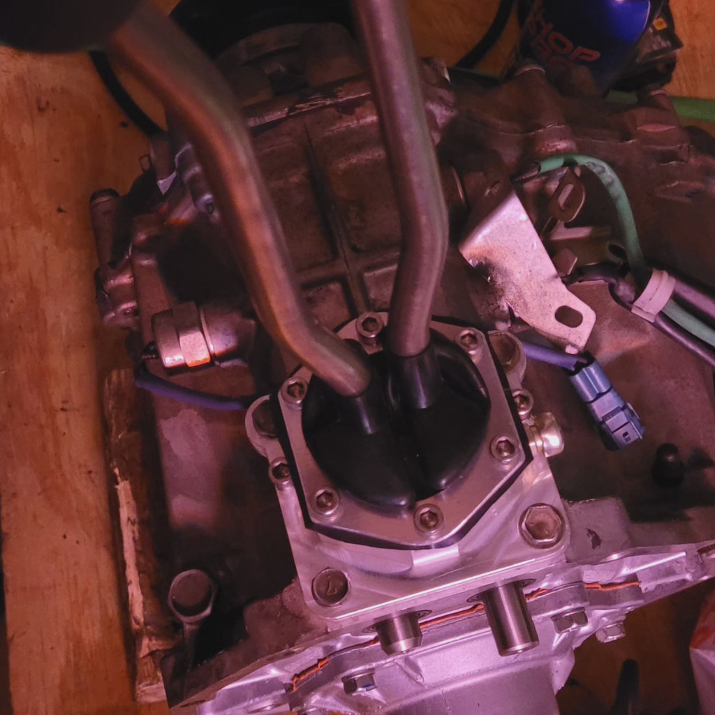

    I did put a type of gasket on the mating surface, but I don't really think it's for this type of fluid?? Still, I'll eventually remove everything again, and reseal. Thanks again. And again. And again. And again. Lol!!

    let it cure over night or for a while before putting fluid in and going driving

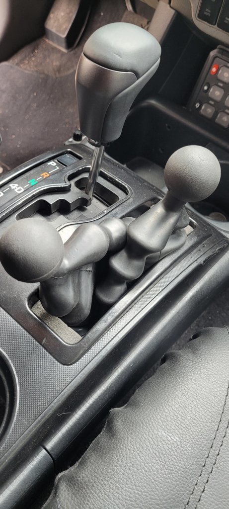

    I was going to go full ADD delete, but decided I didn't want everything turning, nor did I want to get more stuff that I had to wait on, as I had already started. Anyhow, you will have to notch out the trans mount to get the screw out, or back far enough to not have issues with removal. (Heres some twin-stickspiration)IMG_20240825_061651_490.jpg

    @wrmathis; So it happened. I don't let stuff bother me for too long, so I took the rear of the case off, and went to town with a can of permatex. Let it cure, and man did I hit everything. From Twin Stick housing, all the way down. Didn't throw any fluid until the next day. Well, 6 hrs later to be exact. Checked it getting home from work, and so far, all looks to be dry..Thanks for the tips on how to properly set this stuff up. Thanks. I relove this mod again. This truck is becoming a lil beast.
    To anyone else on the verge of doing this mod... Stop waiting, and do it!!!! Do it!!! Do it!!!

    Glad it’s leak free so far. Pretty sure the directions on the different rtv/gasket makers state to let things cure. Some even state let partially cure then tighten down the bolts. Most people don’t read the directions on the tubes at all.

    I read them, but my first attempt was hastened and a bit sloppy. As the cover wasn't lining up and the gasket was smearing and I still had more welding and little time. It was a nightmare for just one person. Overall, it's finally done, again. Lol!!

    Also look for one on YouTube titled "Complete FJ Case Swap". These exact 2 videos were my go to. Because I do have a 1" body lift, my floor cuts were a bit different, given I also did twin stick mod as well. They're not the same vehicles, but again, lots of similarities and one more explaining than the other in different areas. Check it out.
