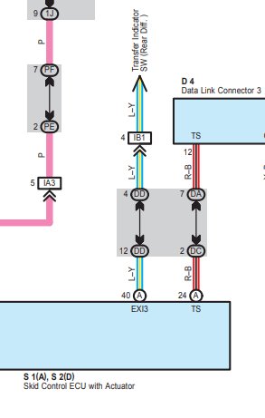

    There would be no point to keep the 4wd ECU if your doing a manual TCase swap unless you would want to do alot of trickery to make it happy and get it to shift the ADD. You would either have to rig up a relay and switch to control it, convert the ADD to cable shift, lock it and leave it locked, or swap in an FJ tube with no ADD.
    As for the ABS, Traction Control, and A-Trac the Skid Control ECU has 3 inputs from the 4wd system, EXI4 (4wd), EXI (Low Range), and EXI3 (Rear Diff Lock). These are pull-down circuits meaning they are grounded in each mode.

    I know just enough about electronics to get myself in trouble, but - is my interpretation correct in that this would be as simple as grounding those circuits to get those respective systems operating as needed..?
