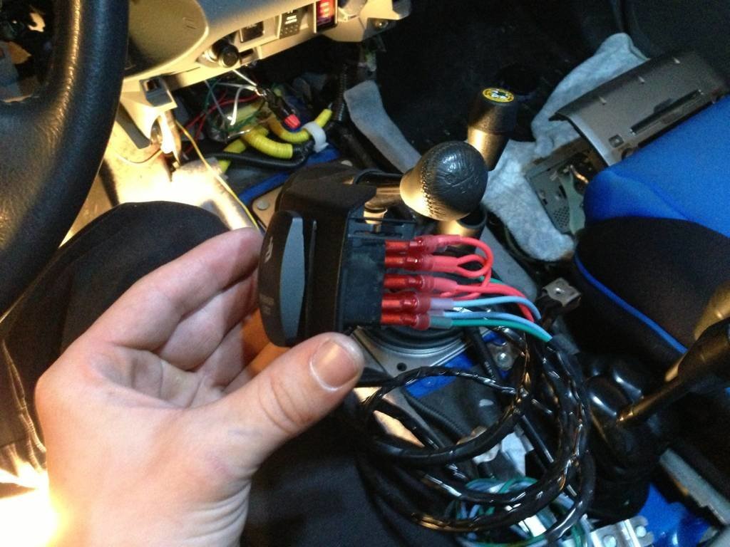

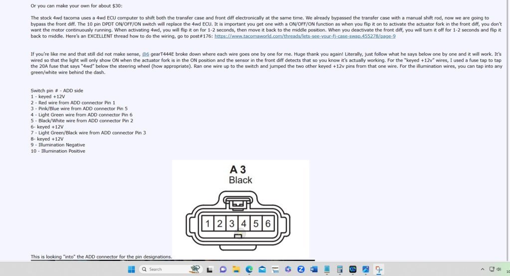

    A DPDT switch to activate the ADD is easy enough to make once you wrap your brain around the instructions in this thread (at least it was for my small brain). I'll repost the schematics below:
    reallifedog, moon22 and Dm93 like this.

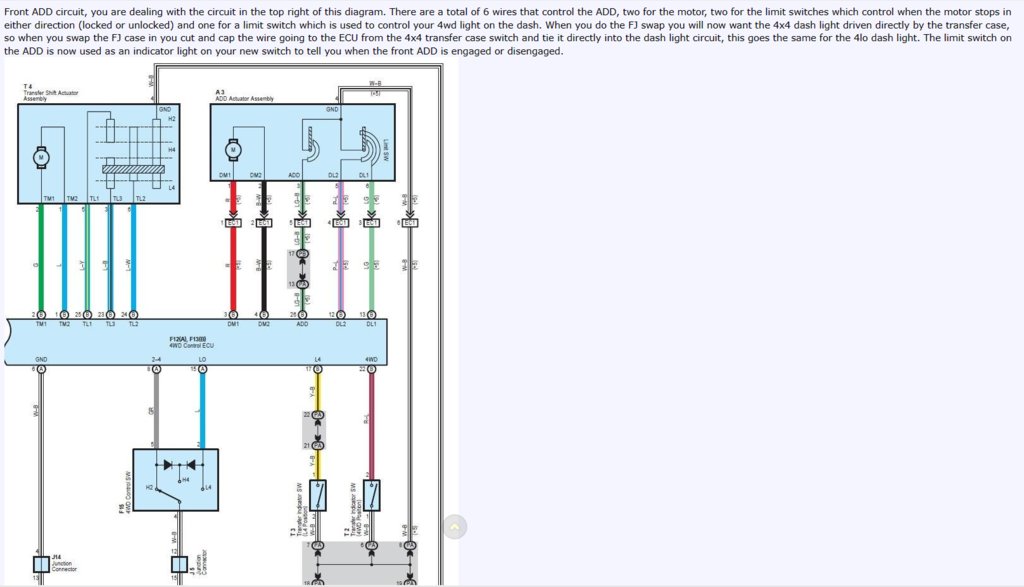

    For the 4wd and Low yes you would connect them to the 4wd and Low switches on the transfer case, you can use the existing wires.
    For the rear diff lock you would either need to use a switch and relay to operate the locker like the Locker Anytime Mod or find a 4WD ECU from a 2wd TRD OR to use and keep the factory locker system.

    Well the 4wd ECU controls the lights so if your removing that then the lights won't work unless you tap into those circuits as well, he was talking about keeping all other functionality though.

    There's more to it than that, your gona pretty much have to remove or at least unplug the 4wd ECU if your doing what I understand.
    I was just saying the wiring is there under the truck for the 4wd and Low sense circuits. The 4wd circuit is Pin 3 (Light Green/Black) at the ADD Actuator and the Low circuit is the Yellow/Black wire at the L4 Detection Switch on the back of the Transfer Case Actuator.
    If you wanted the lights to work you would just have to cut and tap the indicator circuits to the 4wd and L4 circuits at the 4wd ECU.

    Sorry, it's busy at work for me. But i just completed most of this. The relay allows you to operate the locker anytime. You would remove one harness from the 4wd computer.
    when you swap a manual tcase you just wire into the plugs on the tcase for light functions. The actuator isnt functioning anymore. And you will lose front add unless you do the dpds switch or fj tube.

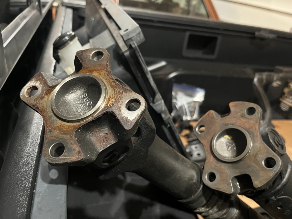

    Good points @BLtheP and I wouldn't have guessed that about the T4R/FCJ shafts. I was actually just wondering if there are any other differences due to them being full time and not part of an "operate under 65MPH" system?
    Does this mean a 3G auto shaft for the rear will work as well if I am doing the math right..?

    Technically it’s only below 62 mph that you can shift, but you can drive any speed in part time. So really there are no functional differences in the driveshafts. Don’t know why they use different different ones, probably just the way Japan prefers to do it vs North America. Not sure. Functionally either will work and bolt up fine if you get the right length.
    as for the rear, the length would be correct, but the centering hub on the 3rd gen MT driveshaft will bottom out in the yoke hole before the yoke is seated. I learned this when I tried to swap an 8.4” TrueTrac diff into my 3rd gen in January. So I’d go for the 2nd gen auto 4x4 rear.

    I don't have my 4wd ecu plugged in, but my 4hi and lo lights work. I suppose i tapped into the rest of the harness for the functionality. I was just following the instructions, i don't know the reasoning behind it

    Well well well...I stumbled in to this: The front/rear yokes LOOK different; but I threw calipers on and got the same 46mm register diameter on both, and my attempts to measure the bolt openings (to extremums) also showed about as identical as I could see through my shaking, shivering hands..my current front shaft is in no need of replacement so that would great to be able to use it.
