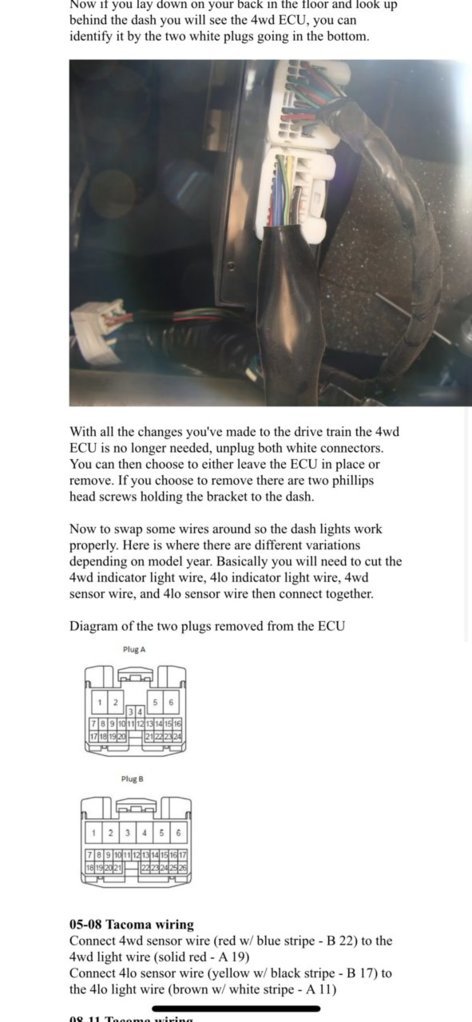

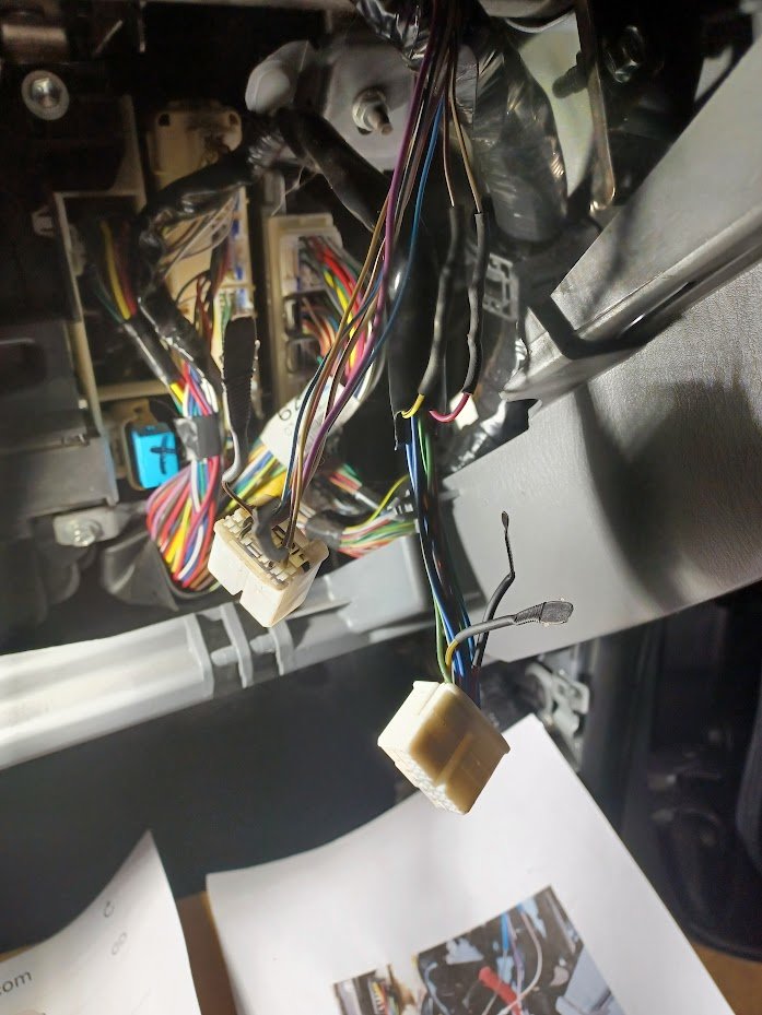

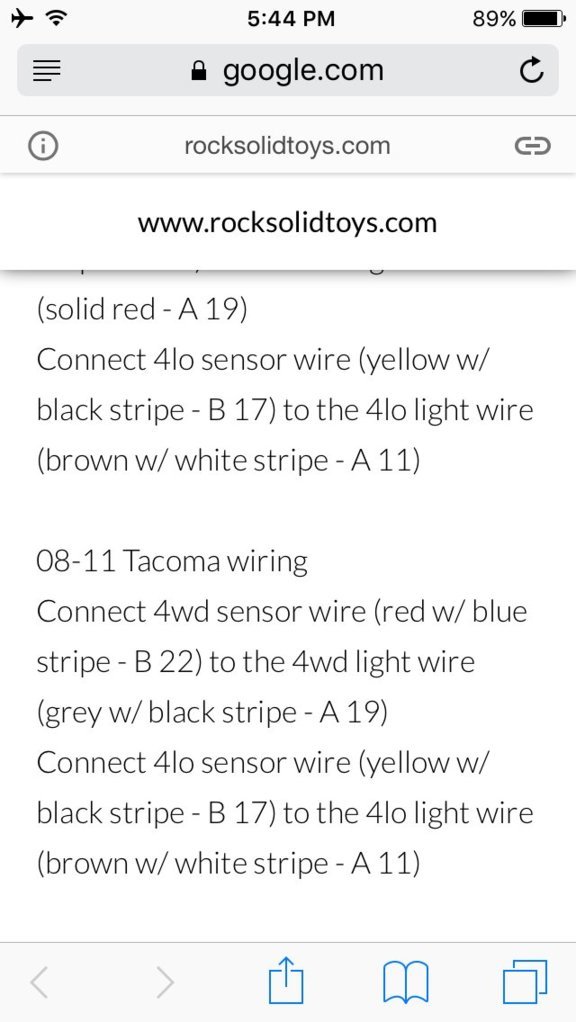

    If you've done the anytime locker mod, as illustrated, you've swapped the sensors from your Tacoma case into the AWD case, the only other wiring thing to do to get the 4Lo light to work is to (I edited the part about the 4x4 light as you will have AWD and likely don't need/want that to be on all the time).
    For the record, the instructions above say there are differences for 05-08 and 08-11 but I found the colors for 08-11 were the same for my 2014.
    I removed my 4x4 ECU (for massive weight savings).

    Is this strictly for the dash light or does this do the right grounding to get ATRAC back in the game as well (or is that done via the TC sensors)?

    Sorry, can't help you with ATRAC. I've just got a lowly SR5 so that was never on my radar.

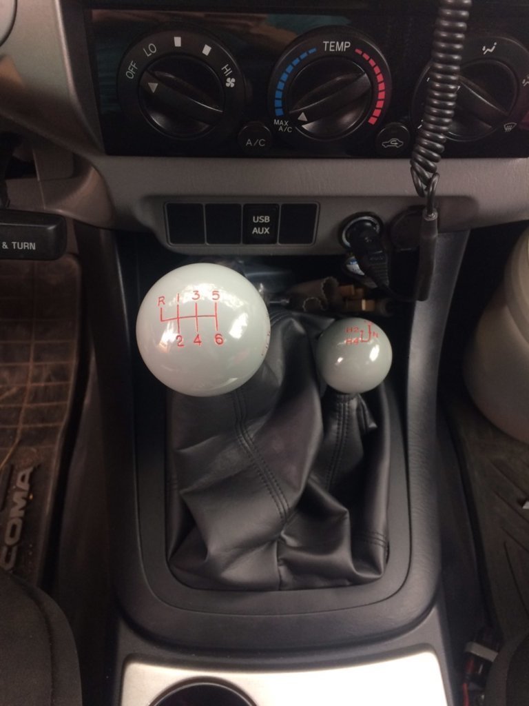

    Maybe I glossed over it though, but I thought BassAckwards' install showed the FJ TC shifter going just up to the right of the stock shifter and he just poked a hole in the 6 speed boot - this might be a AWD FJ shifter thing vs PT4WD?

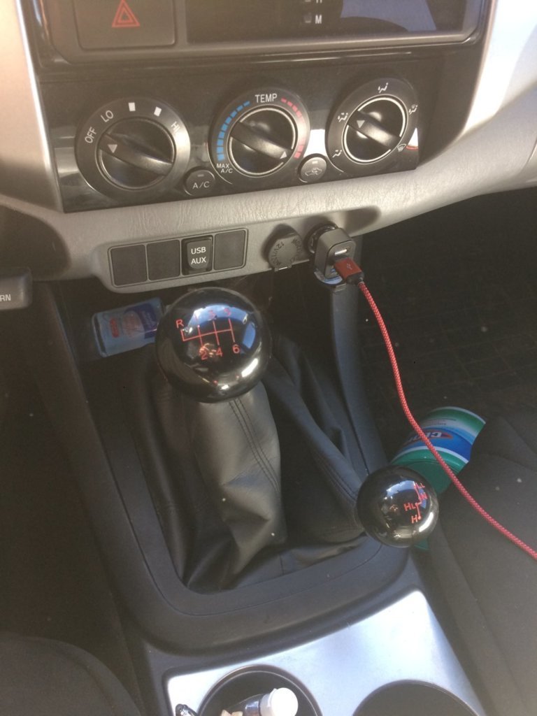

    I’m running the 6spd FJ interior boot but I’ve run both part time 4wd and full time AWD cases with the shifter to the right side without modifications needed to the tcase shifter. I am running the TRD short shifter though
    part time 4wd VF2A
    VF4B

    I forget the details but I want to say there is less clearance on the RC series transmissions.
    I do know for sure the FJ has a leftward hook in the RA61F shifter to make room for the transfer case…I’d have to find pics of it again to share though.
    there is a chance it would work on mine, but I’d probably need a short throw shifter, which I don’t really want.
