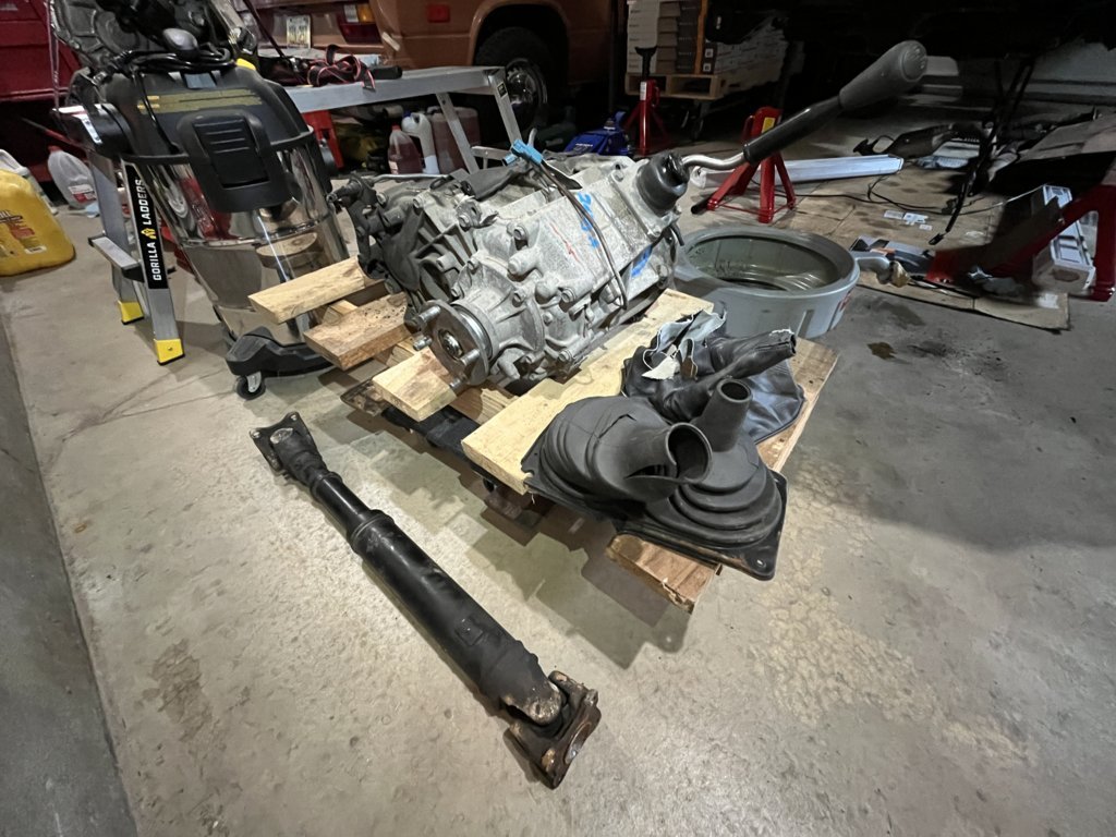

    Case, driveshaft and what's left of the boots landed today. Rear shaft and GX boot over the last few days as well.
    Case seems to shift nicely; what's curious is that in neutral, it seems that the front/rear outputs are linked together like the center diff is locked. Is this normal? EDIT: Yes, it's normal
    Also: lost a stud on one of the output flanges and another is kind of mangled, but I can't seem to find a part number for the studs (just a whole flange). Are these available separately? EDIT: Nope..
    Pallet said 250#; no wonder fright was so friggin' high. My wife and I weigh not much more than that combined so we were preparing to break our backs getting it out of the back of my Forester but even she was like, "should we just carry it in to the garage instead of messing with the dolly?" Hah..what are these things actually tipping in at, 80-90#? Ugh. A few more days at this point and I could have had one for almost half the price..I hope this is the last ride I'm being taken on for this year!

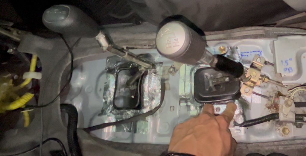

    Still happy with your FJ boot setup? I scaled up your image above to mock up my stock boot with the GX470, and they clash juuuuust enough to make me reconsider; probably a better choice for the automatic guys. Too bad the boot I got is thrashed and they didn't include the steel frame, not seeing any on eBay either..

  12. Jan 2, 2025 at 4:35 PM

    LX470 boot?
    I couldn't get it to work with the space I had. Im auto though. I used this one:
    https://www.amazon.com/dp/B0B2DGW7CR

    I am happy with the FJ boot setup. I used it in both of my trucks with the AWD case and it turned out pretty clean. I would try ordering a new one from a dealer. It will be expensive but the steel frame is how i marked the holes and it makes it look factory. I lined the front one up with the stock holes and then marked the remaining ones off of the FJ boot. It does take a little work to get it to fit. There are some uneven areas on the trans tunnel.

    Yeah..ok, thanks. It looks like I can get one for about $100 with some sniffing around. I can use the rough one for a set-up piece I guess, although it crossed my mind to try and make my own frame; but I'm already behind schedule as it is and that's more of a problem than being over budget at this point.
    Man, used market is rough...I may also wind up with a Redline leather boot as that's cheaper than a used FJ boot, which I'd prefer for the OE look, but those may be as close to disintegrating as my original..

    Im still looking in the used market for boot covers. Came across a GX470 that has an extreme angle. 2H is fine, but 4Lo goes way forward. No generic boot on Amazon does it for me yet. Maybe an ebrake lever boot, but then no ring. At the same time, i don't have factory knobs

    EcoCrawler boot it’s from and FJ cruiser(used to be my j pattern’s) and my current J patter is a Bride generic boot. My truck is quiet and sealed. I’m a happy dude.
    This is how it used to look

    I had that one, but it was catching on the threads that i used for the J shifter. I used a U bolt. I guess i could smooth them over more

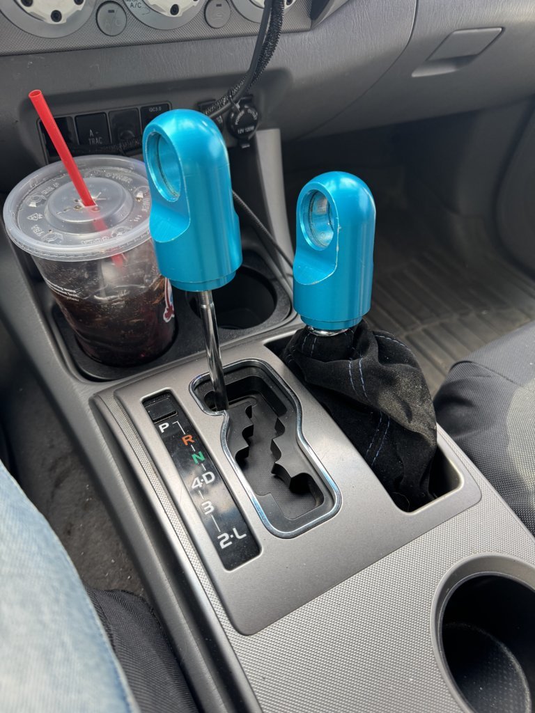

    Current:
    Its like a black suede with blue stitching
