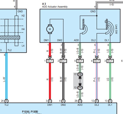

    Question: should the driver side front wheel be activated if front ADD has not been deleted yet?

    open diff will send power to the passenger side axle tube so if the add is disengaged the front drivers side is useless in 4wd. If you have an. ARB you can lock it up to get 3wd

    Ah ok. So i basically went out in 2wd but thought I had 3.
    I really need to not be lazy and get the FJ tube in, or at least do the poor man front add delete, and slide the fork over, until i can get the FJ tube in.
    Is there a way to jump the front actuator without pulling it off? I think Ill need to lookup @Dm93 diagram to figure out what powers the actuator

    Pins 1 and 2 on the add connector side you can supply 12V and ground and manually lock it up. Not sure what pin needs 12v vs ground to lock it up vs unlock but you got a 50/50 shot. If I can find my drawings I will let you know which side to apply the positive to for locking the ADD

    Why crawl under the truck? Grab the wires at the 4wd ECU connector and apply power and ground there.
    Connector F12 Pin 3 (Red) Power F12 Pin 4 (Black/White) Ground to move the ADD Actuator to the locked position, you only need to run it a second or so to move it.
    dk_crew and 6 gearT444E[QUOTED] like this.

    No 4wd ecu anymore with the FJ case

    Isn't the wiring still there though?

    as long as you left the subharness connected by the diff you can apply the voltage under the dash, EC1 connector is by the motor itself so as long as you left the ADD plugged in from EC1 to the ADD itself. Purple wire under the glove box is switched fused 12v positive.

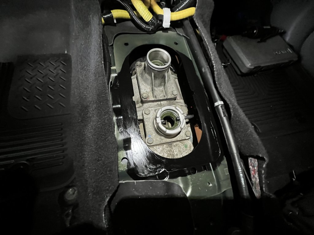

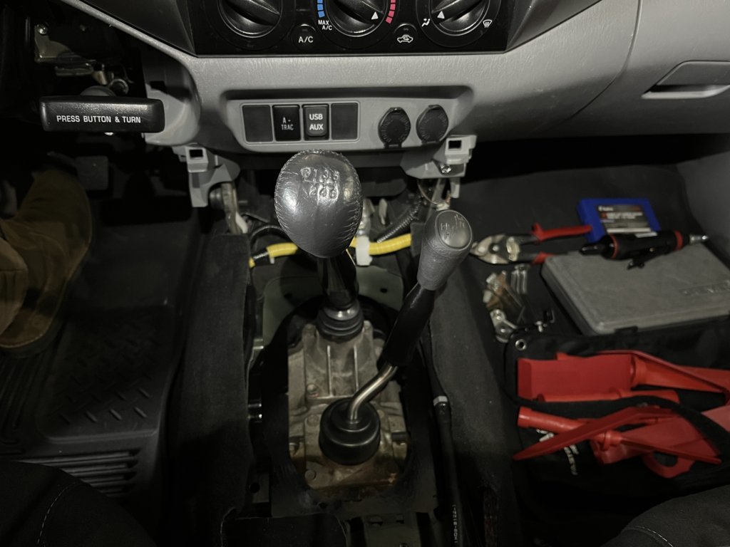

    It's in, and did a "dry run" today after what felt like an eternity (everything live, but no driveshafts). Outputs move when and how they should, no horrible noises or hard shifting. Noteworthy is the rubber shift bushing does not seem to be available for the transfer case like it is the transmission shifter, and mine was completely missing, but I rolled the dice and got a 2nd transmission version which went in just fine after trimming the OD down with some flush cutters (lacking any better way to do it). There is a chamfer on the bottom side; take that completely off (but no more) and it will be the right OD. I thought I took a picture of it after cutting but apparently I did not. P/N for the bushing: (will edit in later, need to look it up, remind me if I don't).
    Not really much to report yet I guess - other than it all went together. Physical fit wise, no complaints other than the shift knobs being pretty close when in 6th and in high range. I anticipate a pinkie collision or two until I retrain my muscle memory. Trimming for the FJ lower boot was a bit more invasive than I hoped but I didn't have to do any relocating or console mods or anything like that with the exception of an E-brake cable guide, which I will probably just move to one of the new boot mount fasteners. I hacked the top side out via dremel and carbide burrs, but the lower side is nice and flat so I spent an afternoon with the boot and my 3D printer and made a nice fitting jig to cut the main opening out with an air nibbler. That turned out fantastic, except where I got to the bottom of the curve and drifted off the guide about 1/8" while distracted with the air hose rubbing on the seat. :frusty:
    From the electrical side of things, I did wire up my 4WD and Low sensors, but I do not have locker or A-TRAC in low range anymore from the looks of it; but a very important asterisk is that I also did a rack replacement (and a ton of other stuff) at the same time, and need to re-zero my steering sensor as the traction control and ABS light is on, so that could very well be preventing A-TRAC from coming on at least. I already bought locker anytime stuff in anticipation of it being out of order.
