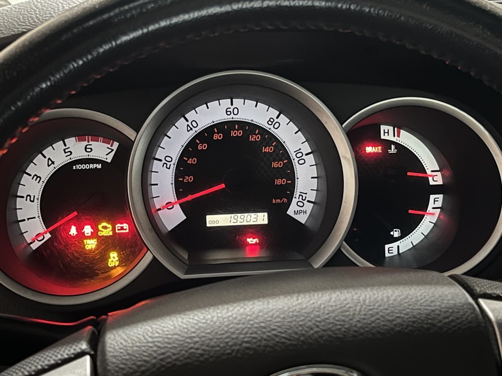

    I'll admit I was apprehensive about this until it honestly did sound like all I needed to do was pop the TC actuator sensors in the FJ case and disconnect the 4WD computer. This one was staying stock; but if all that separated me from AWD was a hole in the floor...I mean the transmission is already out...
    But as I look back I made some assumptions about the full time vs. part time swaps "plugging in" the same, and/or perhaps I found a new combination of truck configuration (OR model with its fancy pants brake booster) and transfer case (full time). I didn't want or intend to go down the wiring and troubleshooting rabbit hole. Buuuut, here we are. :oops:
    I greatly appreciate everyone's help and support with this, and while I am not sure how popular this particular setup would be, I will definitely consolidate all learnings to a single post or thread if it all gets ironed out.

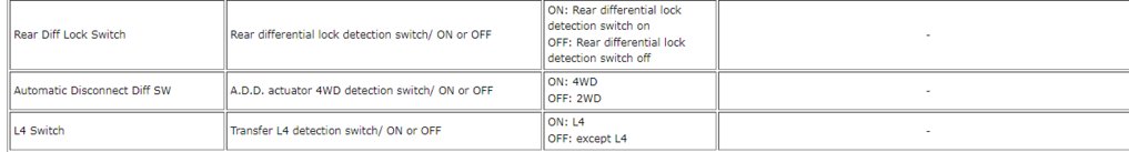

    Ok, may be irrelevant now; but those three items all show "OFF" with the plugs on the TC removed.
    Jumping drivers side turns on L4. Interestingly is that if I key off and then back on in 4L, the VSC and ABS warnings go away and things pretty much look normal (see picture); C1268 persists either way however. Jumping passenger side (4WD) does nothing in TS data list, irregardless of L4 state.
    I did just find the 4WD help thread today with all the charts and schematics which is helpful in trying to help myself. :)
    I do not read voltage on either contact at the 4WD connector (one is a hard 0V which I assume is ground, the other does the erratically fluctuating small mV thing).
    Key off, with the 4WD connector plugged in to the sensor, transfer case in 4H, I do not have continuity at B22 when I check at the ECU plug side of things; which I believe I should? The sensor on the TC should close that circuit, correct? Maybe this is a wiring issue; I was very careful when un-doing the wrap and conduit to allow the connectors to reach the sensors, but I suppose it's possible I damaged something without noticing since it wasn't a super friendly space to work in (was doing this with the TC in place).

    I had a little time to tinker on mine when I got home from work, I can confirm unplugging the 4wd ECU sets and ABS light with C1268.
    I did check voltage on the L4 circuit and it was 5v, data in the ABS module showed L4 was off but I forgot to check the ECM data.
    I can confirm supplying 12v to the L4 circuit clears the light after a key cycle, depending on if you want to use the switches on the transfer case and indicators or not I think we can make it work either way.

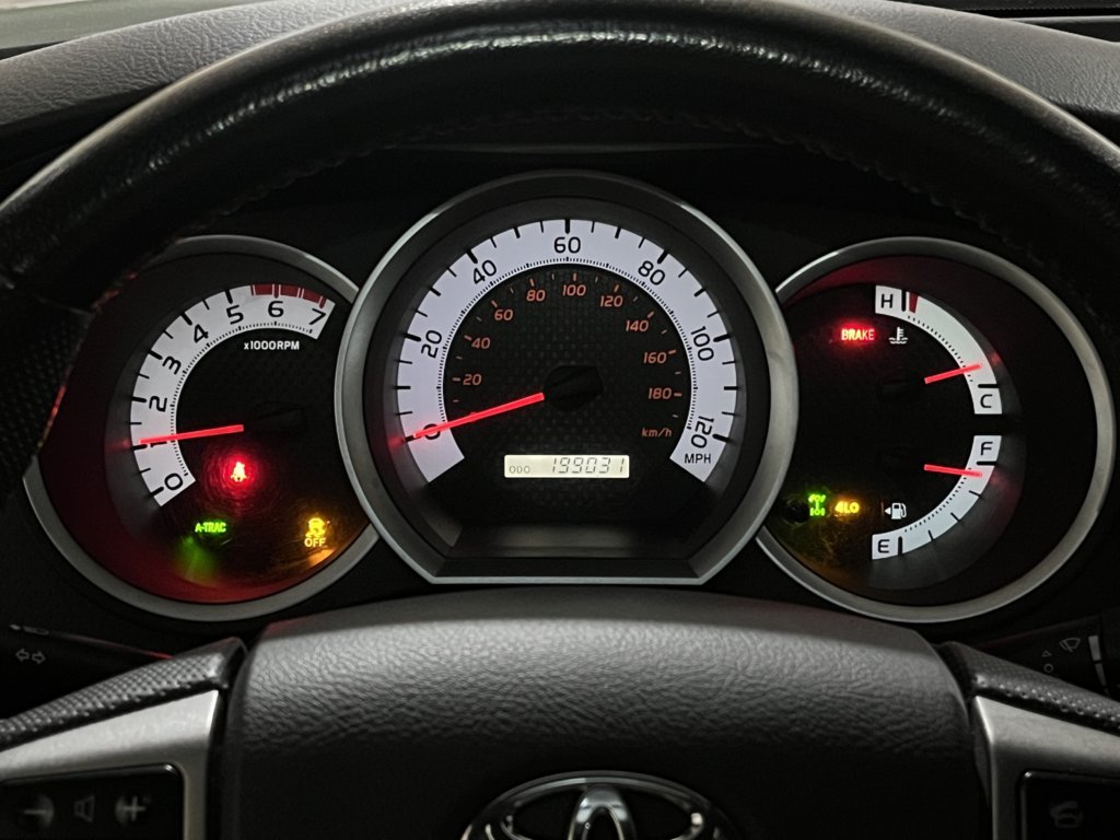

    Verified jumping IND3 to L4 gets rid of the ABS light and then if you ground L4 you get the L4 indicator light and the ABS module sees the L4 input.
    moon22 likes this.

    It worked!! :bananadance:
    I did IND1 to 4WD as well, assuming I would try to go without it as I wasn't super excited to have the 4WD light on all the time - but, it actually goes out when the TC is in 4H/Unlocked, so the indicator lights function just as if it were a conventional part time case. Quite happy about this as well.
    Unfortunately the casualty of all of this seems to be A-TRAC; this didn't activate when I hit the button in low range. If you have any tiny bit of interest in trying to get this system back online, I'd certainly love it; but I totally owe you already and understand if you're over this mess already...
