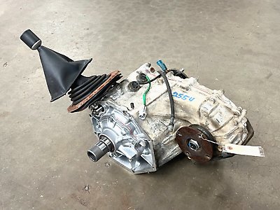

  17. Feb 8, 2025 at 7:11 AM
    #3237
    easleycrawler
    easleycrawler Well-Known Member
    Aug 25, 2016
    #195473
    4,668
    Travis
    Easley, South Carolina
    2014 RC Taco 4wd
    This is the case I'm picking up Monday.
    BassAckwards likes this.
  18. Feb 8, 2025 at 7:20 AM
    #3238
    BassAckwards
    BassAckwards Well-Known Member
    May 3, 2016
    #186002
    27,953
    2009 Tacoma AWD Turbo 2TR-FE
    Full-time AWD & BorgWarner EFR 6258
    You shouldnt have to swap anything but t-cases and sensors off your old case actuator. That will bolt up
    easleycrawler[QUOTED] likes this.
