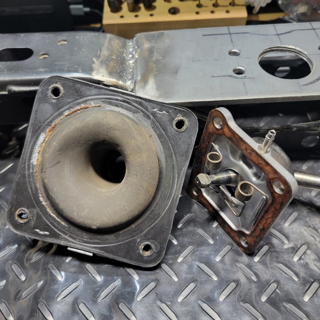

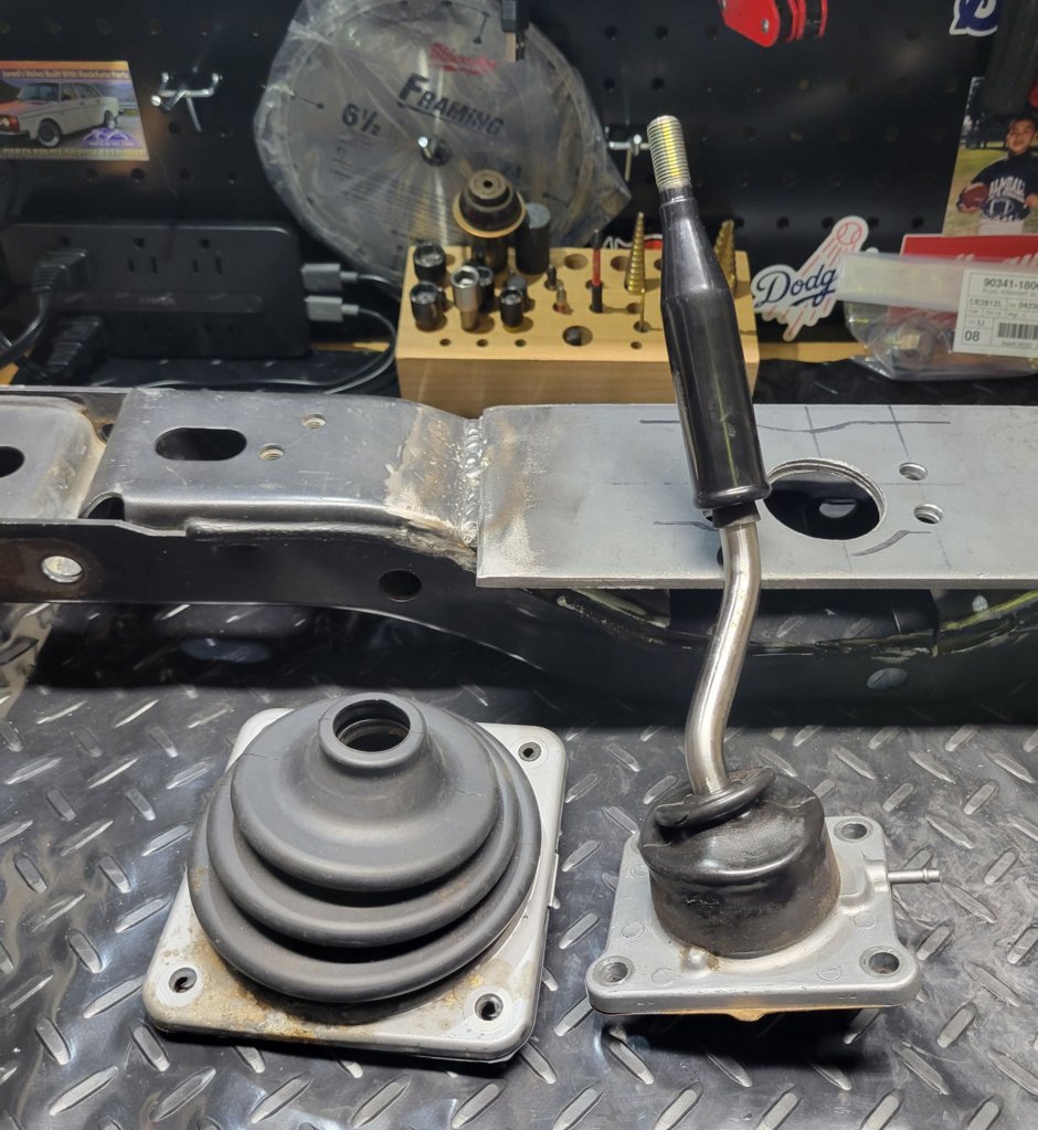

    Anyone have a stock fj case shifter assembly they want to get rid of?
    Mine didn’t come with a shifter and want to keep it normal shift style not twin stick
    ellocodetroit and fatfurious2 like this.

    Bilstein 6112/5160, Icon RXT Stage 3, Cooper ST Maxx, MF-1050 OBA. 348,000 Miles. Coupe battery tie down, Homertaco Grille, Weathertech Floorliners, Front shocks @1.94", ARE camper shell, TRD skid plate.
    I have the shifter, but no shift knob. You will also need the shifter metal gasket too that holds back the spring. I'm not sure if the spring is installed correctly, but someone might chime in. I also have the Lexus LX470 boot cover I was going to use to seal the hole in the cab before I decided on twin sticks. Shoot me a fair price for both if you're interested. I have the generic round shift knob from the Front Range twin sticks I'll throw in.
    Still working on my conversion. Working on the crossmember today.
    tacomgee[QUOTED] likes this.

    Where is this metal gasket you mentioned?
    Also i have no idea what they go for so just let me know what you are asking. It looks like thats what im looking for. Thanks!

    If you cut the shifter, which you will have to unless you cut your interior more, the bed bolts are the same thread pitch as the stock FJC/4runner knobs. M12x1.25
    Can you make your own knob?
    tacomgee[QUOTED] and tacoma16 like this.

    Yeah i can figure out a knob. Should be ok there. And im hoping to keep the interior clean so planning to gut the shifter.
    Didn’t realize how difficult it would be to find one. Was considering getting a front range twin sticks setup just due to how hard it was to find stock setup.
    Hopefully they have them ready to go and get them out in a timely manner :fingerscrossed:
