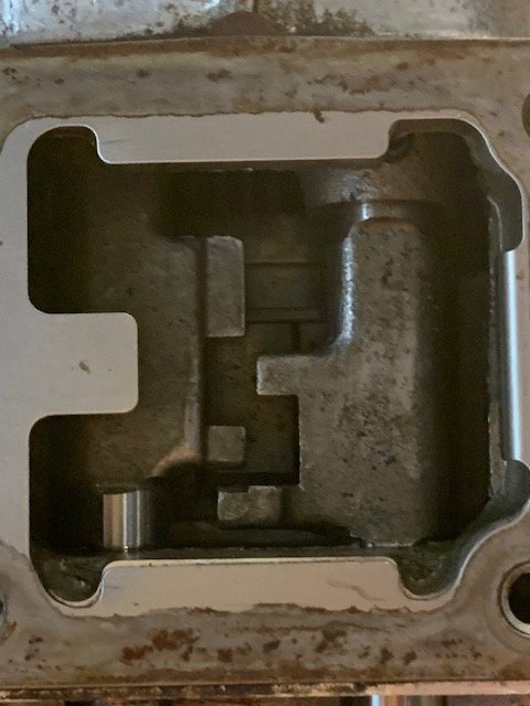

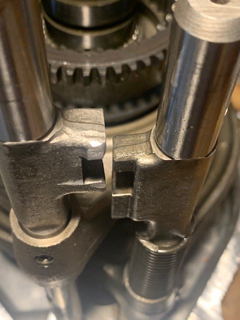

    A few years back I FJ cased my 2nd gen (2006 6 Speed) but left the set up with the stock style J-shifter. One of the best mods ever!
    That process had me pull the front of the case off leaving the gear set all attached to the rear of the case. (to swap out the Taco's Planetary gear parts)
    New project is a 3UZ engine swap... With that i'm changing transmissions to the R151F transmission (5 Speed), and this time, I am going to do a Twin Stick mod, and it is on a slightly different Tcase, this one is the VF2 top-shift. I am going to use the FrontRange Off road Twin-Sticks. Their instructions have the back of the case come off, to get the Pill out. further it says "carefully remove the shift rail".... but I can barely get a thin punch on a side of the roll pin.
    Has anyone been successful with removing the roll pin, so as to slide the shift rail out?
    Even if I were able to get it punched out, how would I be able to get the pin back into the hole for re-assembly? I'm not keen on the idea of stuffing soaked rags behind and it as is now and trying to grind off the lil foot nub.
    I think the best bet may be to put it back together now, and then pull the front snout and 4x flange off, and then re-split it but this time leaving the guts on the back side of the case (like a few years ago's experience went) and the shift rails should be then out in the open...
    Thoughts?, thanks-

    The “fast” way to do it can cause major issues if you foul it up. The tried and true, albeit longer way is to remove position sensors, remove front flange, remove drivers side spring and ball detent, and pull the case apart and leave guts of the case in the back half. Pull the whole hi/lo shift rail out and then knock the shift fork roll pin out with the rail outside of the case.
    just don’t lose the shift synchro keys when you pull the case apart! And note their orientation they won’t go back in one way, otherwise you won’t be shifting very smooth!

    Thank you Jeff!
    I had a bad feeling thinking about trying to get a cut off wheel in the shift hole...
    I will re-assemble tonight and take the front half off.
    I'm doing my best not to move the gear sets in any way... last thing I want to do is have any/the synchro's fall out.

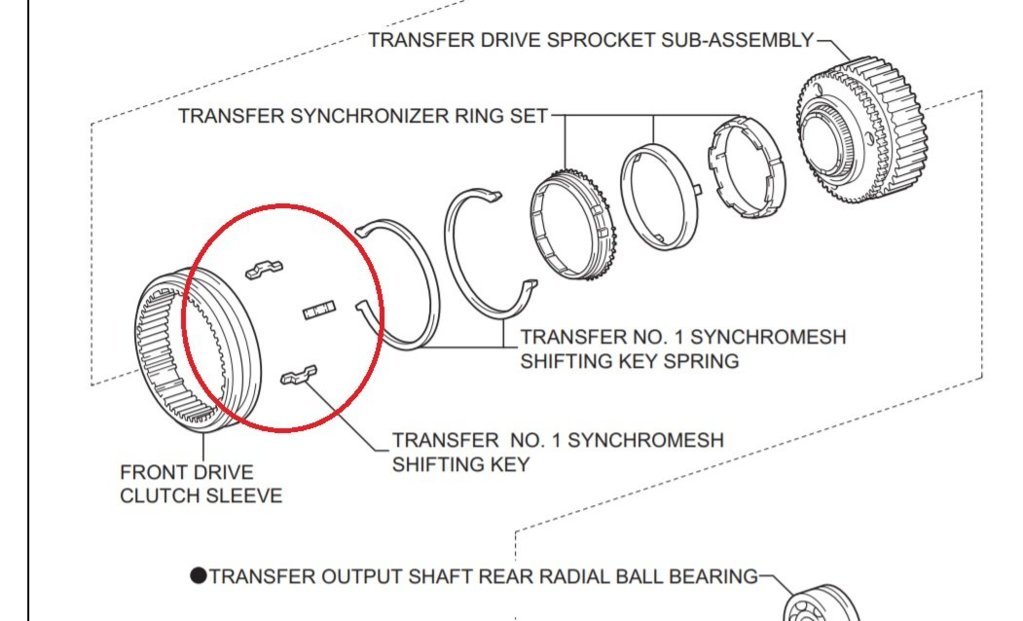

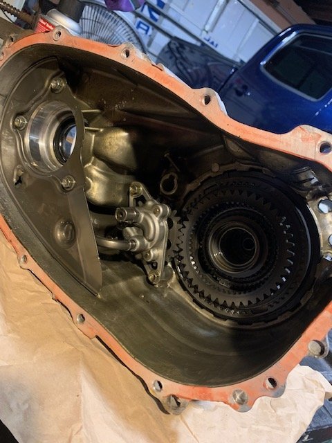

    Tonight went overall well: Had to review some images from March of 2022 on my first ever case split.... that was helpful...
    So question is (for hopefully knowledge ONLY)- where are the 3 magic Synchros currently sitting; in the back Guts, or in the Front cases's gear set?
    I've yet to see them, and i've been looking in and around before all moves.
    Shift rail extraction from there was a breeze

    they lurk inside the front clutch sleeve

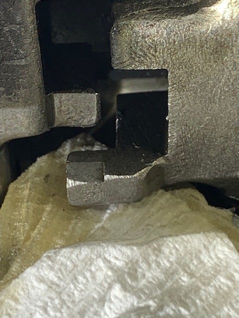

    Another good night here:
    So if i've learned (?), as long as the (right side, passenger side) shift rail is not moved from starting position, all things "should be okay"...
    I think that keeping the detent ball/spring in place (on each side of the rear case) is *super helpful* to keep the rails in place, thus avoiding the synchro drop issue.
    Nub is removed as best as I can tell it is supposed to be (?)... and back home.
