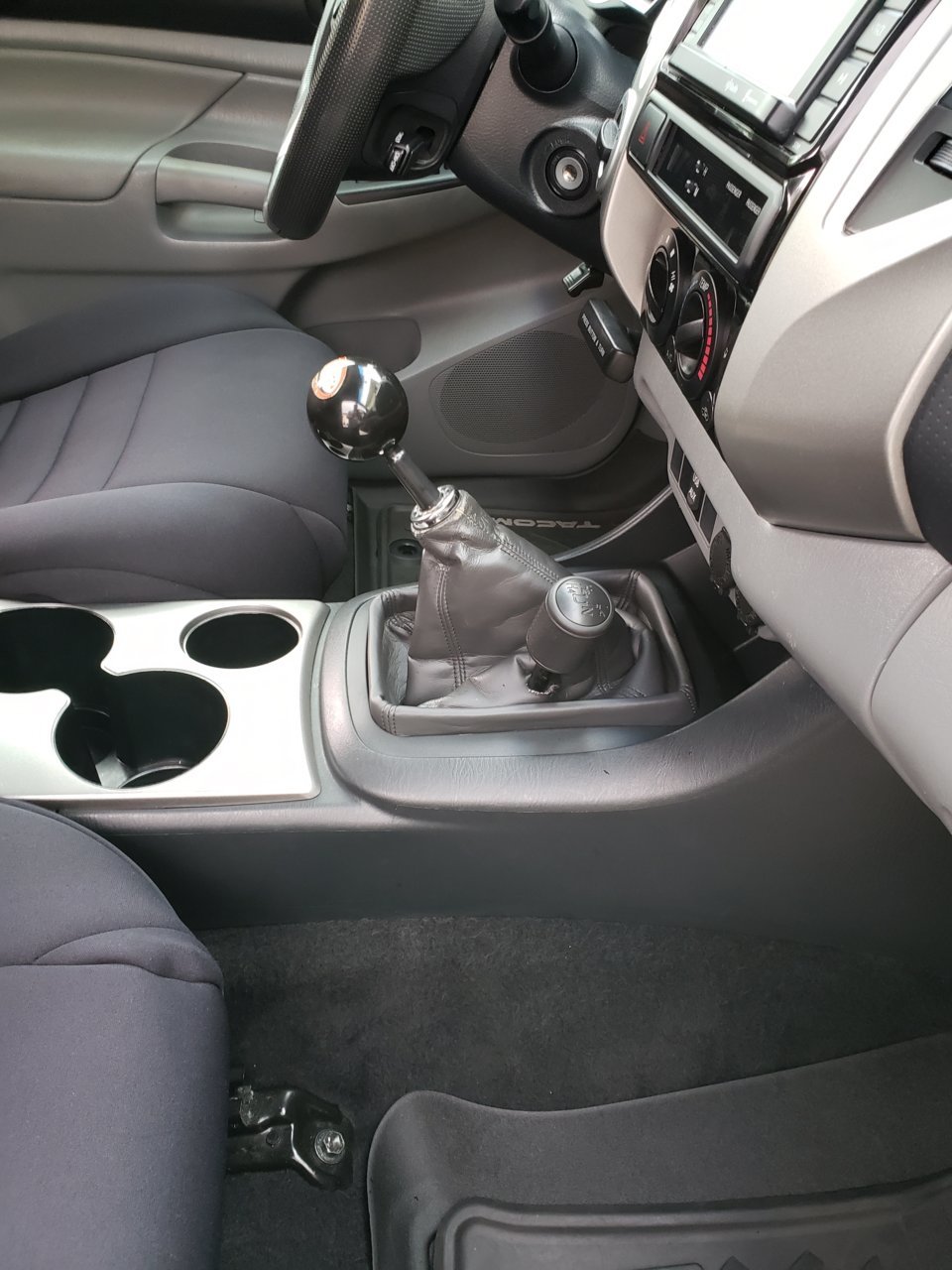

    I'm trying to decide between the oem shifter and the twin. When I got my case it came with the factory shifter, which I wasn't expecting. I just assumed it would have none since the ad didn't mention it. So I'm looking for info on the shifter location for a 5 speed truck.
    @Jcapen When you did this install did you have to modify the shifter in any way or did it come up in the perfect spot naturally? Also what's the boot situation?
    I know a few of you guys out there have installed the twin stick shifter with a manual trans. Could I ask to see some pics of how the twin shifter needs to be modified for that to work. I'd like to keep my cup holders and let the t-case shifters come up in the trans shifter opening. @HomerTaco you have this set up, with a crawl box too I believe. Do you have any pics of how you ran the shifters?

    There’s a bunch of pics somewhere in my build thread in how the linkage is setup.
    The only reason I’m able to have the FJ case shifters come up through the stock shift boot location is because of the triple stick setup for the crawlbox. It allows for linkage for 4wd and high-low sticks to run parallel to the crawlbox shifter.
    There’s no simple way to do it. I planned it out for years & gathered up all the parts. It still took several months to complete and get to what it looks like today.
    I’m not sure what to tell you as far as what you’d have to do for just the twin stick to relo them on a 5speed manual. Unfortunately we have two very different setups.

    The best way to do it is to just install it then bend/cut/weld the sticks to fit where you want them to come up in the tunnel. Get creative, run them where you want the stick to be. It's alot of trial and error, think it took me half a day to finally get the placement nailed down.
