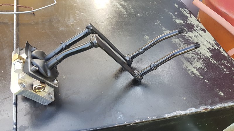

    As you can see, the 2WD/4WD shifter has much less throw than the 4HI/4LO shifter.

    Davez Off Road. I don't like these, but I'm having trouble finding what I want. I'll probly have some made eventually.

    Yeah, I was hoping wherever you got those might have more of a selection.

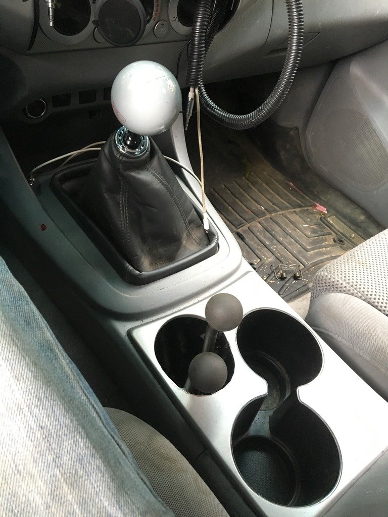

  15. Dec 15, 2016 at 1:33 PM
    #35
    TACO828
    TACO828 [OP] Well-Known Member
    May 28, 2015
    #156212
    171
    Shawn
    2005 Tacoma 4 door One-Ton SAS
    3-link front with Dana 60 and 14 bolt rear. Custom made steel plate front and rear bumpers. 39.5 IROKS on 16" wheels.

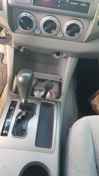

    Just needa trim the cup holder and the shift boot.
    hoverlover, 05Taco4x4, MotoEd and 3 others like this.

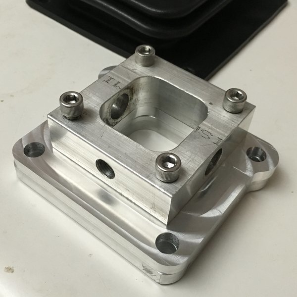

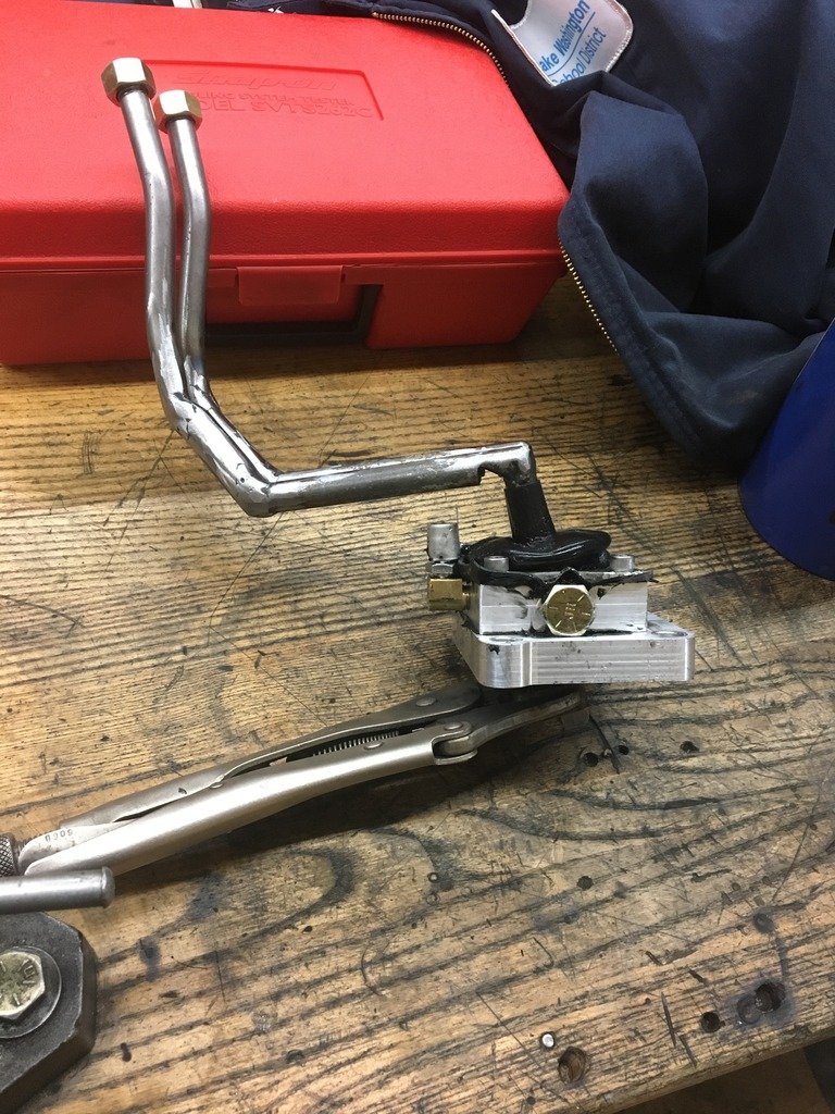

  18. Feb 6, 2017 at 12:28 AM
    #38
    bullaculla
    bullaculla IKA fabrications
    Oct 14, 2012
    #89002
    8,155
    Da big big island!
    2013 MGM DCSB Tacoma 4X4 TRD Off Road
    All pro 3 link SAS kit, Diamond axle, kings on 37" MTR/K

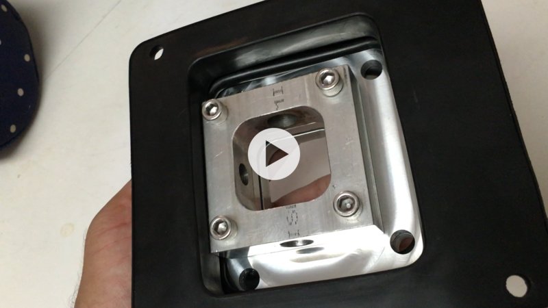

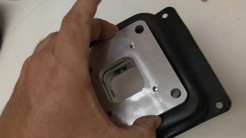

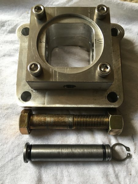

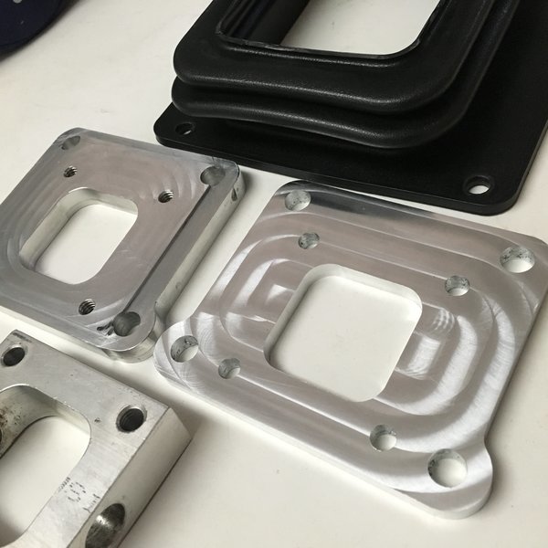

    I'm working on mine. I'll post some pics of my plan to seal the hole in the floor soon. Got some in my build somewhere, but gotta dig...
    :edit:
    I guess I don't have pics of what I made... so I'll just post a few here.
    First thing I did was get rid of the nut and bolt because I thought they were too sloppy, and didn't like the idea of trying to seal them up with silicone, plus I was bored... so I made a precision rod with a small head, and two o-ring seals, held in place with a C clip.
    Shifts smoother and feels more precise, plus easier to take apart and put together.
    Then I machined down the twin sticks block, and made a new clamp with a step in it. When it's all assembled, it will squeeze on the rubber boot and seal. I still need to make a plate to clamp the bigger side of the boot to the cab, or maybe I'll get lazy and just seal it up with some mastic :rofl:
    Not a video, just a screen shot...
    Still got a long way to go, but I need to finish the SAS first, so I haven't worked on the twin sticks in awhile. I'll post more when I make some progress.
