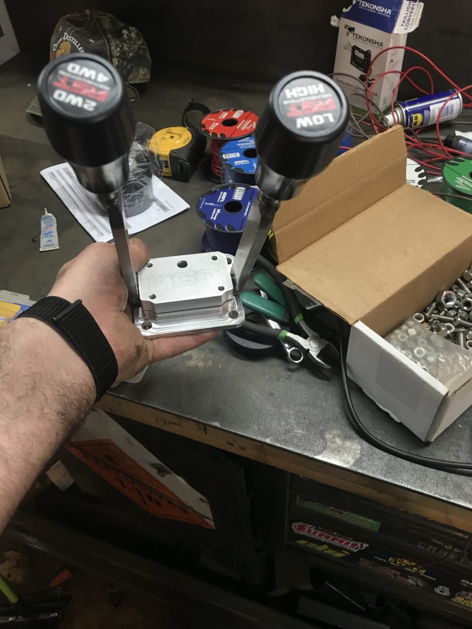

    Some Stuff
    EDIT:
    Never mind. I don’t have low range. Apparently, only H and N. If I put the old sticks back on, I have all three positions. I guess it’s a problem with the new sticks. Pretty disappointing after waiting 2.5 months to get these...
    Have any of you guys used the new RST twin sticks yet?
    I’m just starting to install mine. I don’t have a neutral position in the L/H side.
    I’m wondering if these sticks eliminate the N position, or if I’ve screwed something up. I know Wyatt mentioned “short throw”. Maybe that’s it. I don’t know.

    One of the DFW guys had the same issue with that shifter from RST, let me see if I can find the posts

    Maybe something just needs a bit more clearance? Something not letting the shifter move that last little bit into low position?

    I’m going to go pull it off and try to see what’s up now.

    Likely something is binding and preventing the linkage from going all the way forward

    It’s certainly a clearance issue. I believe it’s the shape of the pieces that mate with the T-case shifter slots. If I put the Case in low, then set the sticks in place, the holes in the shifter base and case are off. The base is about a 1/4” rearward of where it needs to be to bolt in.
    New on the top of pic, old on bottom.
    You can see marks from be trying to shift it.

    Time to bust out the dremel

    Fuck that. These were $300. Wyatt can fix it.

    Yeah, I'd feel the same way, just a pain in the ass that you will go several more days/weeks/months without your truck being trail ready

    You sure is in right slot of T-case?
